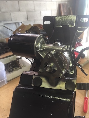

Te27 booster arrived!
Whats the story abut cleaning/fixing these up? will the guts go flying everywhere if I open up the booster to clean it up?
The booster internals look moderately complex. I've got a NOS rebuild kit for mine and there are quite a few bits in it.
I've also got a 1974 brake manual that shows a rebuild procedure. I can send you that if you like.
Panhard mount is the one on the left halfway between the damper mount and the trailing arm bracket.
And yes, you mount a tower of sorts on the other side of the car. It comes down from the floor. There is some geometry involved in ensuring you have it in the right place, so you might want to spend a bit of time researching that. I vaguely recall that you could buy panhard chassis mounts for some other modified Toyota. I think it was a longer one for an AE86
Hi there i think mine is like yours exactly. I had opened mine and its not that complicated. Here are some photos of inside it.

That's a good NOS score! - what do you reckon about NovaLuke's booster in the pics above? same one?
I'd love a copy of the manual mate! don't suppose it includes re-assembling a te27 pedal box also??
Mines off to get sandblasted and painted so I can reassemble it.
I'll do some more digging about the pan hard, shouldn't be a major by the looks of it then.
Good stuff! Those are some gnarly looking hard working hands :)
Looks like a LHD booster with that heat shield? did you need to replace much inside? some rubber seals?
Lol those are my neighbors hands!! I just opened it so i can remove the rust pitting from the out side and spray it and fit it. Inside as you can see was all good. Yes this was a lhd came out from a te27 in U.S.A and fitted it on the car which came out pretty good. Normally the master cylinder piston washers or the bore will be the normal issue of them.
