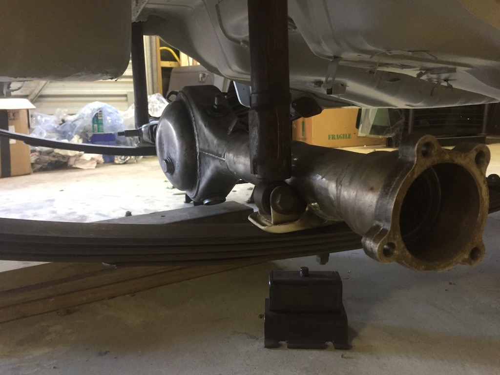

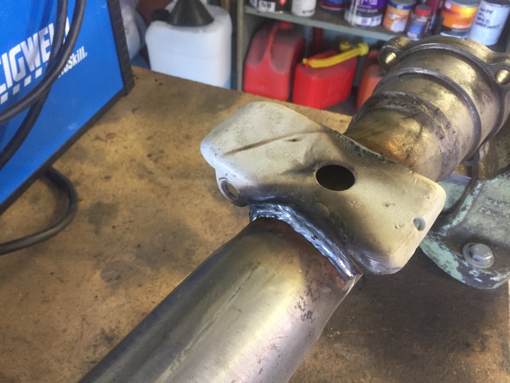

And the main event........leaf spring perches onto the AE86 diff housing
IMG_4342.JPG.1aa6339d297b4696163d7492d9d2328d.JPGIMG_4343.JPG.dfd436e5bb84e13548f71e34f000f47d.JPG
And after a quick mock up and to check alignment......it is the goods! (will need to get bigger U-bolts for the larger diff housing)

MMMM......professional quality welding
