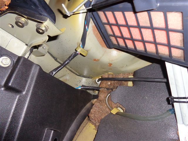

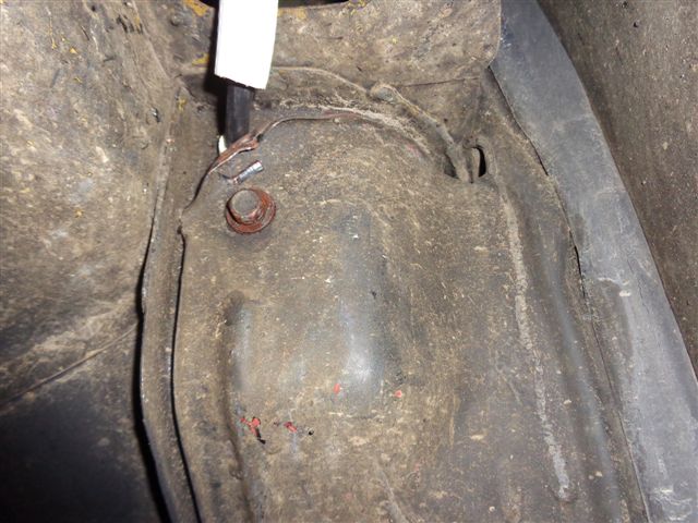

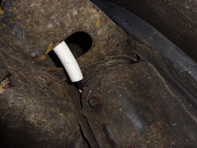

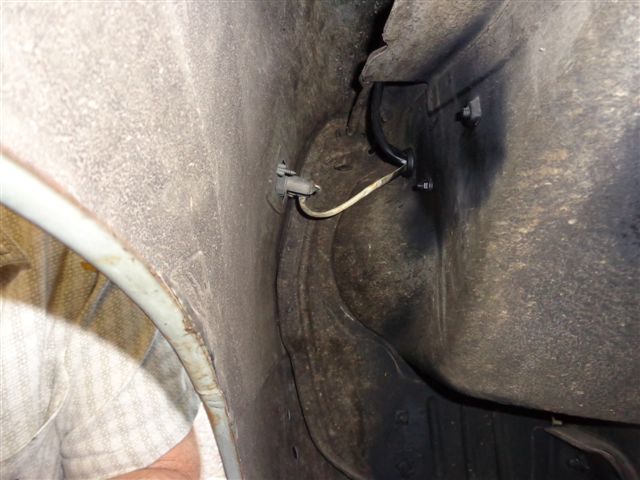

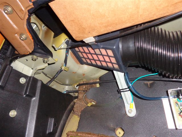

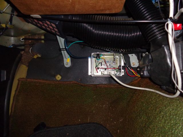

November 1, 201412 yr comment_690163 Yes ! Can be done. I rewired my KE30 earlier this year. Photos are on passengers side only. The other side was identical. Cheers Banjo Report
