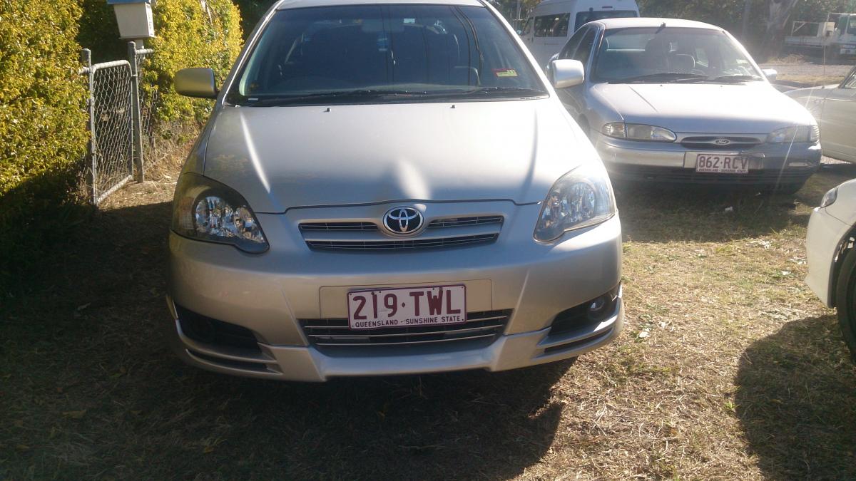

So Pics of the car the day I picked it up:
Above pic shows the COOL side reflector things car has.
Front of car. Can see drivers side fog light missing.
