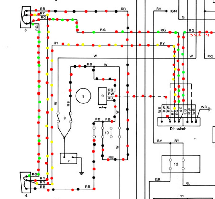

my crown has shitty headlights but already runs a headlight relay. i'm guessing that this type of kit would be useless to me.
Depends on where the relay is Greenmac. For some strange reason Toyota put a relay in the switch line of the KE70 so the switch doesn't have to carry much current, but then they earth the fabulous relay line through the light switch, which stops the current flow!
Just check and see how the Crown is wired.
