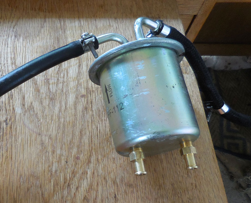

October 23, 201511 yr comment_700909 The N14SSS has an SR20 fed by 8mm OD line, and the same for the return. The KE70 runs 5mm. I think the Pulsar has an in-tank pressure pump, the line goes straight into the filter at the motor end and there's no sign of a pump back at the tank. I'm doing the 4AGE/KE70 now & I plan to use the KE70 lines. I'll try using the VL lift pump to fill a surge tank at the front and feed the VL pressure pump from that. The surge tank is a random (Subaru) fuel filter I picked up with the filter media removed and a couple of outlets added. I'm waiting on the welder to weld the can back to the lid. It holds over 200ml. If I'd been clever enough to search for an in-tank pump in the 1000 cars at the wreckers I'd have used that. Never thought of it. Report
