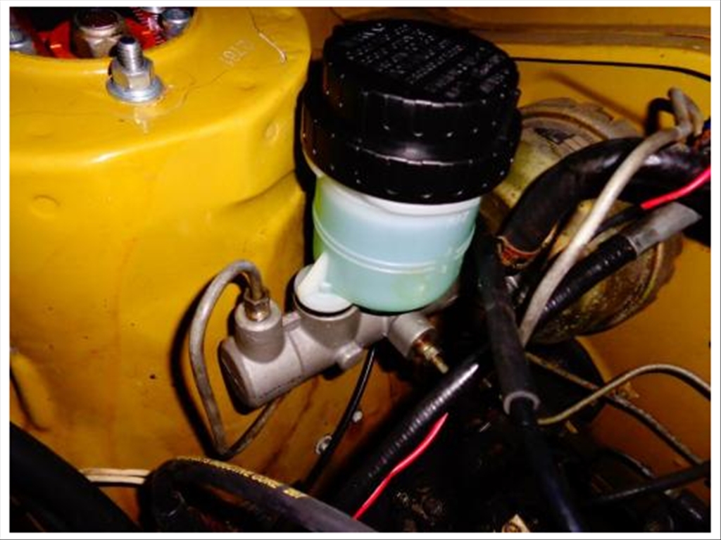

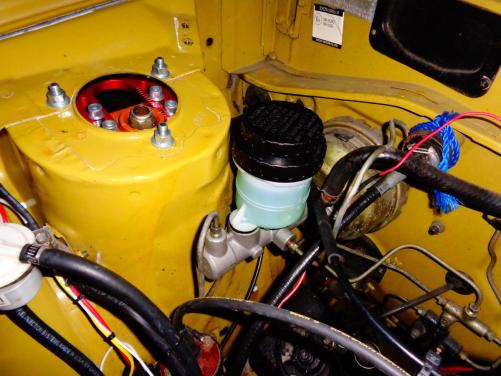

Hey fellas, i'm currently doing an SR conversion in my Ke55 and my brake master is having issues with clearance of the manifold. Are there any masters with different inlet positions ie on the bottom that would still bolt onto my standard booster?? Cheers
S13 and mounts are from Jordan
Jordan does a hydro pedal box conversion on exchange of your own unit, hit him up
Jordan does a hydro clutch conversion. The brakes stay the same. I just need to figure out which master to use
the commodore master i use is identical externally to the standard ke55 one and mounts to the ke55 brake booster. it is internally 15/16. when i had a standard intake on mine it was tight on that side but fitted fine with more than 10mm clearance.
talk to jordan, the kit may be made to work with the ke30 brake master and booster which is a much smaller setup.
Edited by oh what a nissan feeling!
How did you set up your brake lines then? The side brake line is very close unless I use a banjo bolt or something like that. Also I'll have to remove the proportioning valve switch as that hits and also the bleed nipple hits so I'll have to chop the top off
It sounds like your engine is positioned slightly different to mine. I don't have the brake light switch connected, but the rest is normal. Your best bet would be to use the master and booster off an early ke30 i guess, it will give the clearance you need. As an upgrade that will bolt to that booster a pajero master cylinder is often used.
Hey do you know what model (year) pajero
Ok sweet, I have a wilwood compact but it's not going to fit, so going to source a paj one
