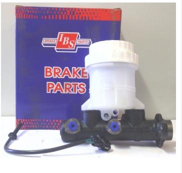

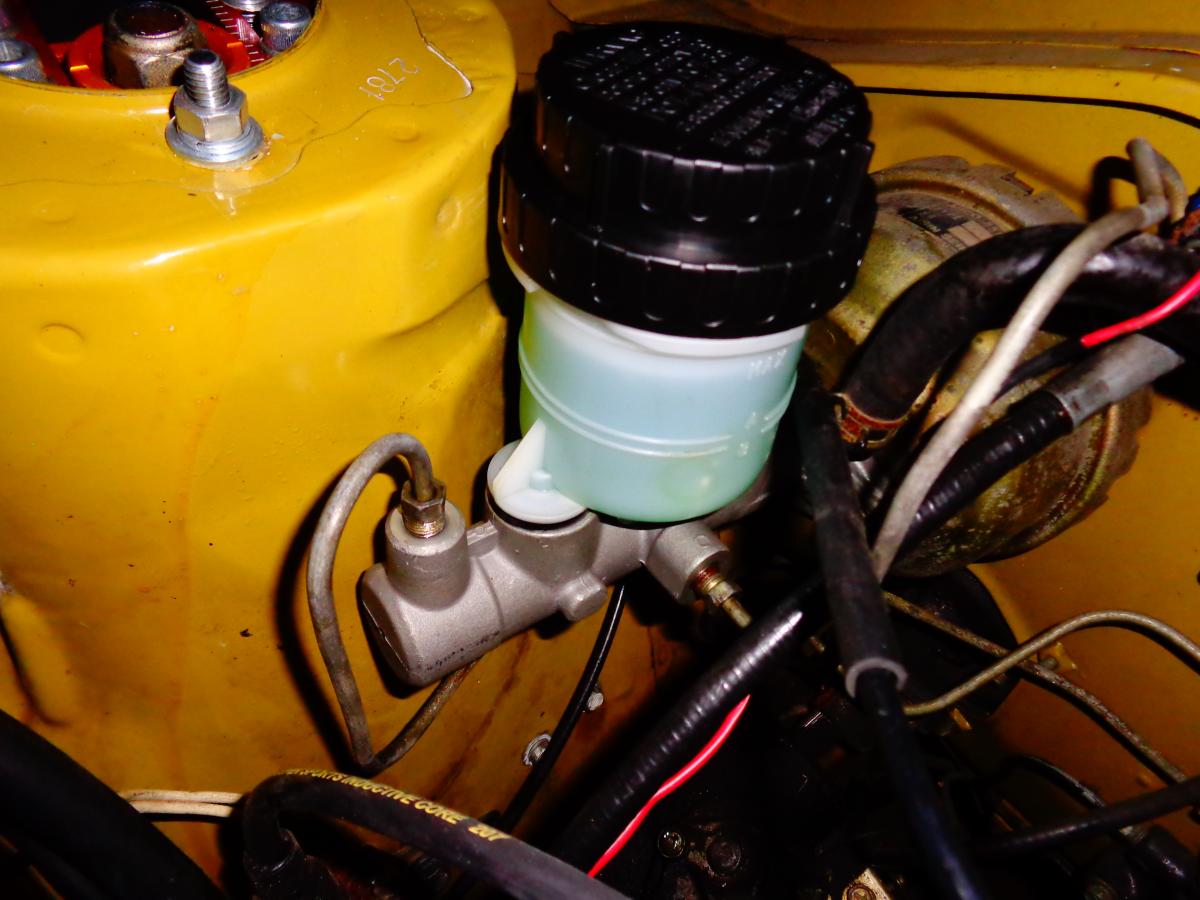

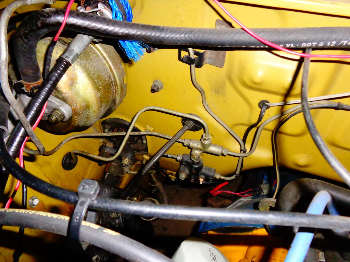

Banjo Posted August 8, 2014 Report Share Posted August 8, 2014 (edited) Interesting discussion, as I just fitted a Pajero master cylinder to my KE30 this week, after upgrading the front rotors & calipers to Cressida. I used the same Pajero MC to move more fluid into the larger front caliper pistons. Was your Pajero MC a new one, or a salvaged one ? They are only $ 61.00 on ebay + postage, so a very good idea to use a new one. I did notice, as mentioned in the Toymods link, that there are several different Pajero MCs, with all the same dimensions. The only difference is the out line ports position & style. (Models JB1712, JB1762, JB6069) Here's one with both outlets on the same side. The JB1712 model, doesn't need the "banjo" adaptor for the front brake line. I was able to use the existing lines by just bending them around a little, as seen in these before & after pics. Before: After: I did notice, as Altezzaclub mentioned, that the actuator pin/rod coming out of the booster was adjustable. I used the rear depth guage on a vernier to measure accurately the depth of the MC actuator pin/rod socket to the mounting face of the MC. I then adjusted the actuator pin/rod, so that it stuck out proud of the booster MC mounting face by exactly the same distance. Very important, when you are mixing & matching MCs and boosters. I believe the pressure limiting device on the rear line, is the one on the firewall as in the pic below. The darker slightly bigger one at the bottom. I think I'd be getting rid of that, as I believe it is only needed for combo systems where you have disks in the front & drums at the rear. I've retained my rear drums, but am upgrading to the larger 9" KE55 ones, when I fit my BW diff in. It sounds like your car has too much rear braking, with original disks on the front. Like the others have advised, the caliper piston cross sectional areas are probably all wrong. You could try an adjustable pressure limiter on the rear line, and if that doesn't work, upgrade the front brakes to something bigger, so the MC is pumping approximately equal amounts of fluid into front & rear caliper pistons. Let us know how you go. Cheers Banjo Edited August 8, 2014 by Banjo 1 Quote Link to comment Share on other sites More sharing options...

Banjo Posted August 8, 2014 Report Share Posted August 8, 2014 If you've got the time, it wouldn't hurt. The original MC will be suited to the front, and the rear will get what fluid it gets, which will probably not be enough, but that's what you need, as the rears are so big, compared to the front. If you want to "buzz" off the limiter for the rear end, get a 3 way line adaptor off the front of a KE30-55. The "goldie" coloured one in the photo above, and put a blanking plug in one port. Let us know what effect it has. At least you'll be very good at bleeding after all this is finished ! Cheers Banjo Quote Link to comment Share on other sites More sharing options...
