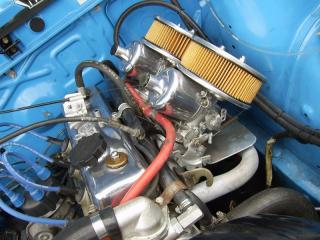

anyway heres mine when they were nice.

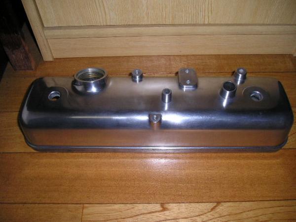

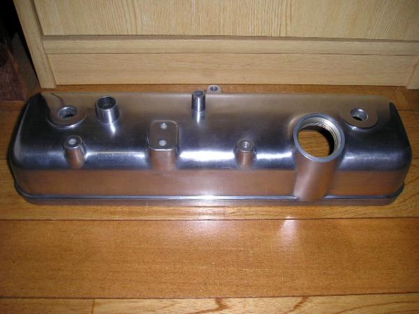

Can i just ask u guys if your cover has ever oxidised from being bare as my old 77 p/van tappet cover started to go a little funny when i did it.
Nah i used a buff on a bench grinder. LOL i sanded all the pits out first, then buffed with a hard woven rag buff then used the intermediate buff then used the fluffy soft one. And finished them off with a chux and mothers metal polish. I had way too much spare time haha.
