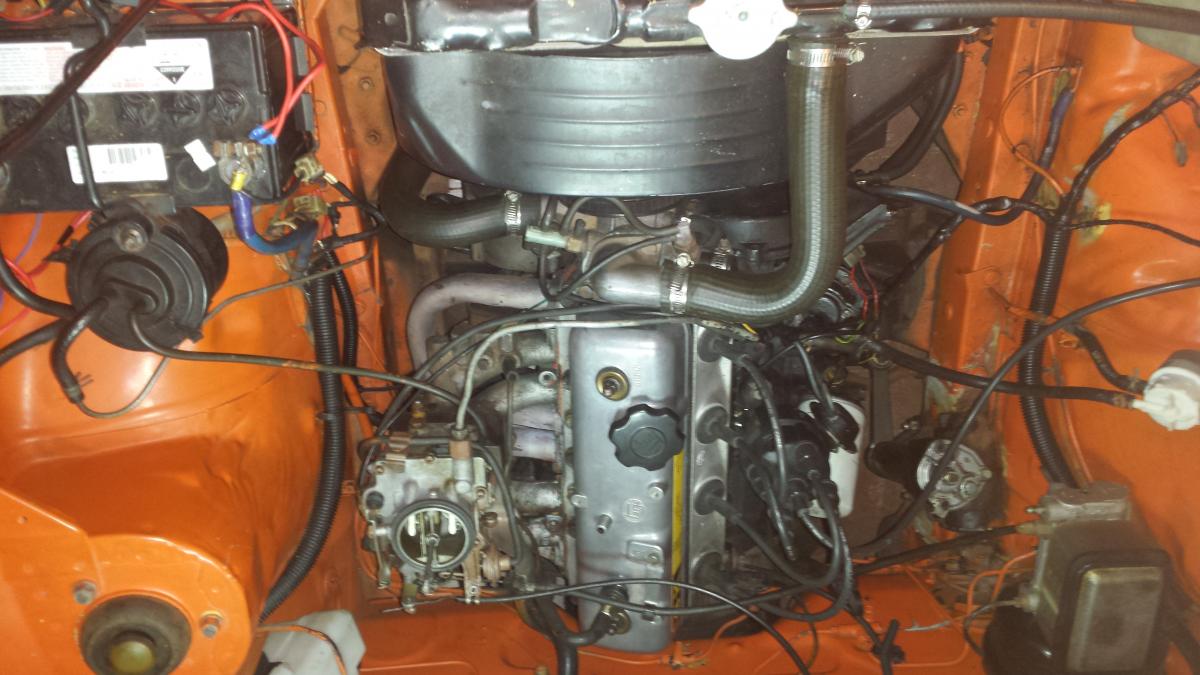

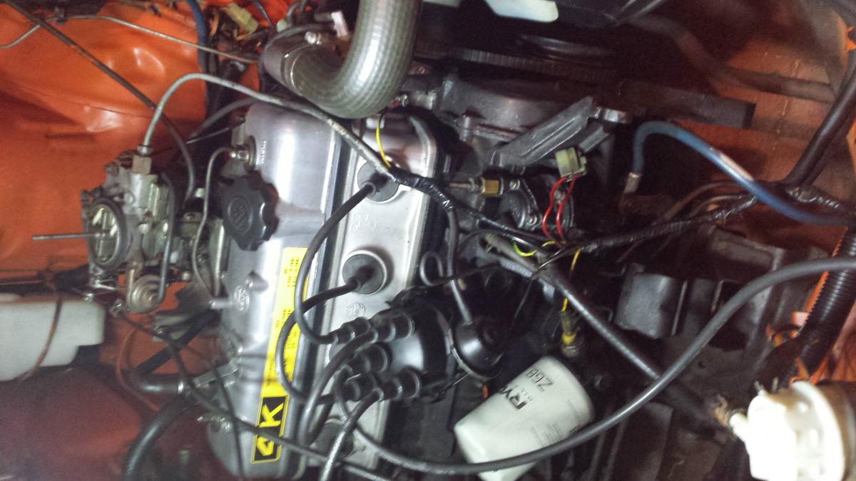

peterd Posted February 20, 2017 Report Posted February 20, 2017 Here are some photos of how an old school carby specialist reconfigured my vacuum hoses a couple of years ago when he rejetted the carby. The car runs really sweet with good acceleration. It's an auto. Quote
