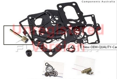

The light leather washer on the accelerator pump is a common wear point in the Aisan carbies. Maybe time for a rebuild kit, which usually includes this piston washer. Available on ebay. http://www.ebay.com....6UAAOSwEzxYQ3nX
This is the piston/plunger I am referring to.

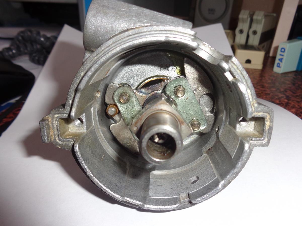

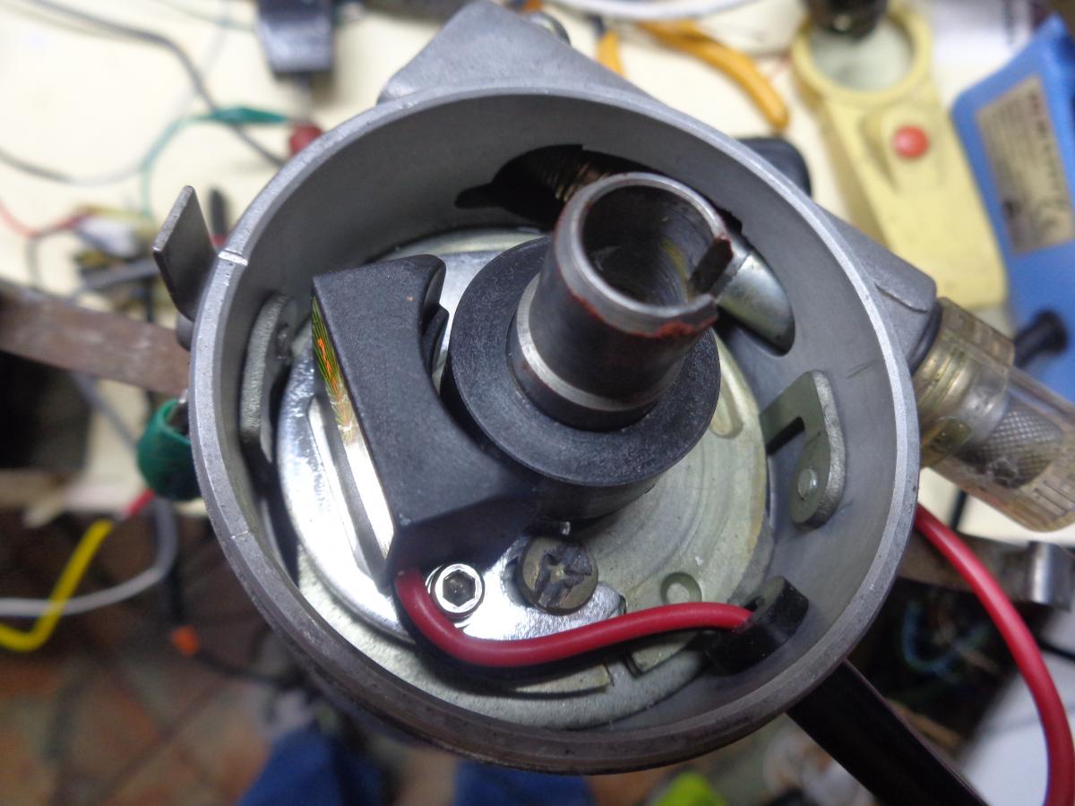

Which is why everyone should convert to "electronic points" like the Accuspark, or similar & you'll never have to change points again. Nothing moving, no pivots or rubbing block to wear. Very simple mod, which can be done in 30 minutes, with full instructions with the kit, available in Australia.

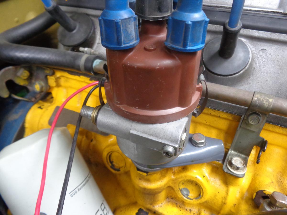

This is what it looks like when fitted in place of the existing points, in a KE Corolla dizzy 3K case.
Best thing I ever did for my Rolla. Always stays in tune. Points are only good when brand new. After that, everyday the tune drops off a little more.
The Accuspark has built in ignitor, which will drive most coils except the very low impedance (ohm) ones. Alternatively, get the electronic Accuspark to drive an external ignitor, capable of driving the hi energy racing coils.
Or you can go the whole hog, like I did, and lock up the bob weighs in the base of the dizzy, for the centifugal advance, and use the dizzy electronic points as a trigger only, for a Jaycar programmable module, or similar, where you can set the advance curve to optimum performance for your engine.
Notice the vacuum actuator is gone, as load retardation, is done via vaccum line straight into the programmable controller. Just retained the "octane rating" thumb screw adjuster to fine set the initial idling advance spot on.
