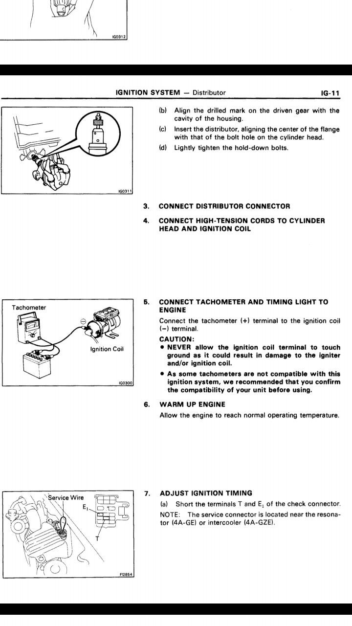

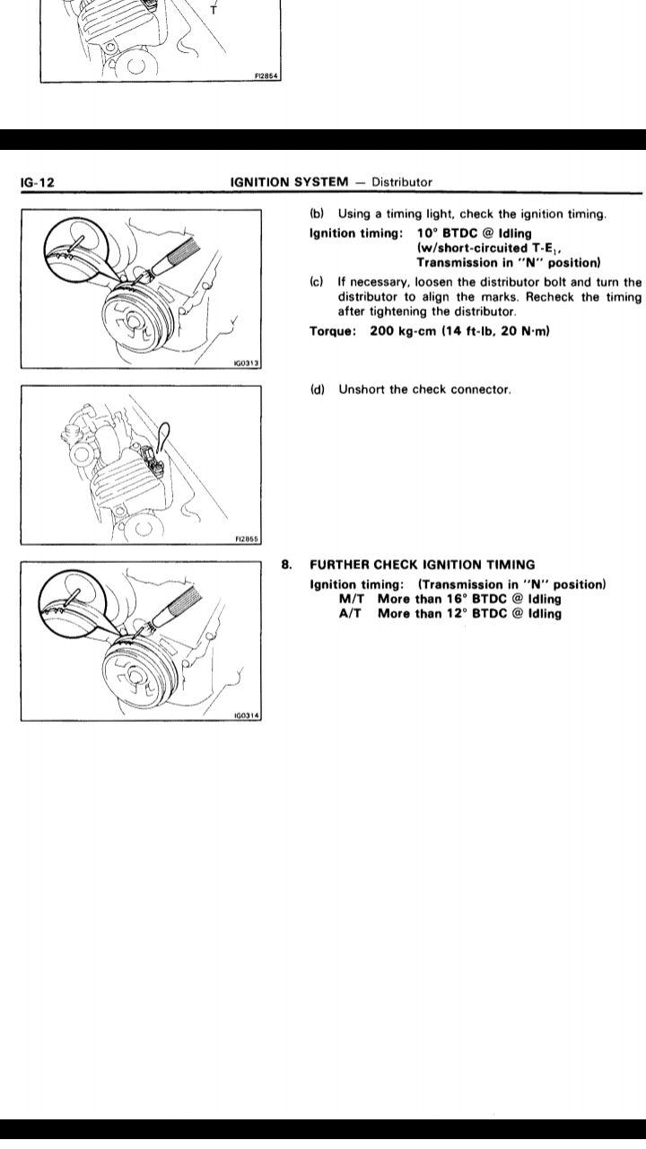

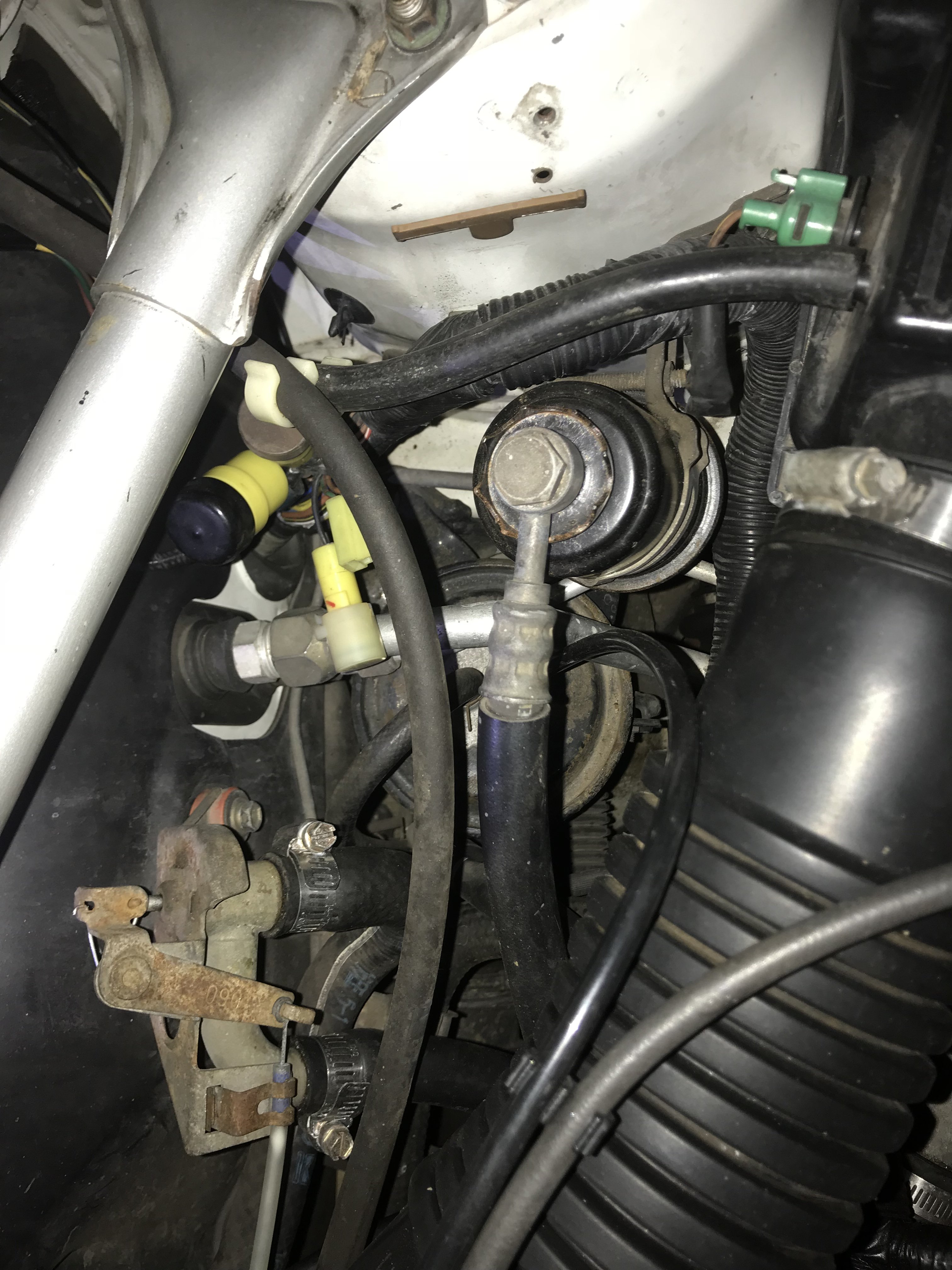

To do the timing, do you need to bridge something out. I remember on my ae86 the was a little box on the shocky tower but this one doesn’t have that. Could it be somewhere else? Or does the 82 not require to do that bridge out?

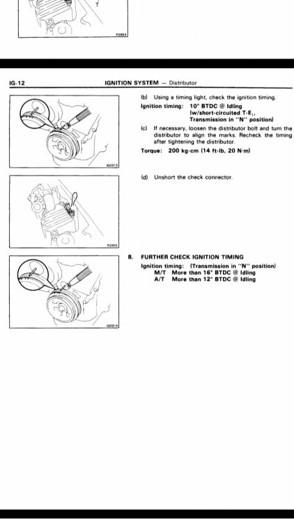

here ya go bud. here are the 2 pages of interest to u. these pages are the wrong way around, start at bottom of second one, there u find the appropriate jumpers to disable the advance.

The yellow plug on the left with the rubber cap
edit: the black cap. Use a short piece of wire with a male crimped terminal at each end.
Edited by parrot
