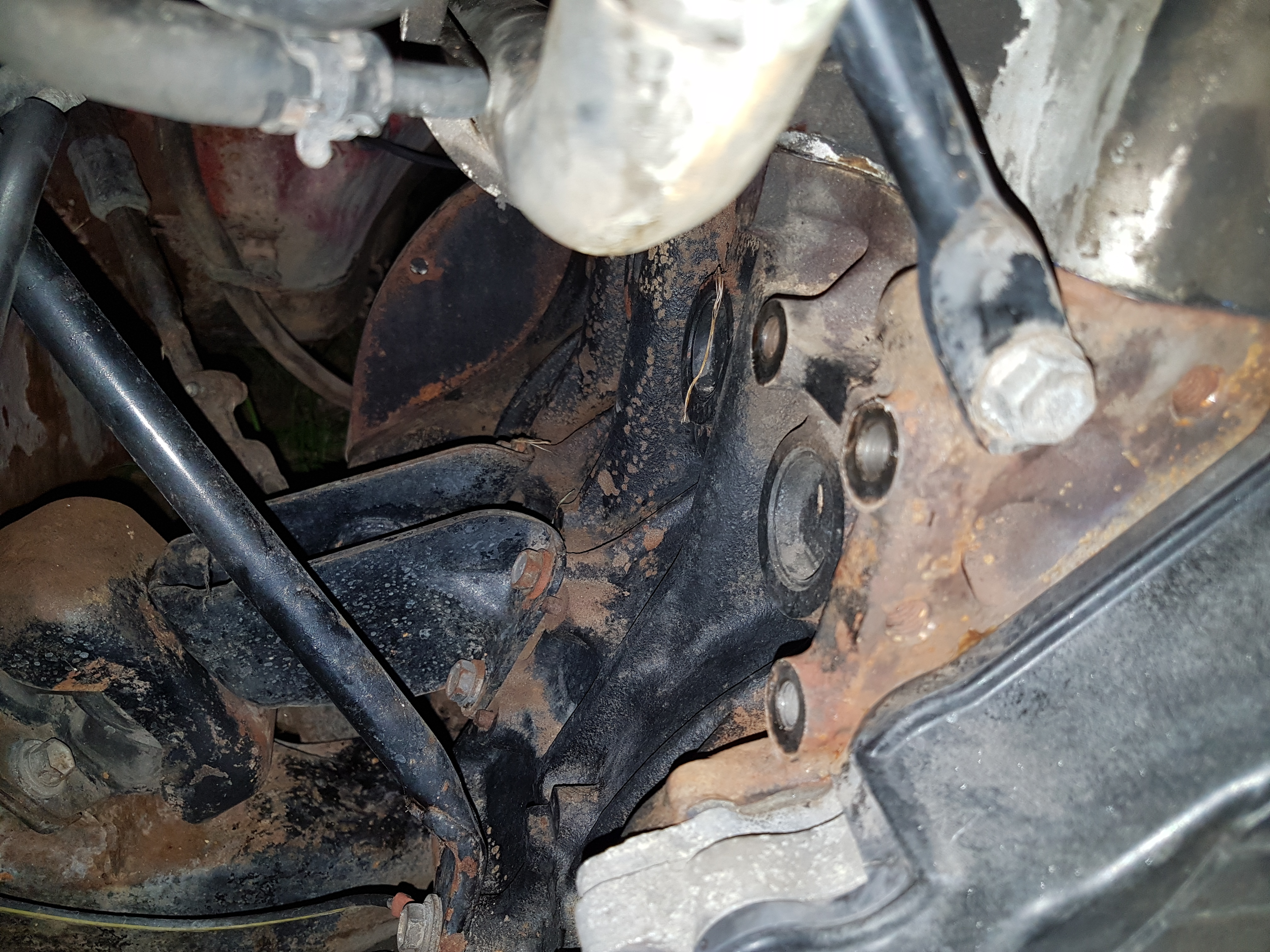

    Pile of wrecker parts. Corroded nipple from rear fitting that was tie wired on. Back of the head where the outlet was. Inside the outlet passage The r

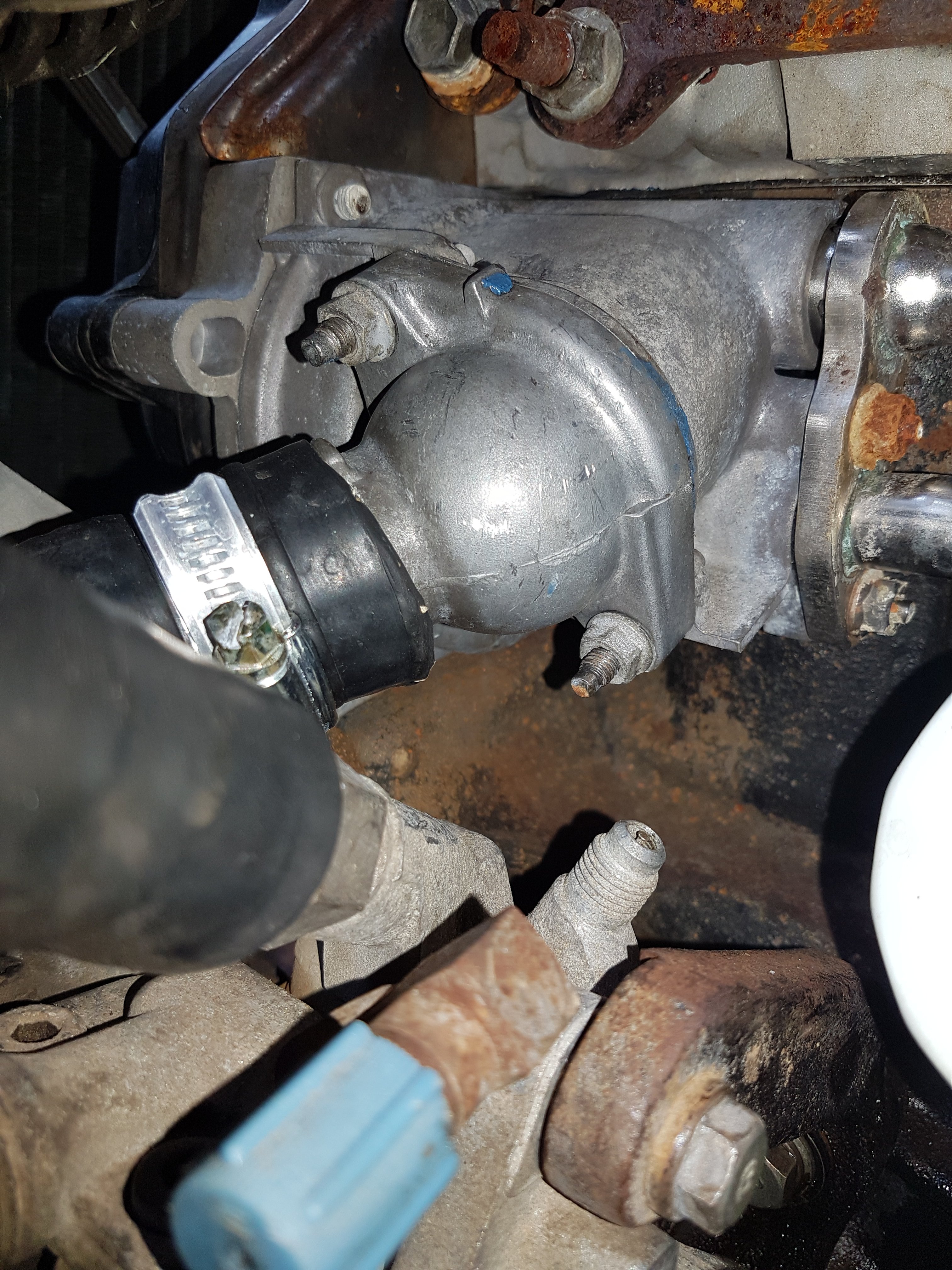

Had a close look at the front water pipe, and someone has cut the end off it and pointed it upwards, which is why I cant find anything in the epc about it being that shape.

Just got my new thermostat housing in the mail.  Its just like the one on it except it has got a sensor thread that will let me install the thermofan controller when it comes.  Also means I can return the one from repco that was overpriced as all hell.  Fuck Repco.  They just let you down over and over again.  Since my mates dont work there any more its really hard to take.

Removed rear water fitting and found a second barb that was corroded away underneath that someone had tie wired on to make it stay put.  Its now been replaced with a nipple.  All the rubber hose is getting swapped out as is the thermostat and cover.  Would love a new radiator but will see how it goes making this thing run as sweet as possible first.  The new thermostat tested well.
Have received fan switch/sensor so will try and get it back together tomorrow.  I think my blue rtv is off and it wont set properly.  Have to check tomorrow.
Flushed a bunch more corrosion out of the remaining fittings and pipes, seems pretty clean inside the motor from what I can tell.
