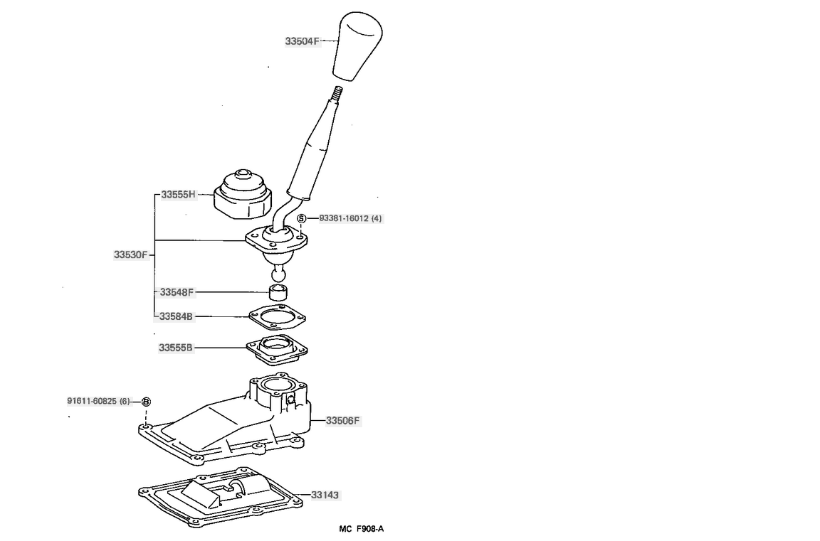

Need to look and see if it has the unobtainium shifter position that is perfect for my ae86/2az.  Be amazing if it did, that would mean the box is also from the jdm vehicle.

They must have had an sx80 halfcut judging by the way the wiring, box, sensors etc are all correct.  I guess I can now assume its an obtainable oem clutch setup, 8 bolt flywheel, and whatever else the epc shows for the motor and box in sx80 trim.  I might have a look at the tailshaft and see if its modified.  I suppose it likely is, since the gearbox is farther forward than oem, even with the rearmost direct shifter.
