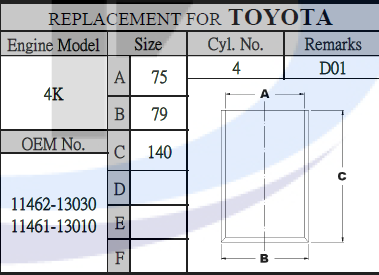

Banjo, the answer to your last question, no. The sleeve is designed for one size. Once its worn out, u press it out, and press in new ones, thats the beauty of it, its a never ending engine block.
and in case anyones thinking of bringing a stuffed oversize bore back to life by inserting a liner to bring it back to standard, it may not work.
these are the dimensions of the std liner
ID 75mm
OD 79mm
so the walls are abotu 2mm thick.
Hi Jeremy,
                  Thanks for that info.  That's great, & I'm now much better informed.  Do they also produce these cylinder sleeves for the 5K, which has have a nominal bore of 80 mm ?
The advantage of oversizing the piston & bore, when an engine gets to that point in life; is that you finish up with a slightly larger swept volume in the cylinder, which with the same head & gasket thickness, increases the C.R. a bit.  If you skim the head at the same time, that also increases the C.R.
P.S. Actually, I just looked up the Toyota factory "Yellow Bible", for the 2K-3K-4K-5K, & it says you can oversize 3K & 4K blocks to 1.0mm, but only 0.50mm for the 5K.  That indicates, that to fit the sleeve, with a 2mm wall thickness, you would have to bore the block cylinder out a whole extra 1.00mm, in excess of the normal maximum o/s bore size of 1.0mm. If that doesn't result in breaking into the water jacket, then there appears to be quite a bit of "meat" in those cylinder walls, in the block castings.
