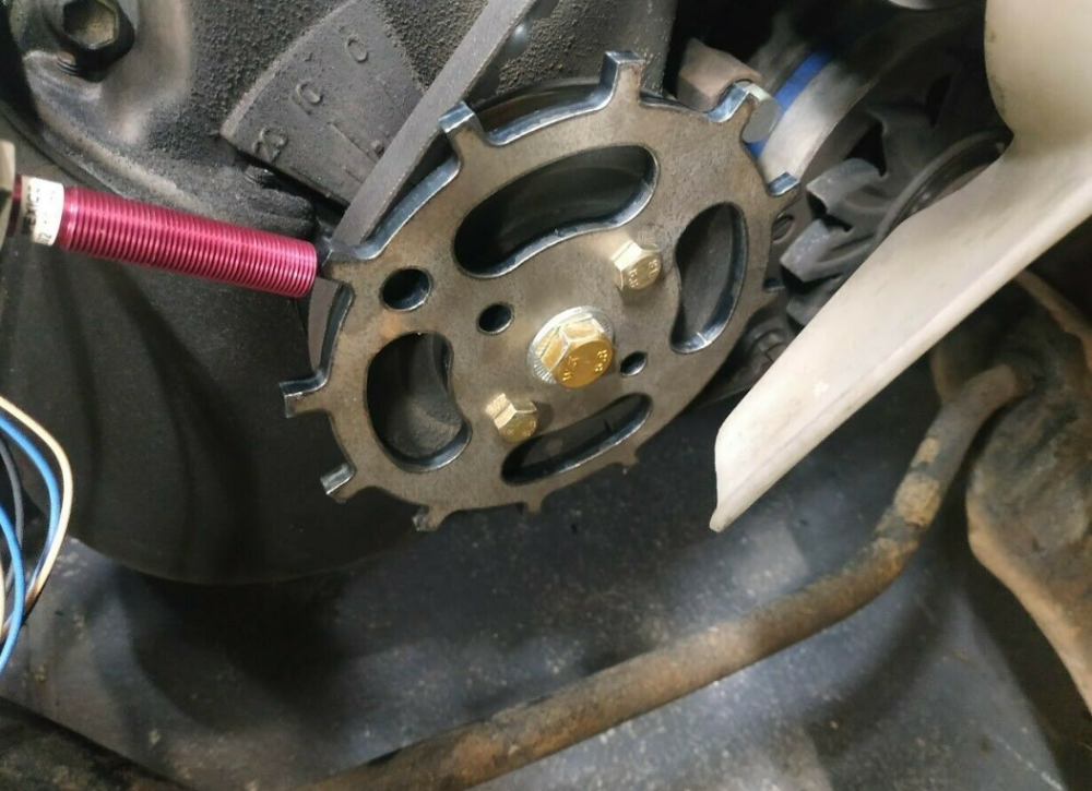

Heres a better photo of my setup. I run a 12-1 with the a ZF Cherry Red Hall Sensor. The sensor is about $40 on digikey or element14.
I've done about 15000kms with this setup running a Speeduino ECU and quad throttles. Great fun!
The wheels themselves are laser cut from 6mm mild steel so they don't look as nice as CNC machined ones.
So far I've made 12-1, 24-1 and this week 36-1 patterns.

Hi Daniel,
                Thanks for that larger photo !   I suggested in this thread earlier, that an ideal point to mount the Hall Sensor bracket, would be to two (2) mounting points, on the lower front edge of the 4K block, where the A/C mounting bracket was attached.  Looks like you might have used those holes also.
Could you provide us with a picture from the side, so that it depicts the whole bracket assembly ?
Thanks !
Banjo
Hi Banjo
Sure thing. Yes those are the 2 holes i used for the bracket. The bracket is just a kinked bit of steel angle.
