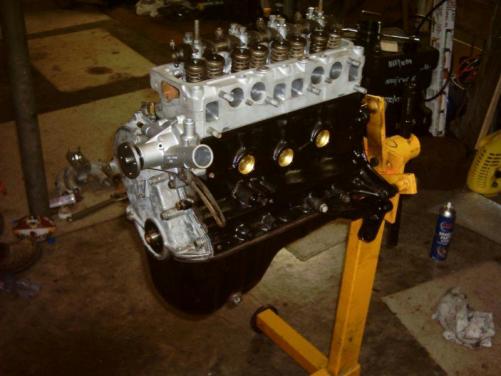

Felix Posted July 2, 2006 Report Share Posted July 2, 2006 an easy way to narrow it down is to look for the 2 knobby bits under number 1 and 4 spark plugs, circled in the following pic. Â only normal dished piston 5k's and dished piston 4k's have them. Quote Link to comment Share on other sites More sharing options...

turbo_rolla Posted July 2, 2006 Report Share Posted July 2, 2006 Cool, thanks for that felix! :dance: Checked all the plates on the cars there and they were all 4k's or 3Y's i think (in the liteace's). Is it going to be possible to see the stamp on them (the engine) if they're still in the car? Mite go back out there sometime armed with this knowledge and have another look, and if no luck then i'll share where it is :P Looking like it'll be a mild worked 4k sticking around though (though i did dig up my old conversion question thread where nick suggested a 3tc out of a t18....... :D). Quote Link to comment Share on other sites More sharing options...
