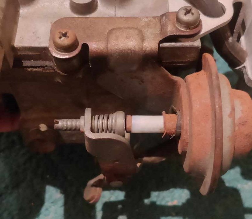

So Guys somewhat of a successful weekend, I bought a ASIAN 7B Carby off a bloke, slapped it on the wagon, and fixed my idling issues, was able to idle the car at around 900rpm, also does not stall out at traffic lights or when I am driving it hard from 70km/h and come to sudden stop it keeps on purring. Thing is though I cannot adjust the idle screw to idle below 900rpm to get it to idle at 800rpm oem spec but still 900rpm is alot better then what I had before, the port for the idle stopper is already all the way maxed out.
But also my choke cable is not currently connected as the end of it is too frayed to put back in, so gonna order a new choke cable not sure if that makes a difference to idle speed. But I think I need the choke to be able to use the high speed opening so the choke butterfly closes at high rpms therefore increasing my rpms as I gain speed. Turning the idle stopper anti-clockwise pushes the throttle linkage down more which then gives you a more lower rpm, then I think you use the idle screw to push the throttle linkage back to ideal rpm but in my case my idle stopper as you can see in the picture I have turned it in all the way in but is still idling 100rpm over oem specification.
I may have also not connected my vaccum hoses in-correctly but I am pretty sure I have, Ill ask some Toyota oldheads at work and see what they say.
Another issue that came up something is ticking when I hit the accelerator pedal to accelerate, I though it just might be the choke cable vibrating against linkage parts. I will try and bend the frayed end and see if I can make it straight enough to get it through choke linkage hole.
