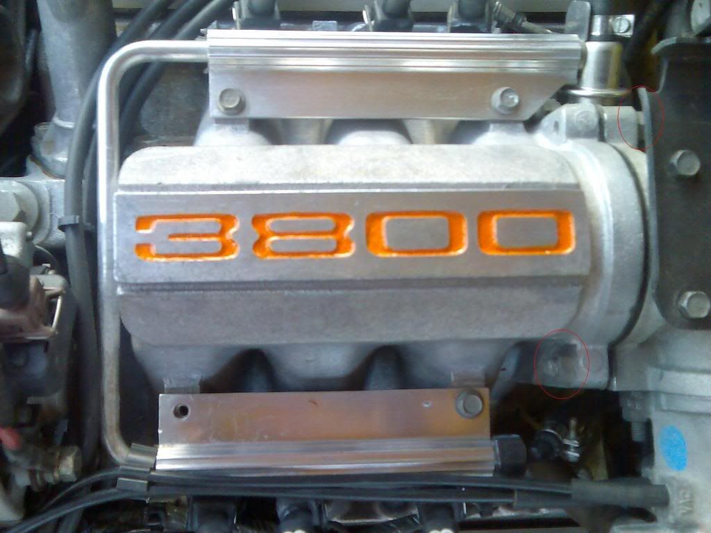

decoop Posted November 20, 2007 Report Posted November 20, 2007 You just take it out. You can clearly see the black bit of plastic between the plenum and the 90 degree bend, thats the face of the bellmouth. Where the 90 degree bend meets the plenum, there are 3 bolts to undo, undo them slide the throttle body and bend out of the way and pull the bellmouth out. Making sure you don't damage the gaskets either side of the bellmouth. then once you have it out, put it back together. Shouldn't take longer than 30 mins to do it. Â here are the top 2 you have to undo and there is one underneath. Quote
