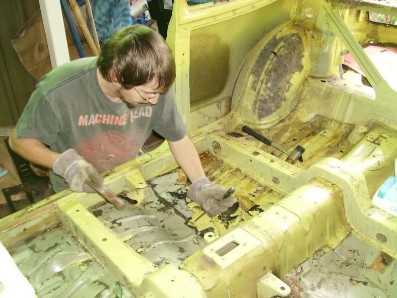

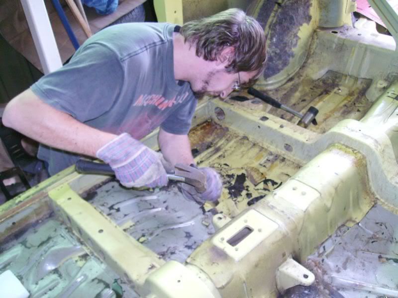

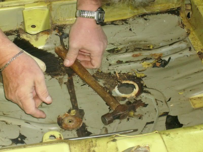

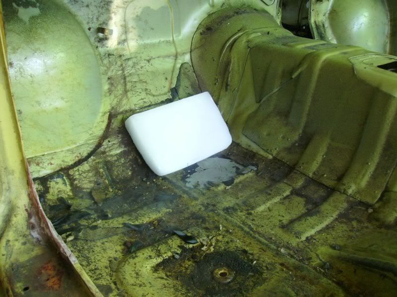

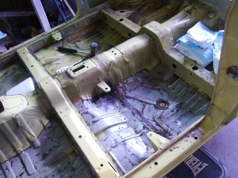

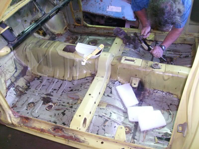

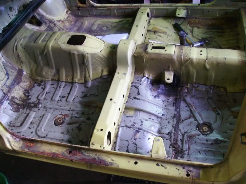

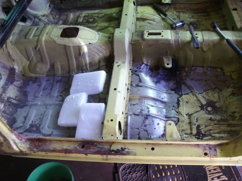

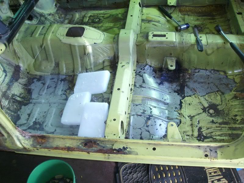

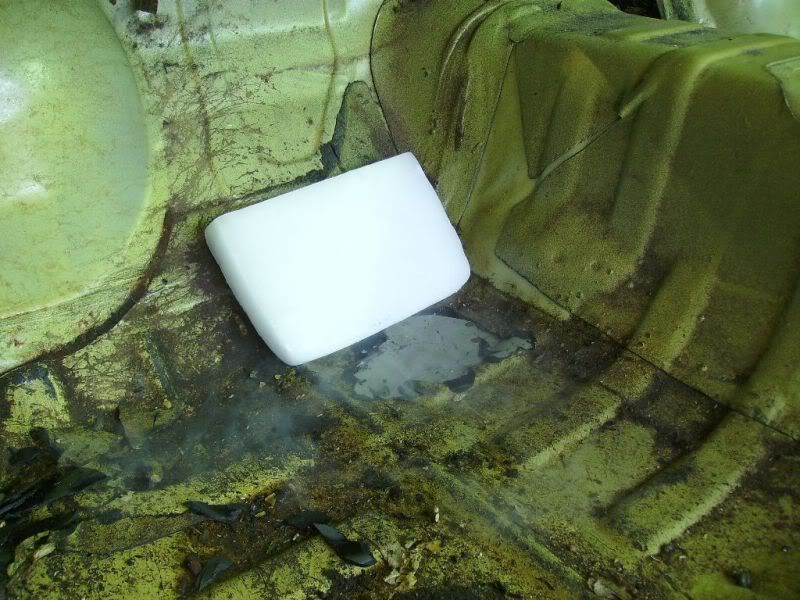

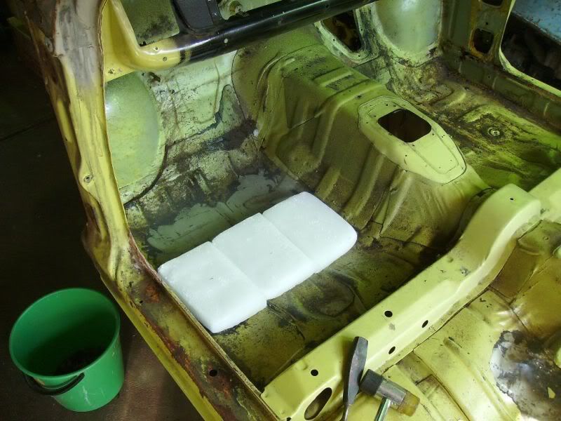

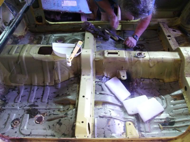

So today, I bought 3 blocks of dry ice for a total of $36.00 and here's the progress...
  • Replies 462

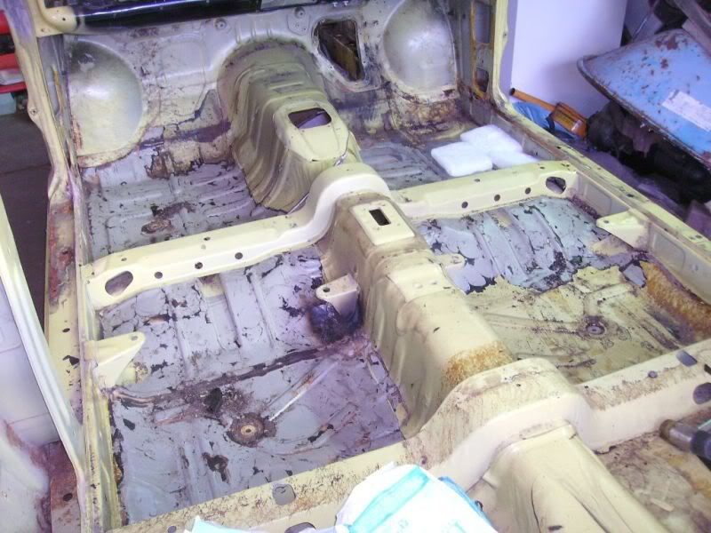

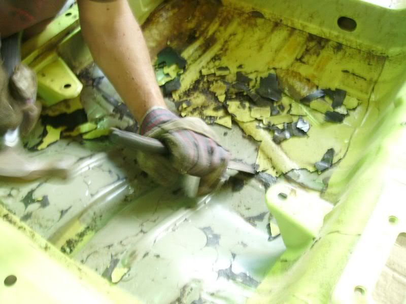

Thats all the sound deadening I wanted removed, so next, my old man and I got started on the rust!

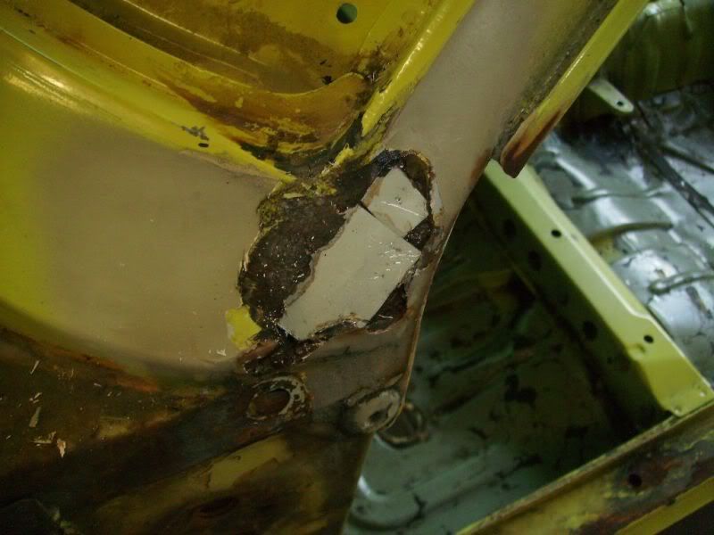

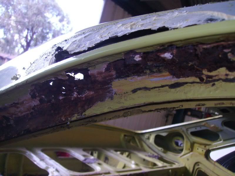

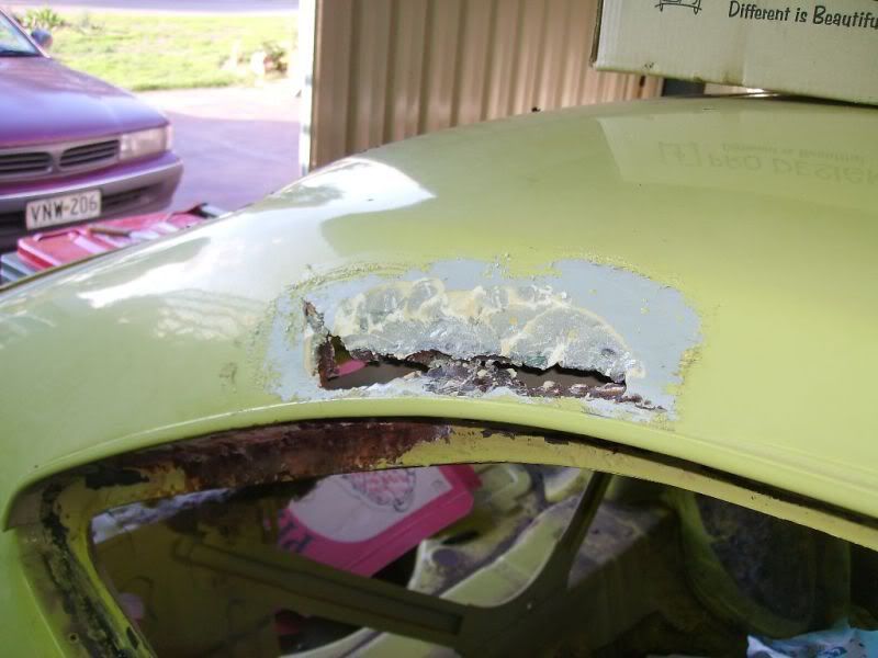

These are two of the three major rust holes in the car that I knew about and that roof one is going to take someone a pretty penny to sort out, thats for sure!
The car is now ready for sandblasting and soda blasting, but first I want to save up a little bit more cash so I can take it elsewhere to get the rust sorted.
Enjoy!

If you don't mind me asking, and hopefully you haven't already said, but where abouts did you buy the dry ice? Be good to know for reference :hmm:
Cheers Fusion
I bought it from Dry Ice Supplies on Commerical Road at Port Adelaide, across from Hungry Jacks.
Its actually a fishing store, believe it or not, but they sell the stuff for $12.00 per block.
Also good fun for putting in hot water when you have some left over.
That rust looks nasty, Raven! You're definitely going to have to get that sorted.
Keep up the progress pics.
Haha!
Yep, sure does. Gonna have to find someone who's willing to fix it as well and do a proper job of it.
Might wanna show your mum's b/f the pics and see if he's capable of welding in some new metal for me Lexxi :bash:
Might wanna show your mum's b/f the pics and see if he's capable of welding in some new metal for me Lexxi :y:
I'm sure he will be delighted! I'll ask tonight if I remember :bash:
next time you got some dry ice, chisel up a handful of cubes, chuck em in an empty PLASTIC bottle, add 200ml's of water, tighten the lid and run.
otherwise good lookin Mick.
Edited by mitch4397
Yeh dry ice is fun haha. How many hours work was that Mick? It came up a treat, I would have just used a heat gun and a scraper, which is effective but not as neat a final result. Now though I'd definitely use the dry ice!
Hmm, took me a good 2-3 hours I reckon until I got the hang of taking off real big bits right at the end.

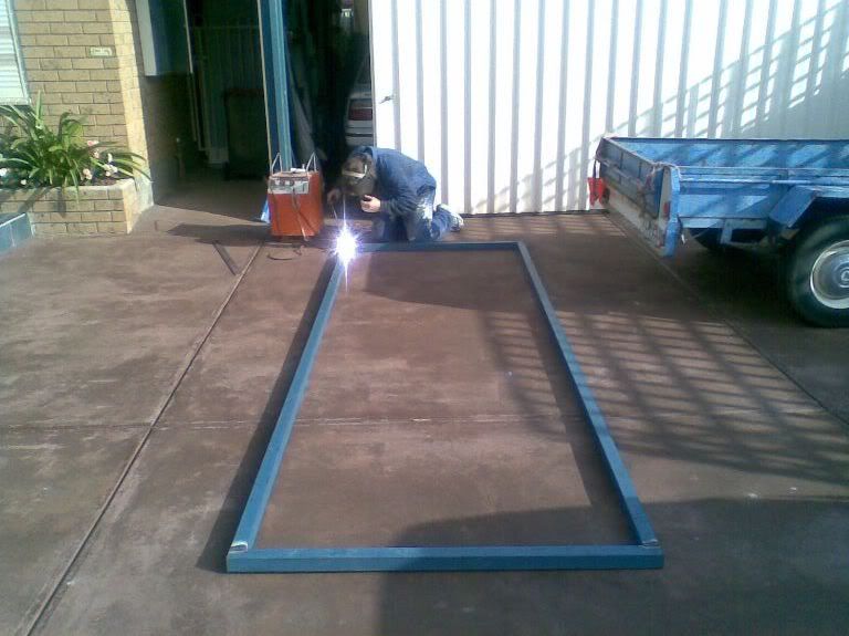

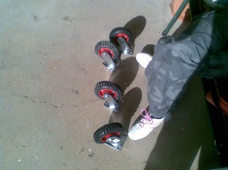

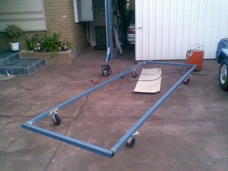

- The Rolling Frame -

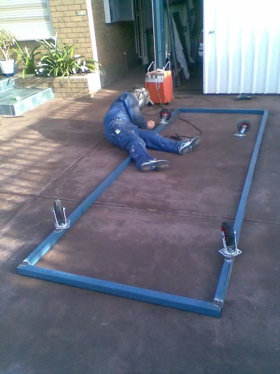

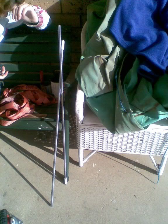

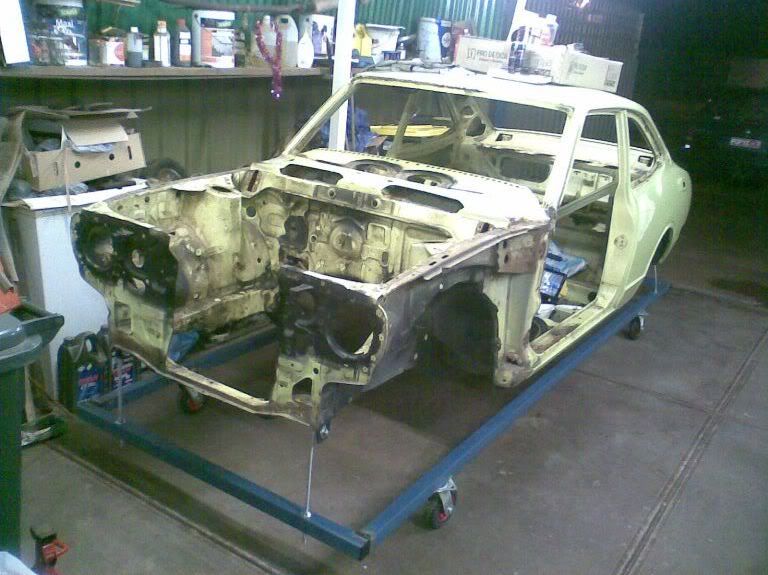

Today was spent picking up some steel, 300kg-rated swivel castors, two lengths of threaded rod and 20 nuts and washers to create what you see below.
The 300kg-rated swivel castors...
The threaded rod...
The 50mmx50mm box tubing...

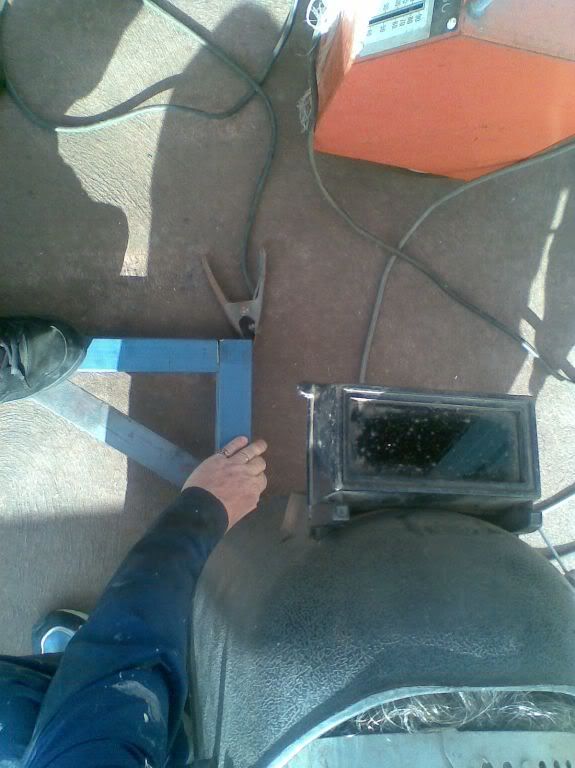

The start of making the frame
Yep, I'm using this image twice to show the progress!
Welding on the swivel-castors...
The base assembled!
We then drilled and attached the threaded rod, making the whole assembly height-adjustable :bash:
So thats the end product, I'll get better pics on Monday if I'm down that way.

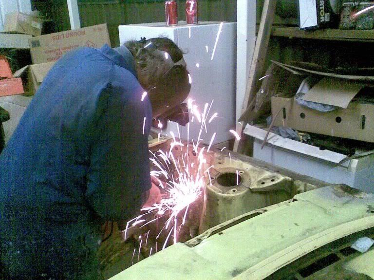

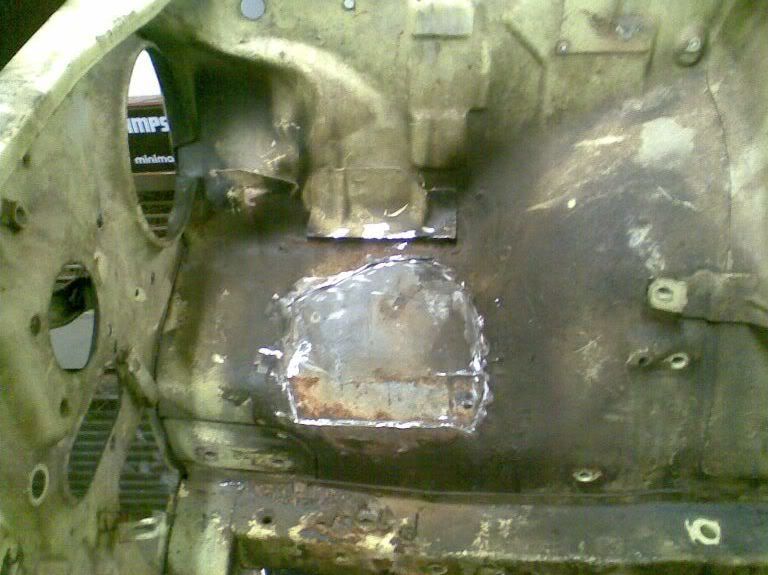

After that was done, the old man proceeded to remove the rusted battery tray. The area had been plated before, but hasnt been done to the standard I want it to be done at.
Grind grind, cut cut!

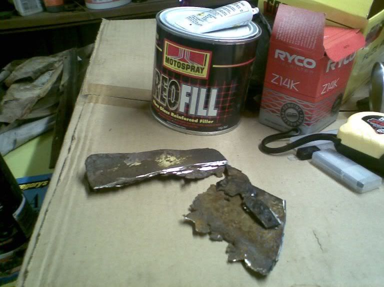

The hole in the bodywork where the rusted metal was cut out (more to be done next weekend when we drill out the spot welds to remove the rest of the bracket).
The removed rusted metal bits. Nice!
