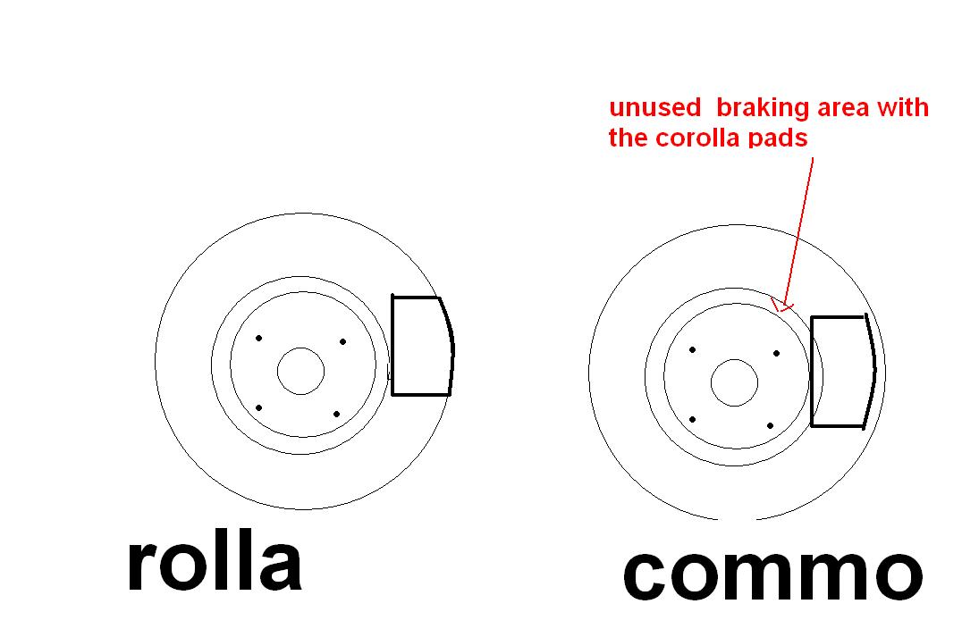

hey all I'm just doing some work on the ke30
eg. new balljoints, front bearing's, disks and pads
i went to the the brake and clutch shop and got some new rotors for the rolla had to get them orded in
but some how the bloke got the wrong one's he got ke55 rotors
and he reckons the ke55 rotors are a 1mm bigger then the ke30 rotors???
will they still fit on my ke30 struts and caliper???
or do i need to put the ke55 calipers on??
cheers shaun

- - Evan G   i tried vn commo rear brakes in the front of my 55...   Feb 10 2010, 06:46 PM
|- - shauns ke30   ^^^^^^^^^^^^^^^^^^^^^^^^^^^^ pic sounds good   Feb 10 2010, 06:50 PM
|- - Evan G   QUOTE (shauns ke30 @ Feb 10 2010, 07:50 P...   Feb 10 2010, 07:23 PM
