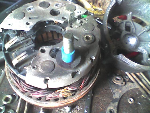

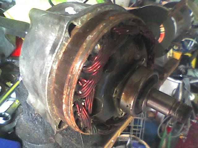

So I did a bit of fiddling and found the body for the KE70 one is the same size as this one. So I began pulling the 70A alternator apart to get the insides out so I can put it into my KE70 alternator. First I got the pully off then the front housing but I got stuck at the outer stationary windings. See photo below:
After pulling on it a bit I found A on the bottom of it it is attached to wires. So how do I remove these windings? As I don't want to break the windings so I can use them in the DIY KE30 alternator I'm trying to make.

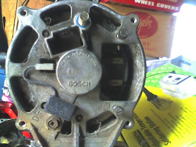

And just for reference here is a photo of the back:

After following Trev advice pull harder I got the first alt apart :y:

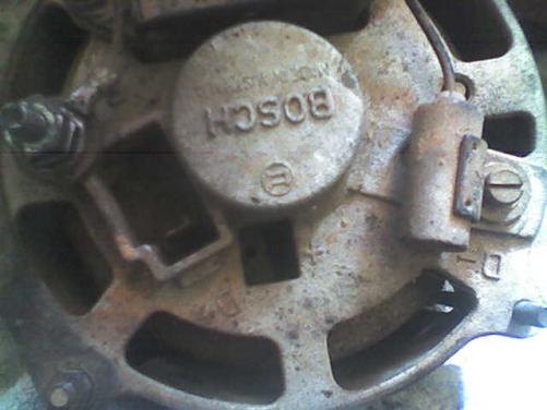

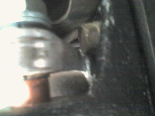

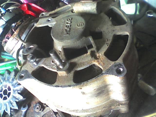

I then proceded to remove the KE70 one. But before I got to far ahead I noticed the main power feed from the back of the KE70 one is small as compaired to the truck one. So I did a few calcs and there isnt enough meat on the back of the KE70 one to drill the hole out so below are 2 pics the first is the KE70 power feed the second is the truck one. So what I have decided to do is putthe truck one back together and just make a spacer to fit in the gap between the 4K alt mount and the body of the truck one and use a corolla pully and then ill be set.
Above is the KE70 alt and power feed terminal.
This is the truck alt power feed terminal as you can see it is about double as bit.

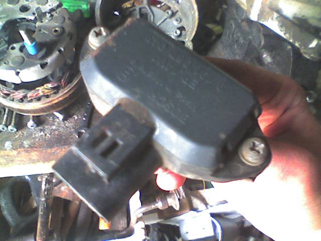

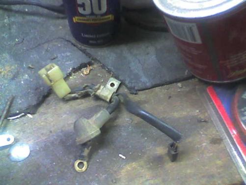

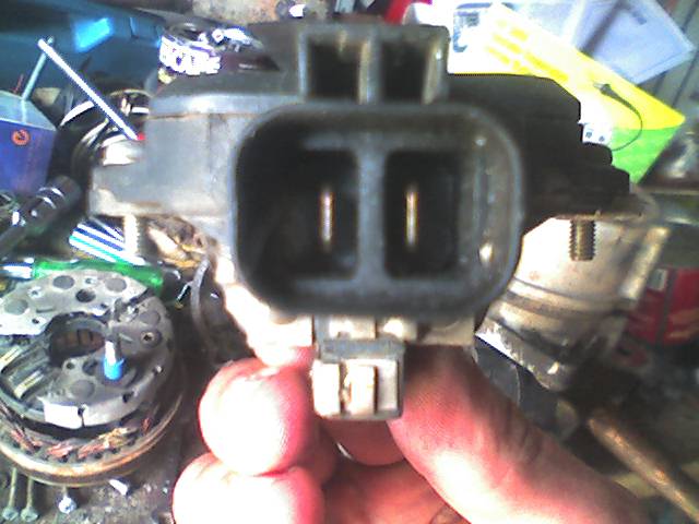

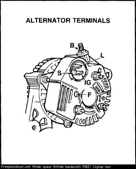

So just a question now about wireing up an alt. The truck one has one of these new style plugs on it (see below)
On the left of this plug the left pin is labeled S and the one on the right of the pic above is labeled L (the L is stamped upside down). On a standard KE30 I know wire the main power feed in to the bolt then what next? what wire should I cripm ont eh KE30 and push onto this plug?

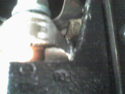

This 70 Amp alt lets just say it is dirty but LOW Km's and is like new so it is all fine. I will not cut the mount on it but as all I will need is a 10mm spacer and it will go onto the 4K motor mount AND the pully will align so less hassel. But Ill get a pic soon of the spacer and how this alt will fit.

i think i may be of some help here....
the 'truck alternator' u have the pic of looks more like one off a VS commodore... with the re71/72 regulator on it.

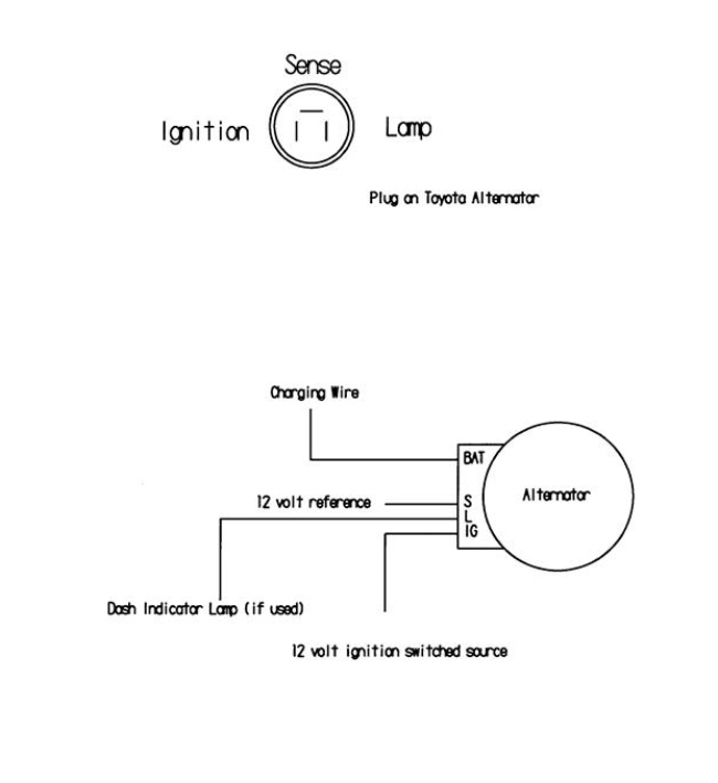

the two pins in that plug:
1. 'L' controls the warning light on the dash (must be operational for alt to charge)
2. 'S' is actually a sense terminal which senses battery voltage and can step up the charge rate to compensate for extra load... ie h/lights/stereos...etc but can be simply linked to the main B+ stud on back of alternator
Ok the alt I was told is off a small truck and the regulator I'm holding is off another truck 110 amp alt. But knowing bosh the 70amp one I have is the same as the dunny door one as most of there stuff is universel.
Thanks for pin info on plug will help lots.
Cameron

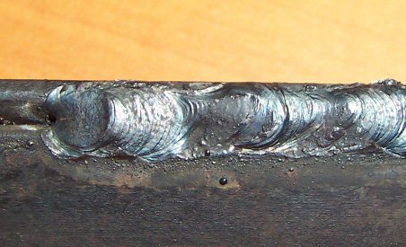

But a pic below of what an alt welder can do:
This pic is of the 55A running at 55A to weld was afast dodgey welld with out a good stick handel even so not to bad..lol
So an alt will make more than it is stated max on the case BUT you will need more input power and since a car only has 12V battery well that will be hard.
