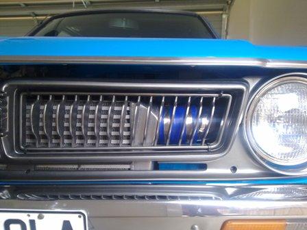

  13. here is a pic of mine, you can't really tell unless you get down you can have it and play around with it?

  17. mine is 76mm thick, the fins on the grill have been cut from the grill and mounted forward in a unique method, err zippy ties, haha you would not notice it if you got down and look at it closely
