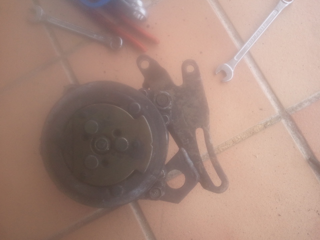

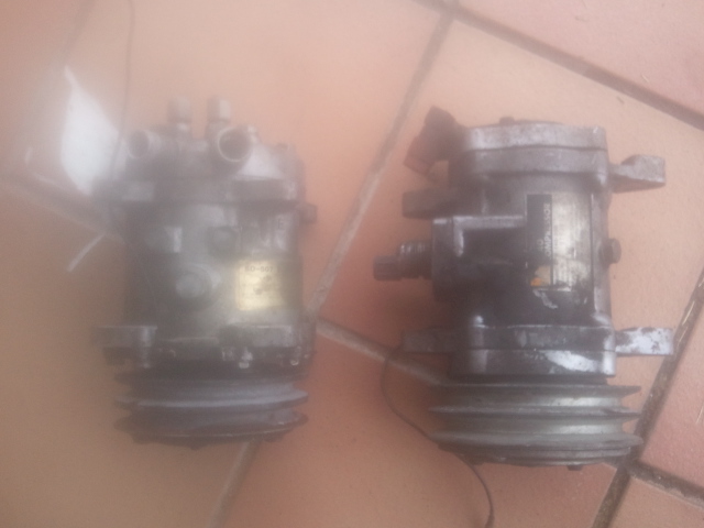

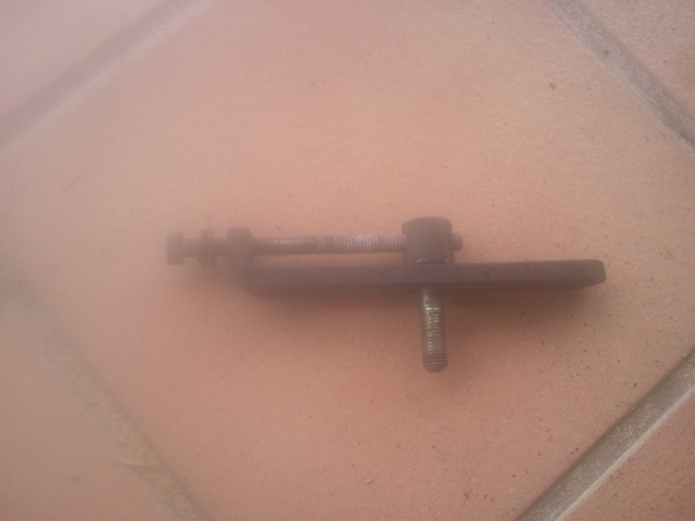

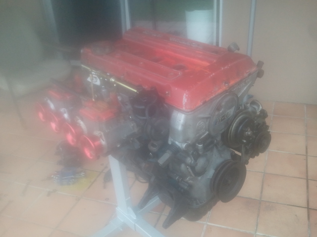

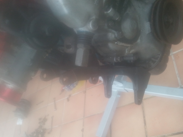

  5. Hey Guy's, I currently have a T-18 Project I'm Doing up and I'm having some trouble setting up the Air con... I'm going to be running a 3T block with 2TG head (already built) I'm having trouble figuring out the Standard Air Con Setup..... I Bought a 3T-C A/C Bracket today which fits appart from the twin cam Chain tensioner hitting the top where the 3T-C Air pump normally goes. But that's not the issue as i can just Cut off the top of the bracket to fit... The issue is i can't figure out how the A/C actually bolts up to the Bracket with the Tensioner Correctly.. If anyone has a Standard Air Con setup on their 3T it would be great if you could take some pics of how it all fits up so i can figure out how I'm meant to make it all fit! Ill post up some Pics of where I've got it to so far... just charging my phone atm... Cheers 3T-G running Twin Dellorto 40MM Carby's The Standard 3T A/C Bracket Not Sure which of these is the Right Pump...?? :S Theres also this random bracket which came fitted to the Pump when i bought the car... This is the Tensioner Peice i have...

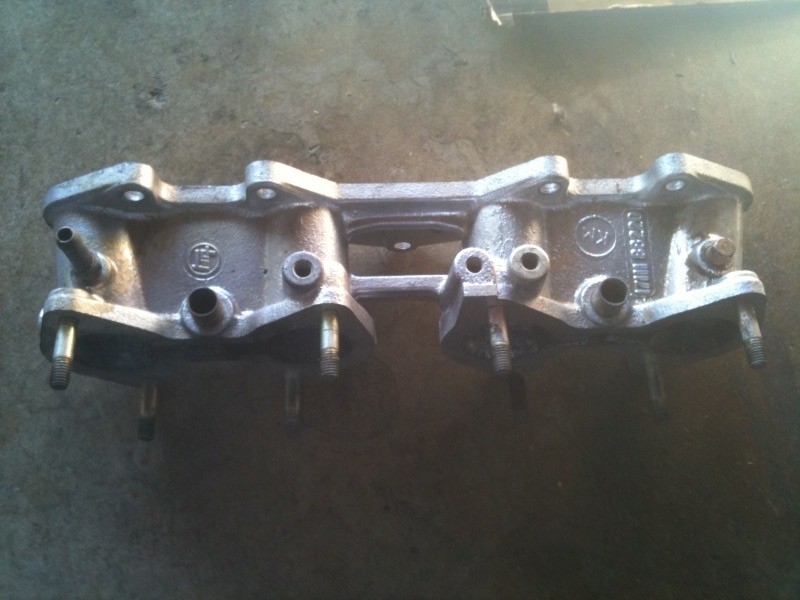

  9. Yea 2TG manifold bolts are on opposite sides to 3TC... 3TC Below 2TG Below 3TC is Push-Rod, 2TG is Twin cam so different Head = Different Mounting Setup

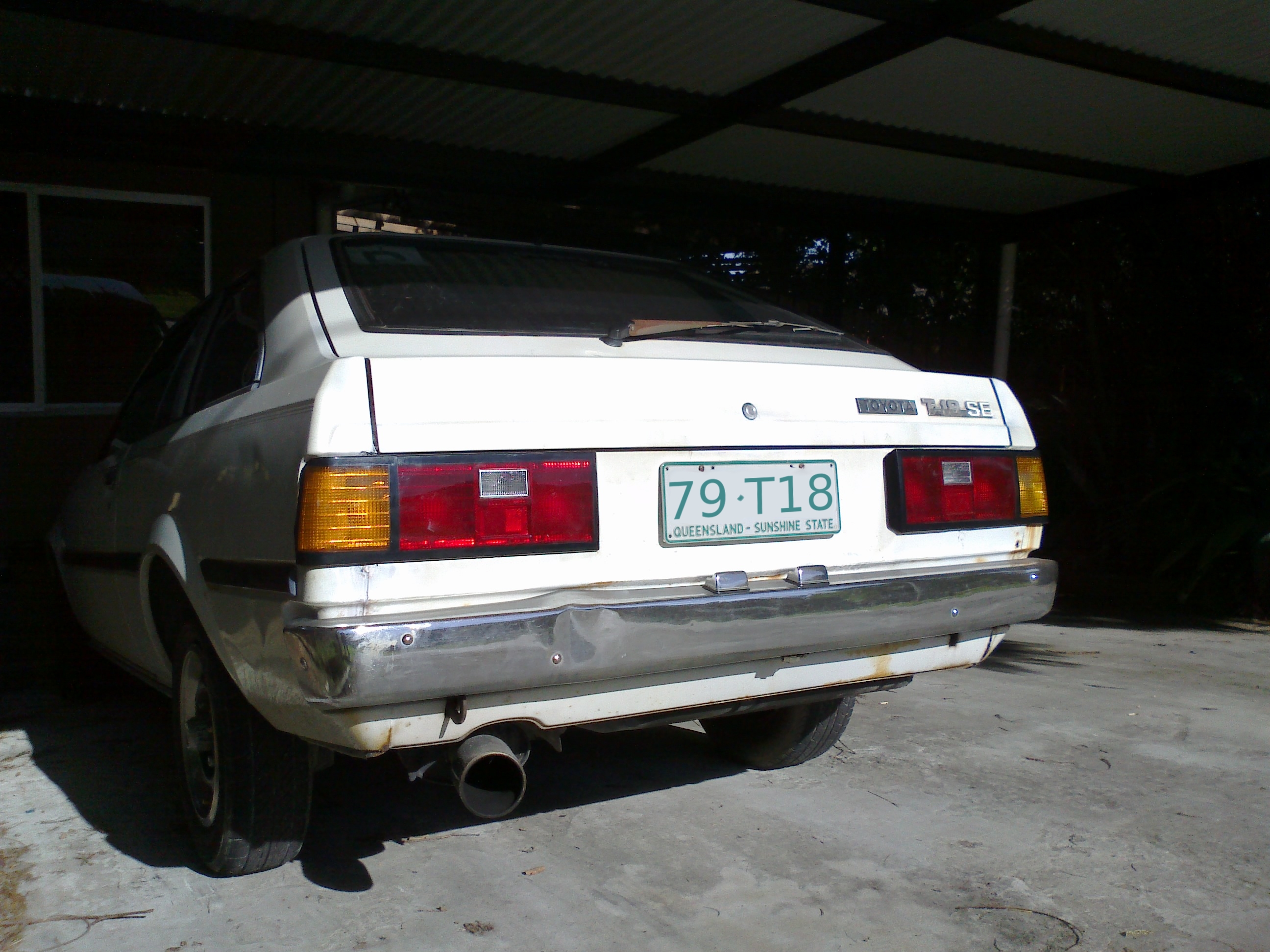

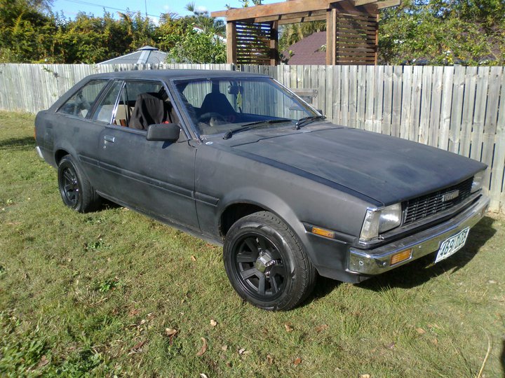

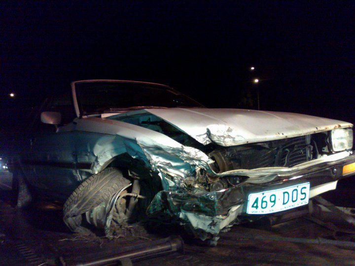

  13. Been A Long Time since i Updated... Long Story Short... Fell Asleep on the Pacific Highway just near Dreamworld (kinda Ironic) the guard rails werent Kind the the car, but i got away with just a bruise... took me a while to get back on the road... but i bought another T18 which is a Series 2 with Series 1 Grille Lights, Bumpers and Tail Lights... Sits on MA61 Supra wheels (which i bought)
