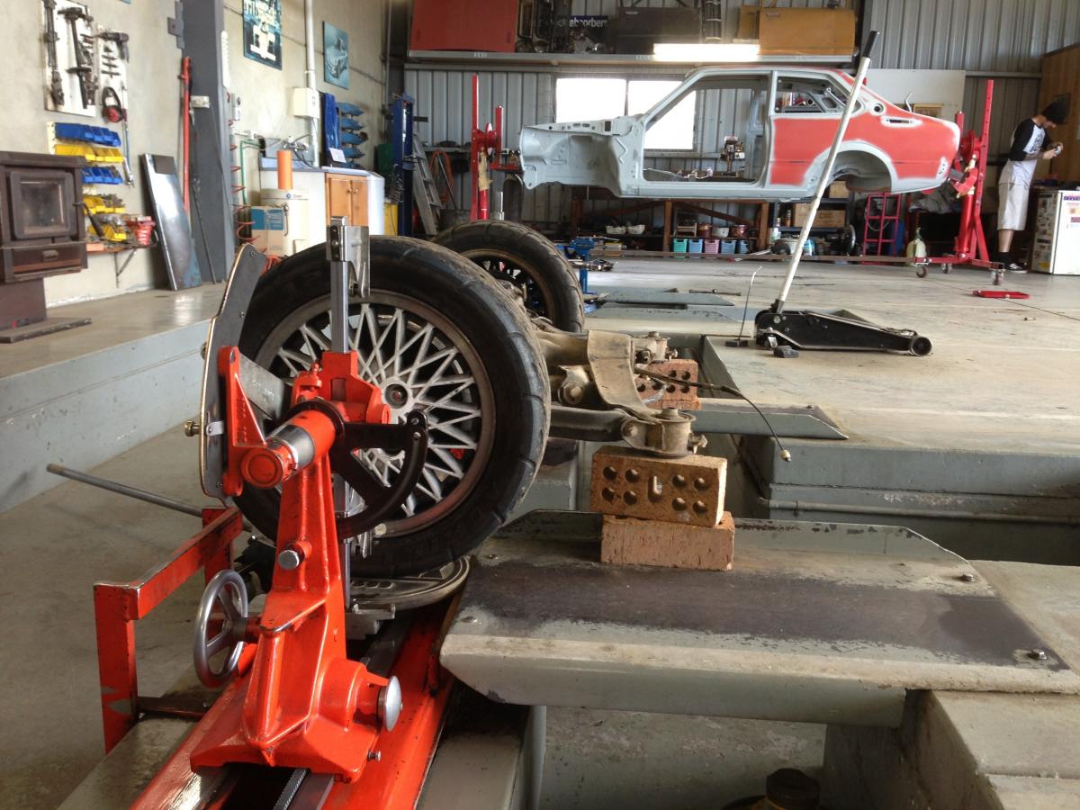

  3. Yeh propped it up on dads aligner, worked out the mounting height etc, gonna make up a camber kit for it to take it from -2.3° back to -1°
