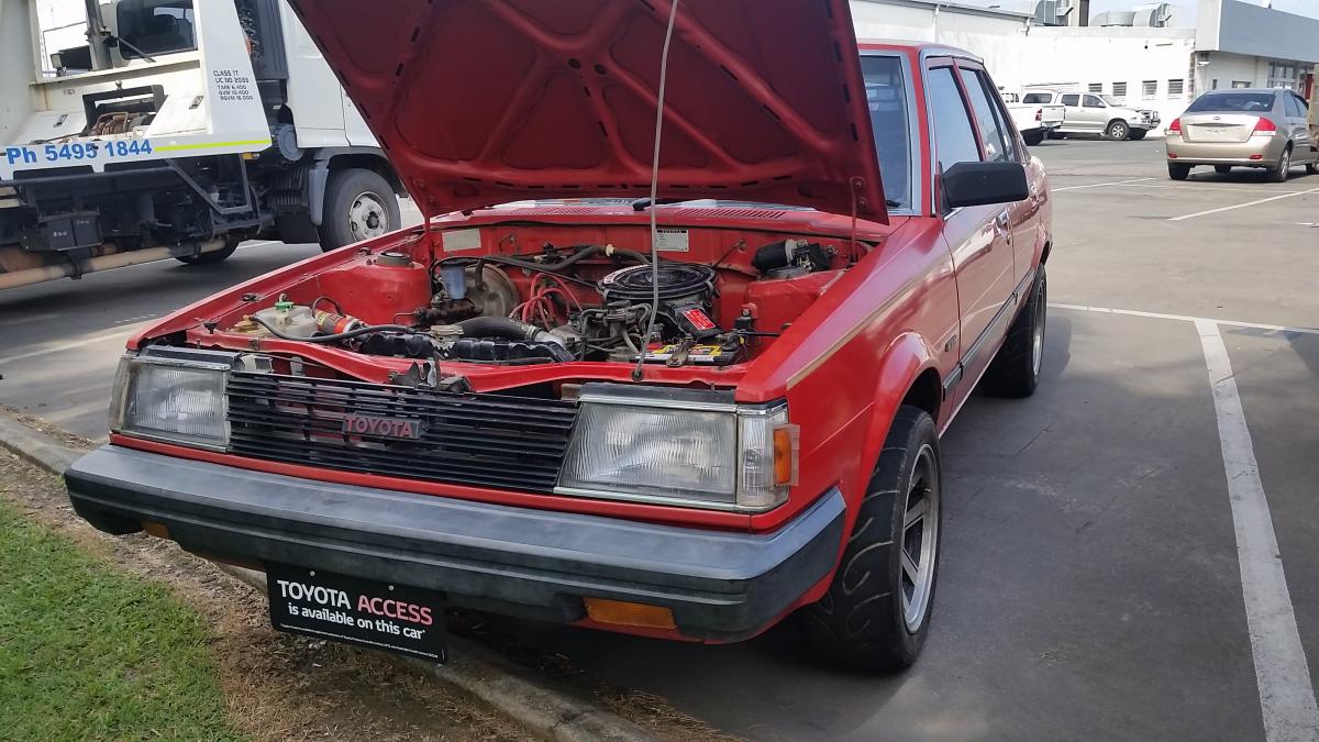

  6. Getting a few over heating issues at the current point in time. Replaced the thermostat with no luck. Next I am flushing the system by taking out the thermostat and putting a fire hose down the neck into the block. This is to hopefully pick up the gunk on the bottom of the radiator and flush it through the top. Fingers crossed it works will update over the weekend. 3 weeks till Matsuri :P
  7. Update Been a while but I have sorted out the rear brakes now. Bought myself a welder and plan on fixing the rust sooner rather than later. Car is looking great. Hopefully it will be ready for a trip to matsuri !
