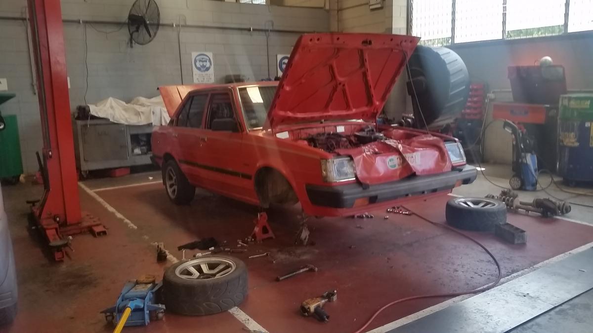

  10. Took out the piston and gave it a bit of a clean up. Couldn't see any pits in it so greased it a bit and popped it back in. The rubber seal was broken but had a quoted price to get the rebuild kit of $75 for the pair of fronts. Put it all back in working just fine! Started replacing the rear wheel cylinders. Had to rush away so the work stopped for the day.
  11. So update. Took it for a drive today... Wasn't the best. When I fitted the RHF caliper the piston was seized and became worse over the drive. Ended up locking onto the rotor and slowing my car down! Engine working overtime started to overheat. Raced back to the workshop. Time to replace or rebuild calipers...

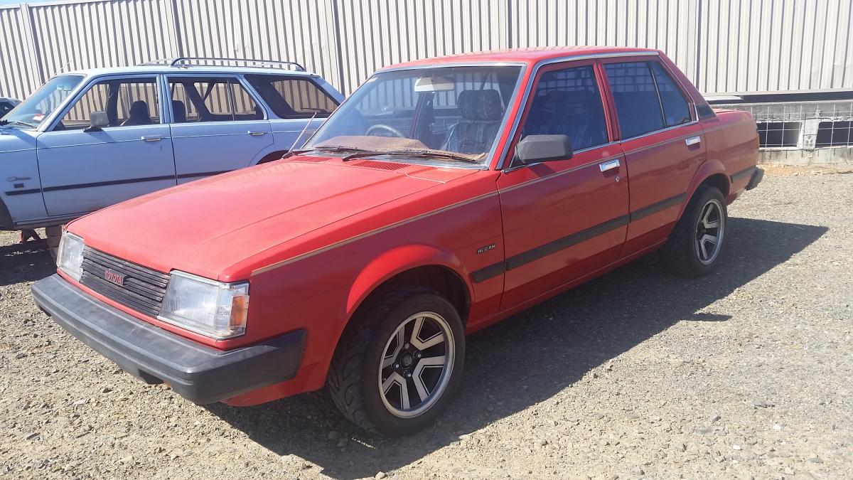

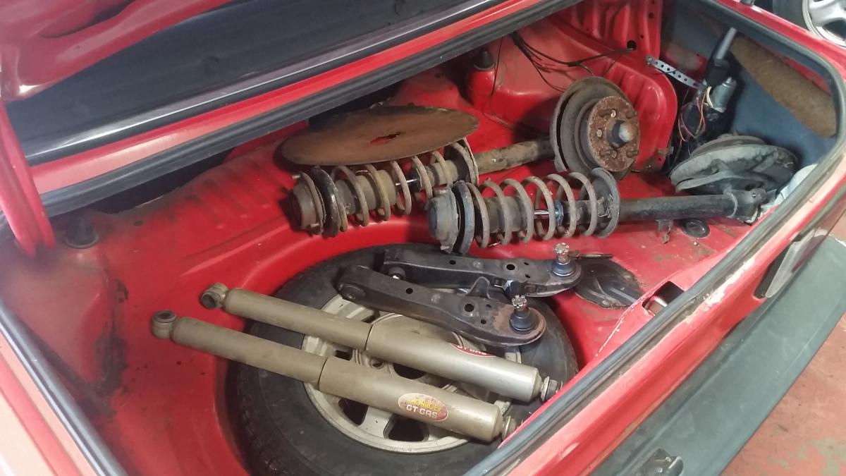

  12. Fitted the struts last night! sitting sweet. Right hand caliper was a little seized so I might rebuild them in the future with new pistons... or go AE86 Front struts. Sent it off to get a wheel alignment 20min ago so that everything is perfect after installing extended LCA's. Pictures of the camber will be up soon.
  13. Mad. Cheers Duffman!
  14. 84 struts are the ones originally from the car. both are ke70's. Definitely didn't know that there was 3 different strut tops thou. And no they are on the right side.
  15. Forgot to post a starting photo haha
  16. First time in the workshop. I am a proud father haha

    Got started working on the KE on the Saturday just been. Took out the struts and LCA's all well and good. Put in the xt130 LCA and adjust the caster arm to match. Problem is I couldn't undo the tie rod end. So work stopped. My mechanic helped me and showed me a trick to release the end and it worked! So Monday after work I fitted the other LCA and all was good until I put the struts in. Never new there was a 5mm difference in the strut tops between the 82 model and the 84. So now I have to change over the ops just when I thought all was good haha.

    Only thing changed since i bought it are the rims.
