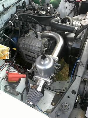

  21. Here is a photo of the setup as it stands

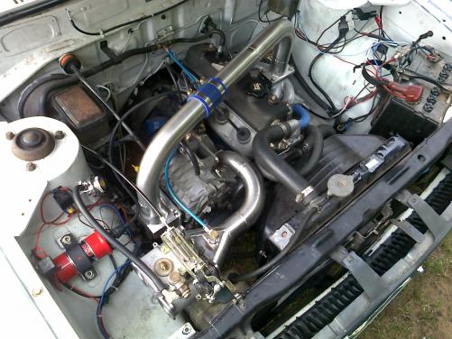

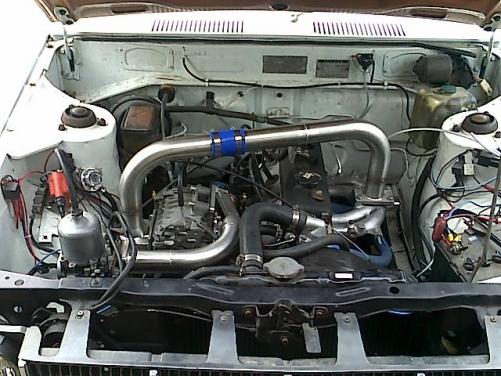

  22. i should say that was the setup until a couple of weeks ago... i couldnt get the SU to work the way i wanted it to so i change it to a 40 dcoe weber so i could tune it better. i will get some photos up soon. the car is booked in to the carby place in a couple of weeks to get a proper tune because it feels like the car is running out of fuel. i can only get it to rev to around 4000rpm before is starts to hate life, so its going on the dyno to be tuned properly

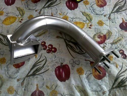

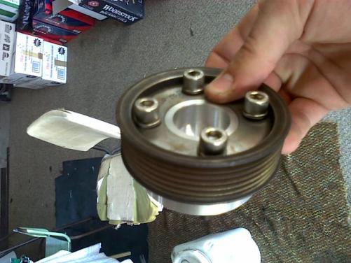

  23. After a really long time between updates i thought i should tell you what i have been doing the wags. I got bored of the N/A setup in the car so i decided to have a go at supercharging the beast. Got myself an sc12 from another member on rollaclub and borrowed some supercharger brackets to suit an sc14 on a 4k just ot get some idea of how to mount it up. Well those brackets that i borrowed were shit to say the least, very backyarder spec, didnt line up with the holes very well. Now i should explain that I'm a fitter and turner by trade and i work with stainless steel all day so i have a bit of experince tig welding the stuff. I'm using a v6 commodore idler pulley modified to bolt on the front of the crank pulley with an alluminum spacer, i used this to get the ribbed belt pulley to suit the clutch on the supercharger. here are some photos of the setup so far....

  25. um, i have the weber, rebuilt it the other day, going in to work tommorow to make up new pipework/plenum to take the dcoe in place of the su. been a bit busy traveling with work so havent had much time to play. ill post up some pics when I'm done
