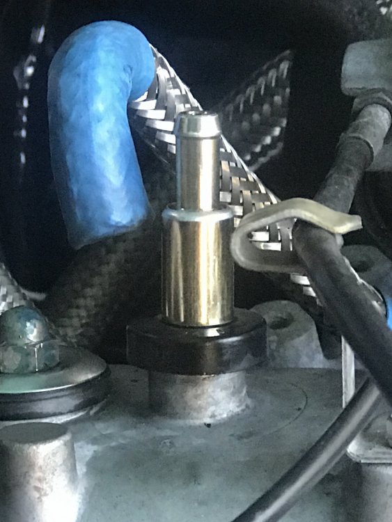

  8. Hello. I've recently replaced my Pcv valve and wondering which way to goes. I bought a fuelmister branded one and there is a short side and a longer side.
