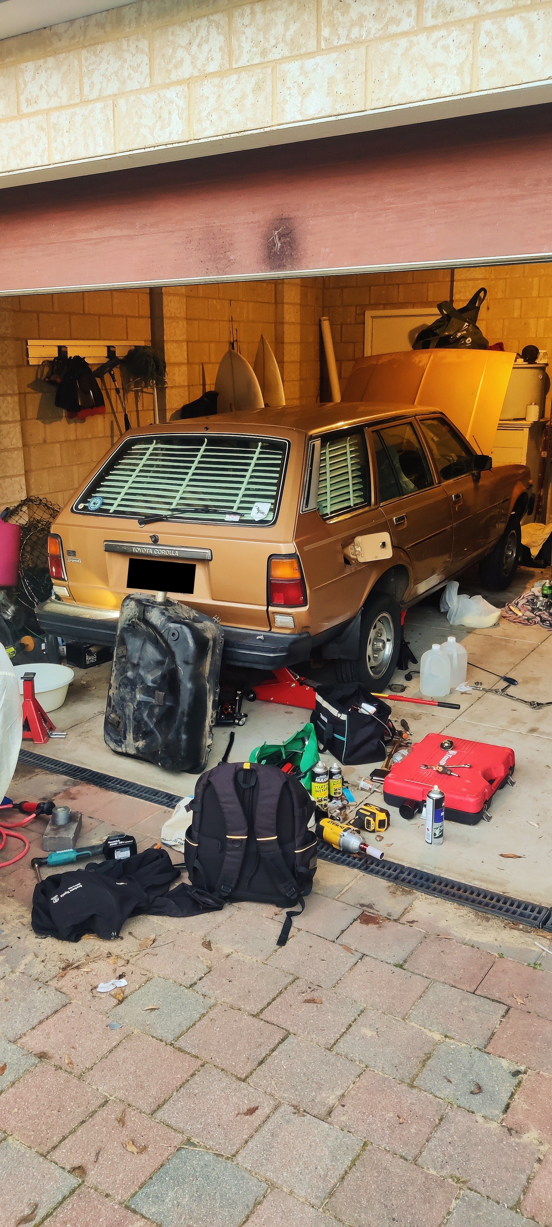

  6. KNIBBZY KE70 WAGON BUILD So I have decided to make a build thread for my KE70 wagon, it is going to be a long process but I thought having a space to post updates would be nice. I will try and post YouTube videos of the build on my channel as well if anyone is interested.

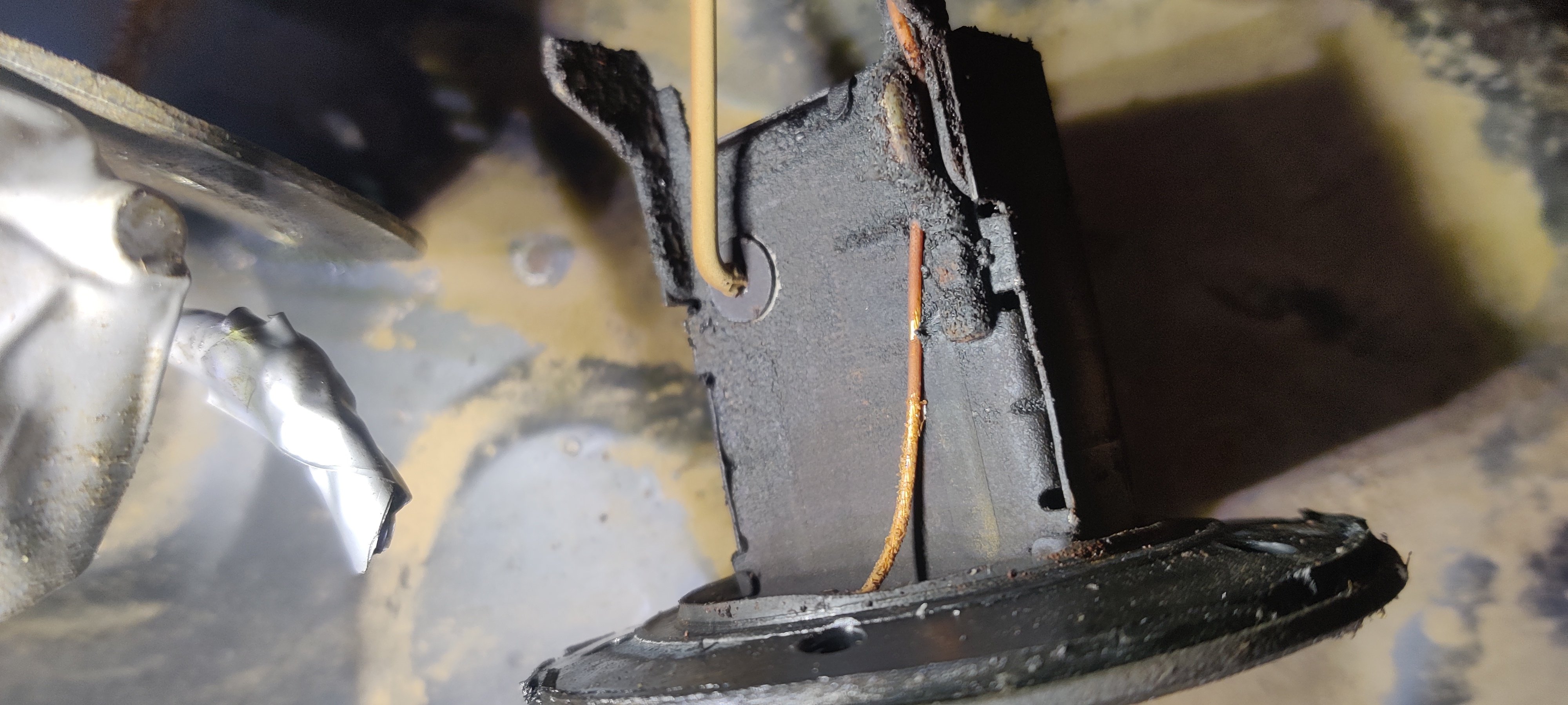

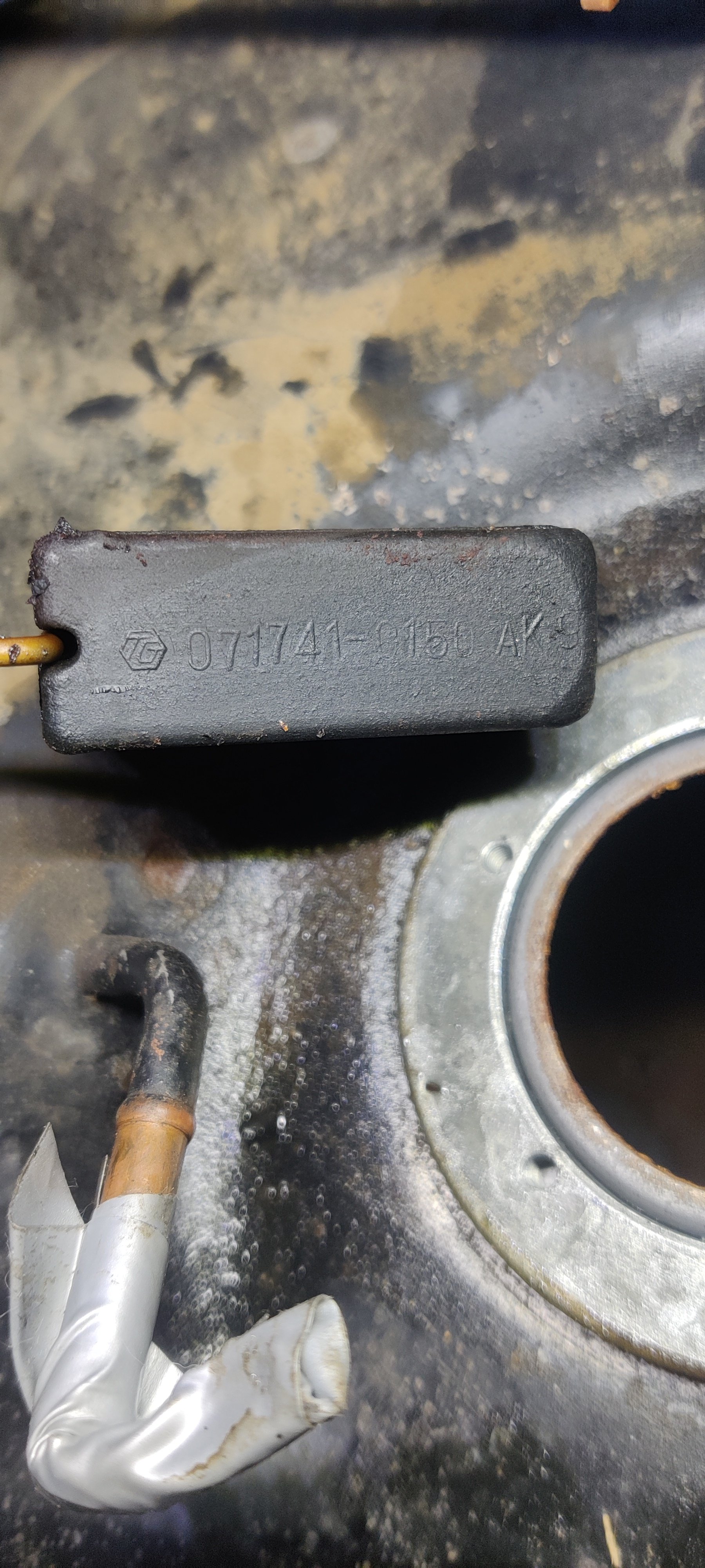

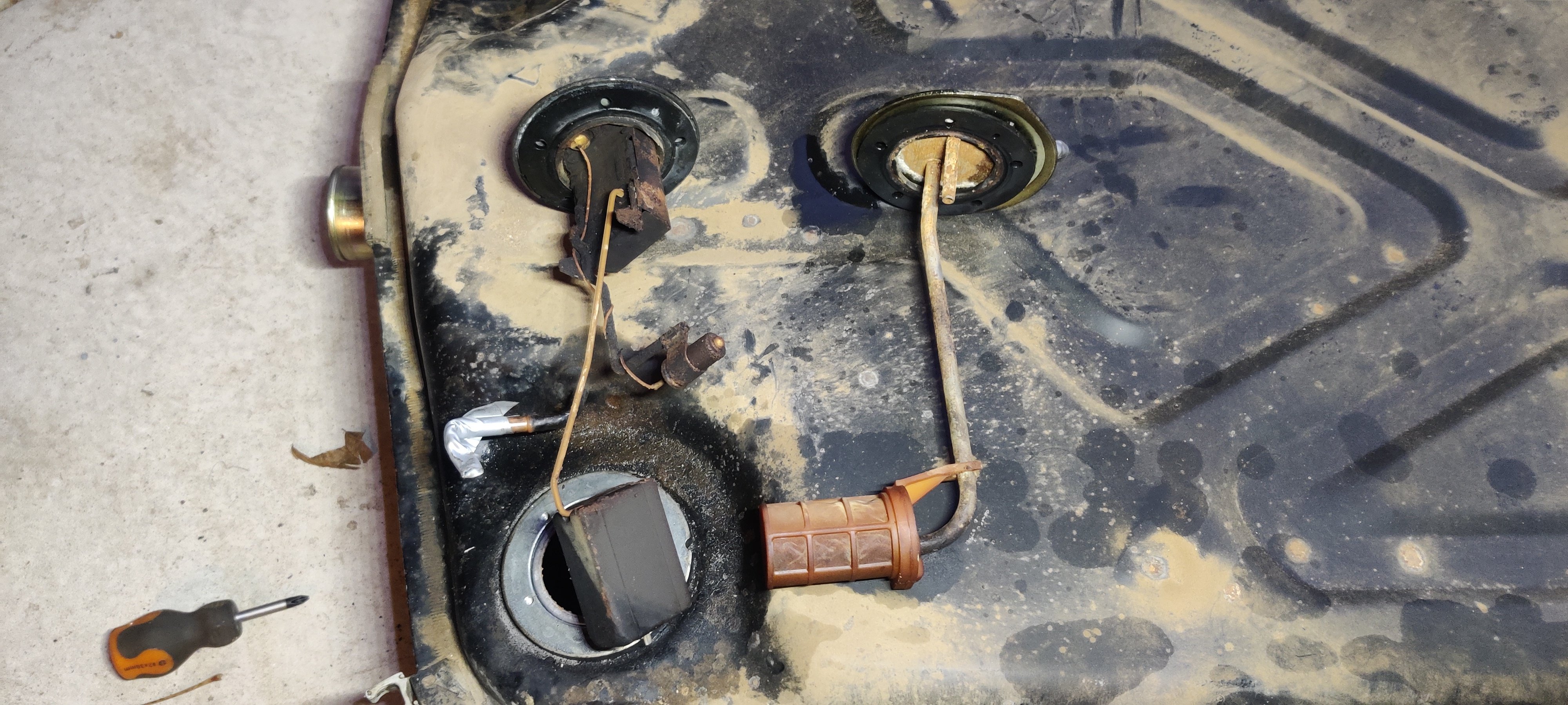

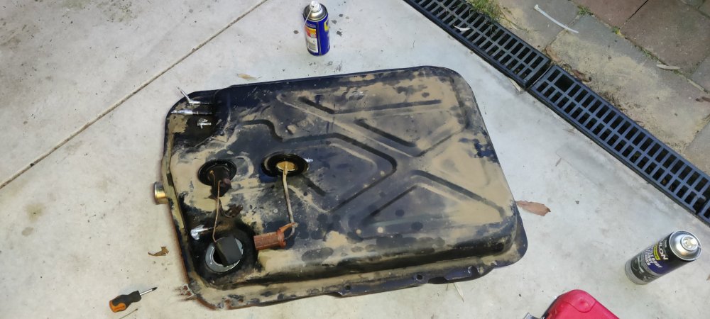

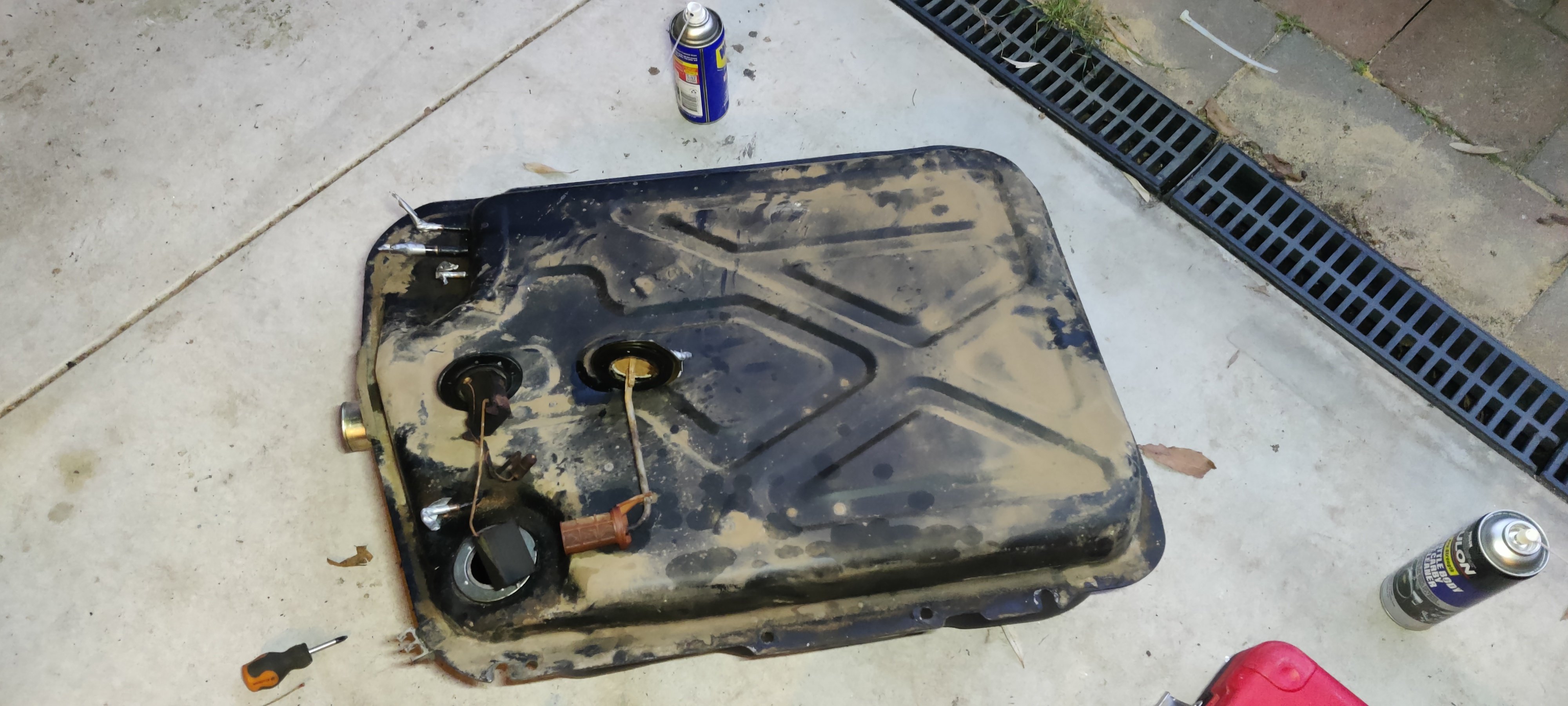

  7. So guys I finally got around to dropping my tank and yeah its pretty bad, probably the main cause of my ke70 not running/stalling out/shutting off on me. No wonder I was having running issues related to fuel, and carby. This is my fuel sending unit, does anyone know where I can get a wagon specific fuel sending unit or could I use a KE70 Sedan one. Here is the part number of the KE70 Wagon Fuel Sending Unit Also my fuel tank has a intank fuel cap flapper door made out of plastic, its like on a hinge near the filler neck and there is also a plastic tube surround on one of the fuel lines inside the tank, can you remove those or are they not removable, as I am getting my tank cleaned, rust treated and lined with red kote, but if I cannot get these two things removed in the fuel tank, I may not be able to re line my tank, unless I get them to cut open the tank and see if they can remove it and get them to reweld tank but that is going to cost more money if thats the case i reckon.

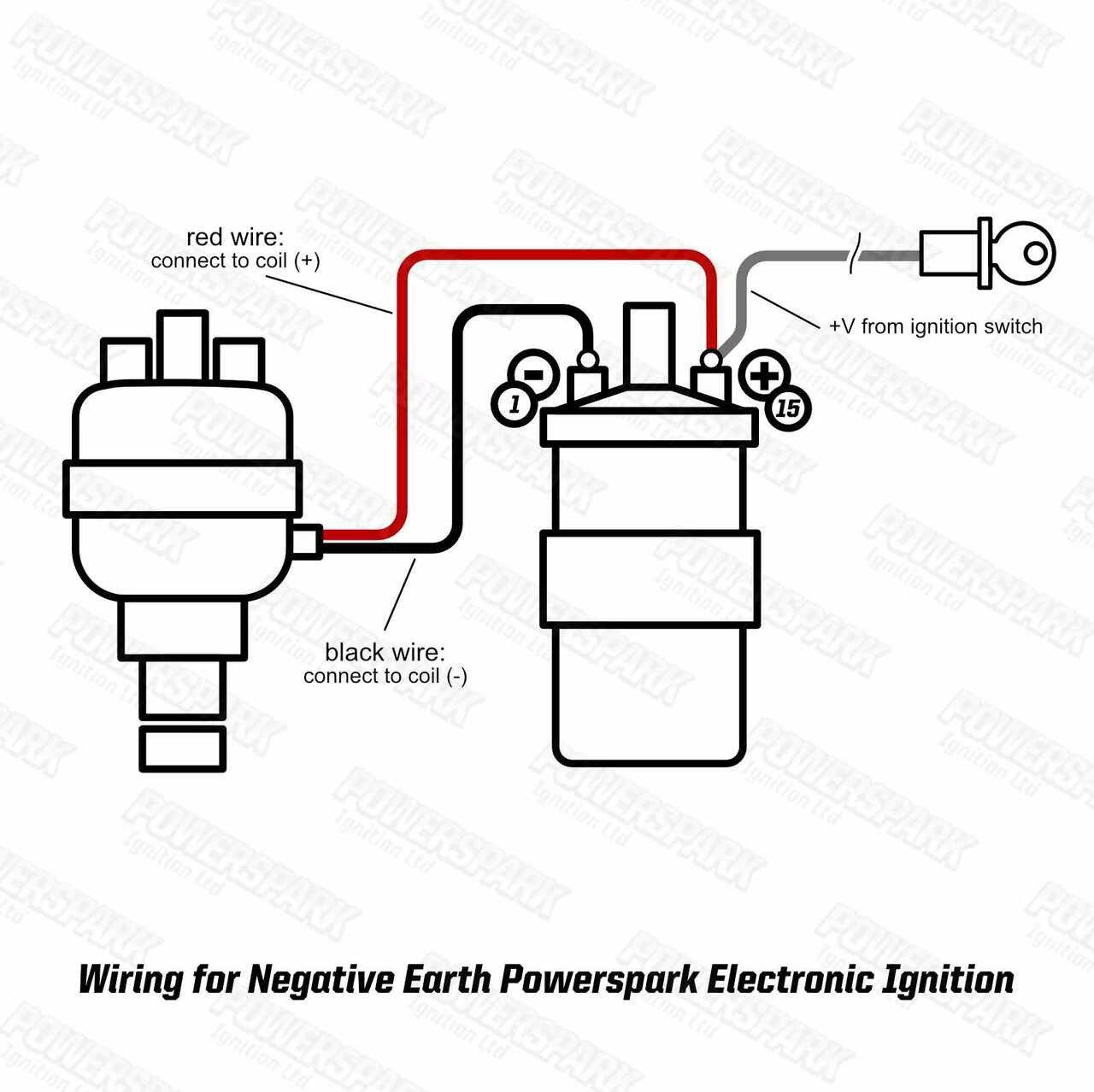

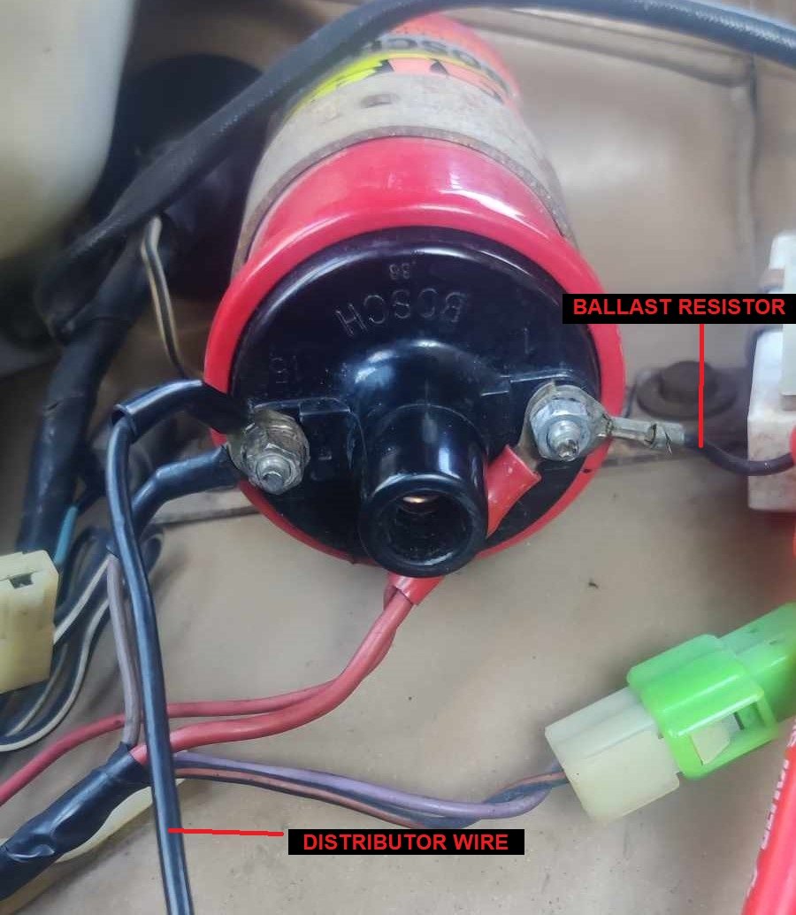

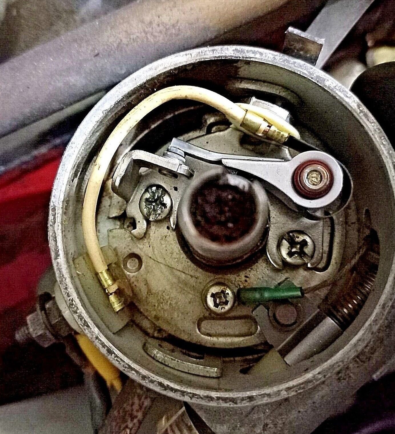

  8. Well I think I found the root of my problem being the coil being the wrong way and having the wires connected incorrectly, I will have to try to install the electronic ignition module next weekend, when I have some more time I will keep you posted.
  9. Guess what I think you are right altezzaclub, I span the coil around so +ve is now on the right side and -ve is on the left side, cranked my car up and she fired so I had my wires on the coil wrong and I checked my old Lucas coil and +ve was on the right and -ve on the left I must of not realized that the Bosch GT40R had different positioning or I wanted to have the logo facing up and maybe forgot to switch the wires in the correct wiring , I am an absolute donkey, maybe now when I go back to reinstall my electronic module kit it will actually fire the engine this time.

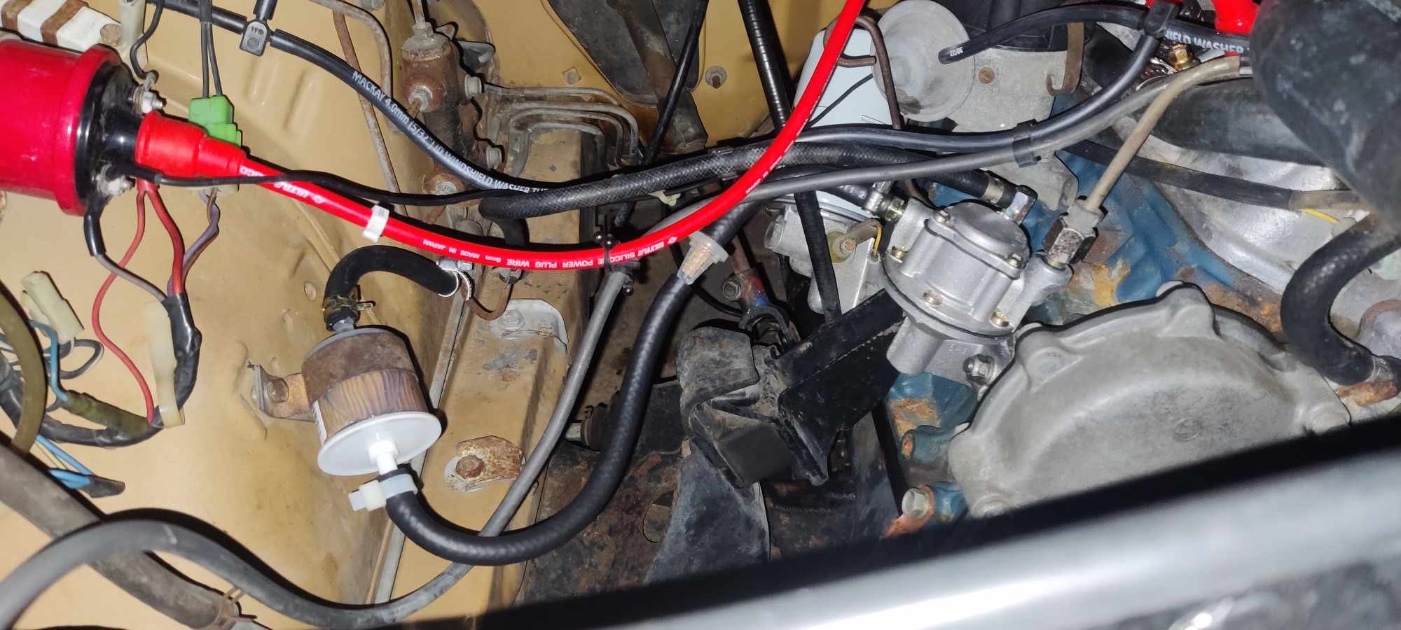

  10. Hey Guys this is how I have my ignition coil setup, but now by looking at the diagram I feel like my wiring is wrong on the ignition coil, but the car still starts, drives, and runs fine. As you can see the red wires (not sure what they are can someone let me know) are connected to -ve should that not be connected to +ve, also my distributor wire that connects from the outside of the dizzy which is connected to the contact point and condenser is connected to +ve should that not be connected to -ve, I do not know what the brown wire is but that is connected to +ve.

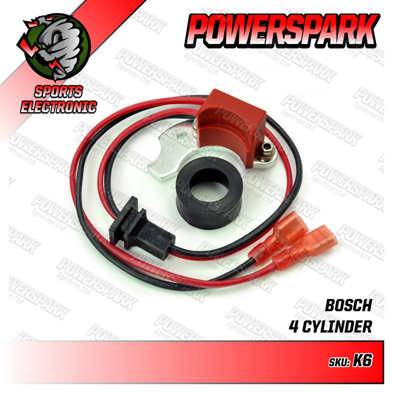

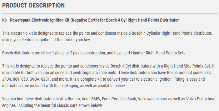

  11. Okay guys I tried to install the PowerSpark Electronic Ignition kit and the engine did not want to crank over. This kit may not be compatible with my type of Bosch distributor, unless I have missed a important step. I recorded myself trying to install the kit so if anyone has any idea of what I did wrong or insight into what the problem might be feel free to let me know.
  12. Hey Guys just and update, I was able to find a Electronic Ignition Kit for the Bosch Style Distributors, I just hope its compatiable as I do not know the part number for the old bosch style distributors but by looking at the point type and the description stating the kit is used for bosch 1 hand piece points distributor it should work fine.

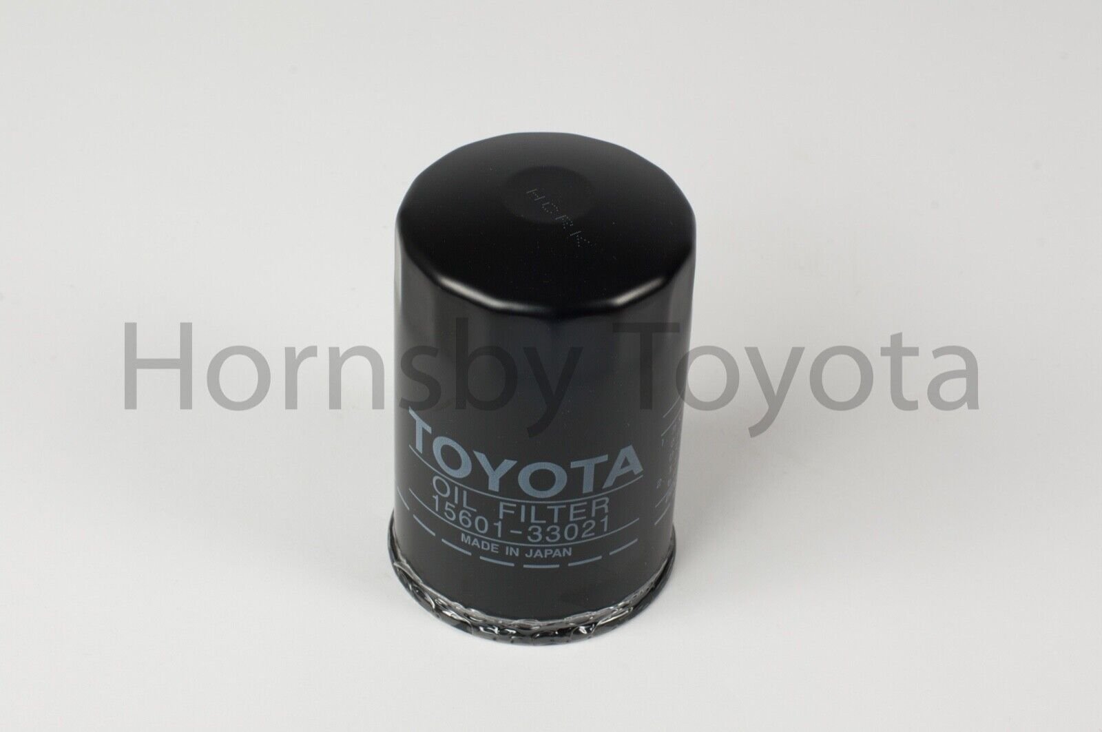

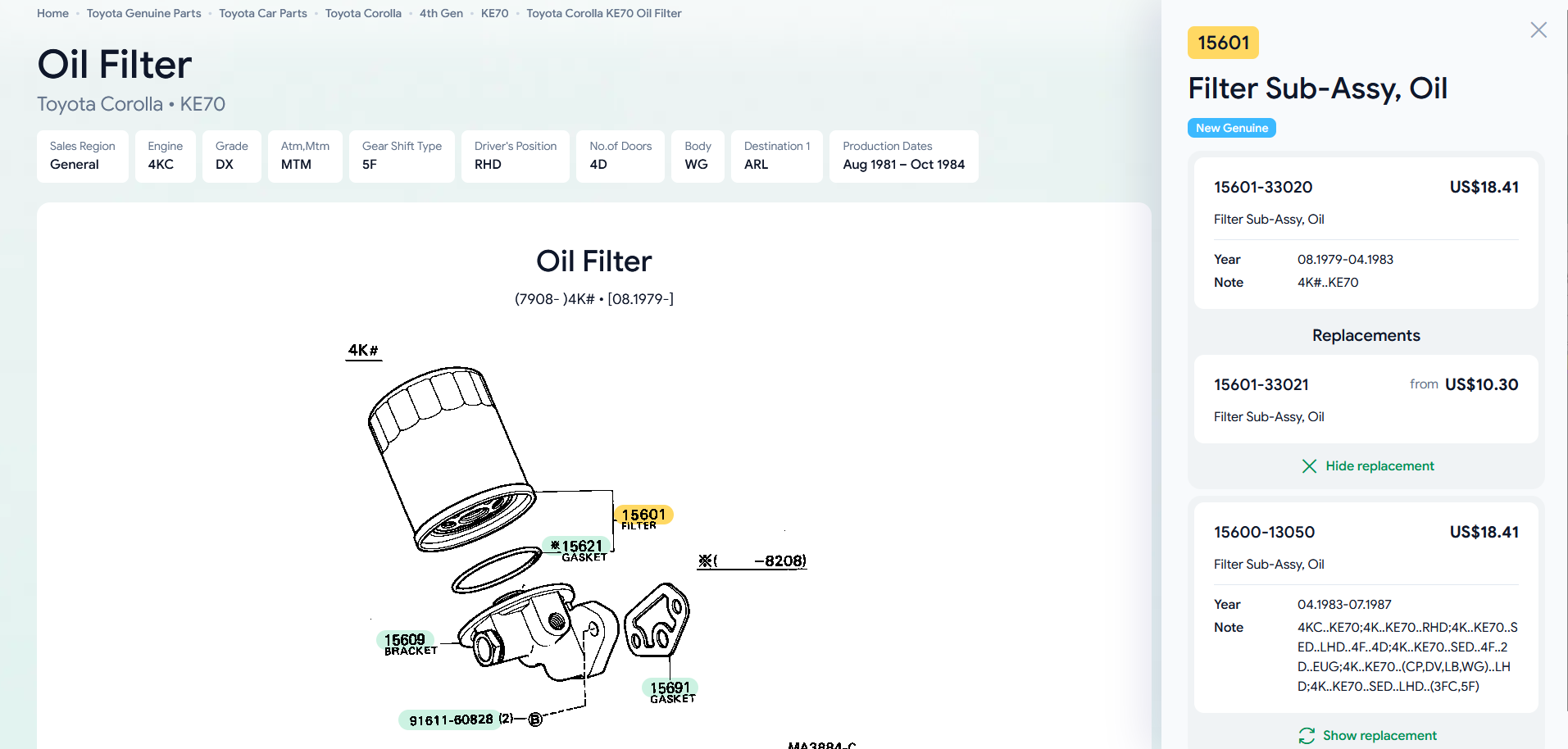

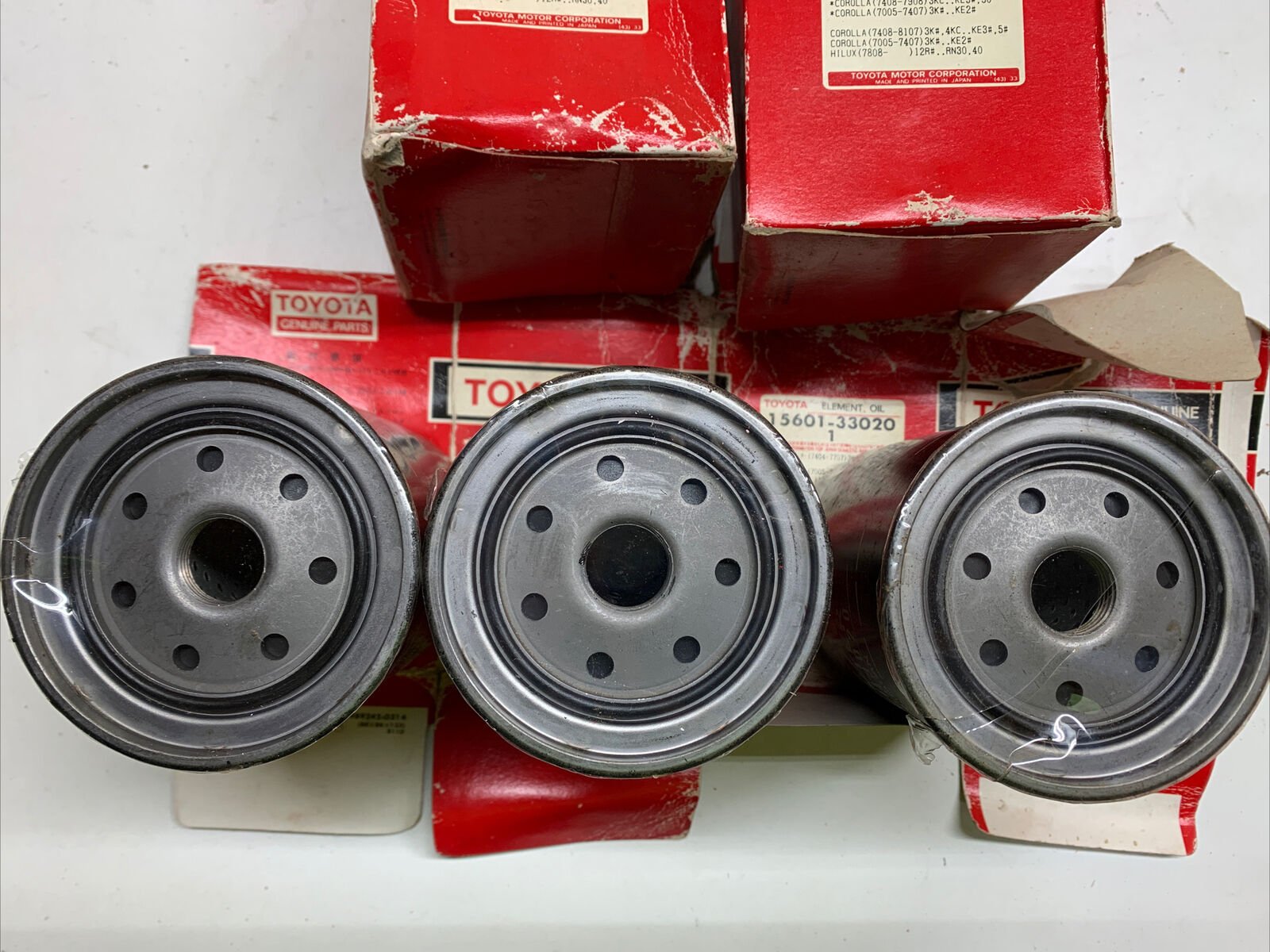

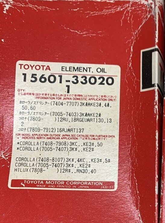

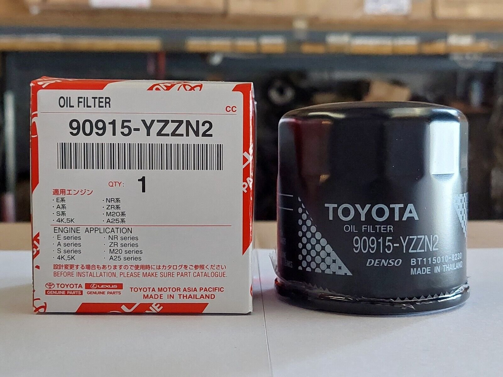

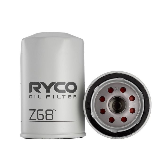

  13. WHAT IS THE CORRECT OIL FILTER CAN THERE BE SLIGHT VARIATIONS BUT ALL WORK ON THE KE70 We all know we can use the RYCO Z68 Oil Filter on the KE70 By looking at my parts diagram on Yoshi Parts this is what I found. As you can see the vehicle details are almost correct and correspond to my vehicle specifications with the only difference being the Grade of the wagon which is says DX and mine is a CS Grade. As you can see it states the old part number of the Toyota Genuine Filter you were able to purchase which is 15601-33020 I was able to find photos of the old filter. On the box it states its can be used for a 4KC engine And now here is the New Toyota Genuine Replacement Filter as mentioned on the Diagram 15601-33021 Now to throw a curve ball the genuine filters look the same size as the RYCO Z68 so its safe to assume that these genuine Filters are usable on the 4KC engines, when we do an oil and filter replacement we change the filter and put 3.5L of oil in. Here is the curve ball. The 90915-YZZN2 TOYOTA GENUINE OIL FILTER this filer can also be used for the 4K engine but is half the size of the recommended 15601-33021 TOYOTA GENUINE FILTER So is the smaller oil filter usable for the 4K engines, and what do you reckon the differences will be on the engine side, the bigger filter means you use more oil to fill the filter, but with these small filters you would not need as much oil to fill the filter up, how would it affect your engine.

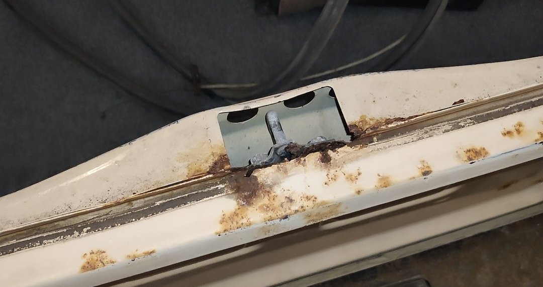

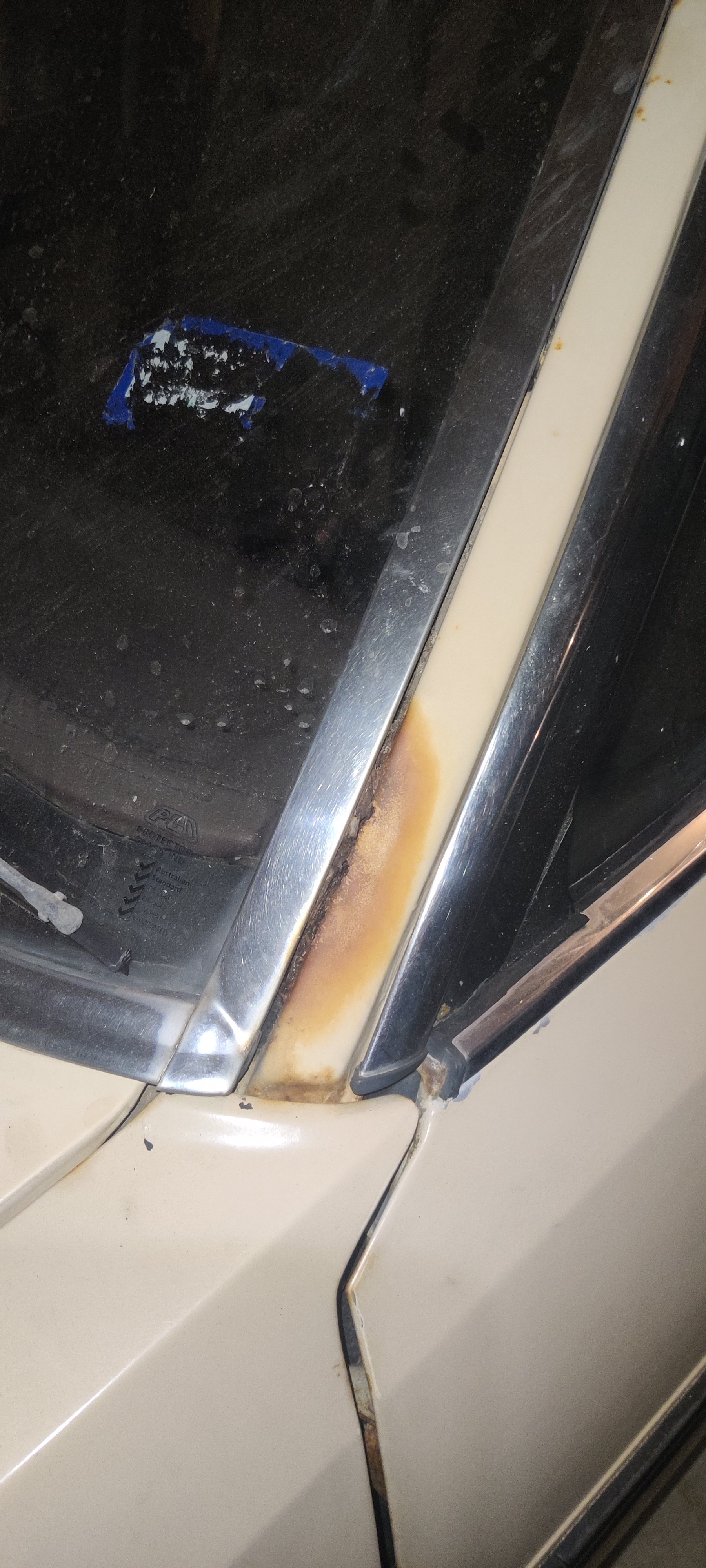

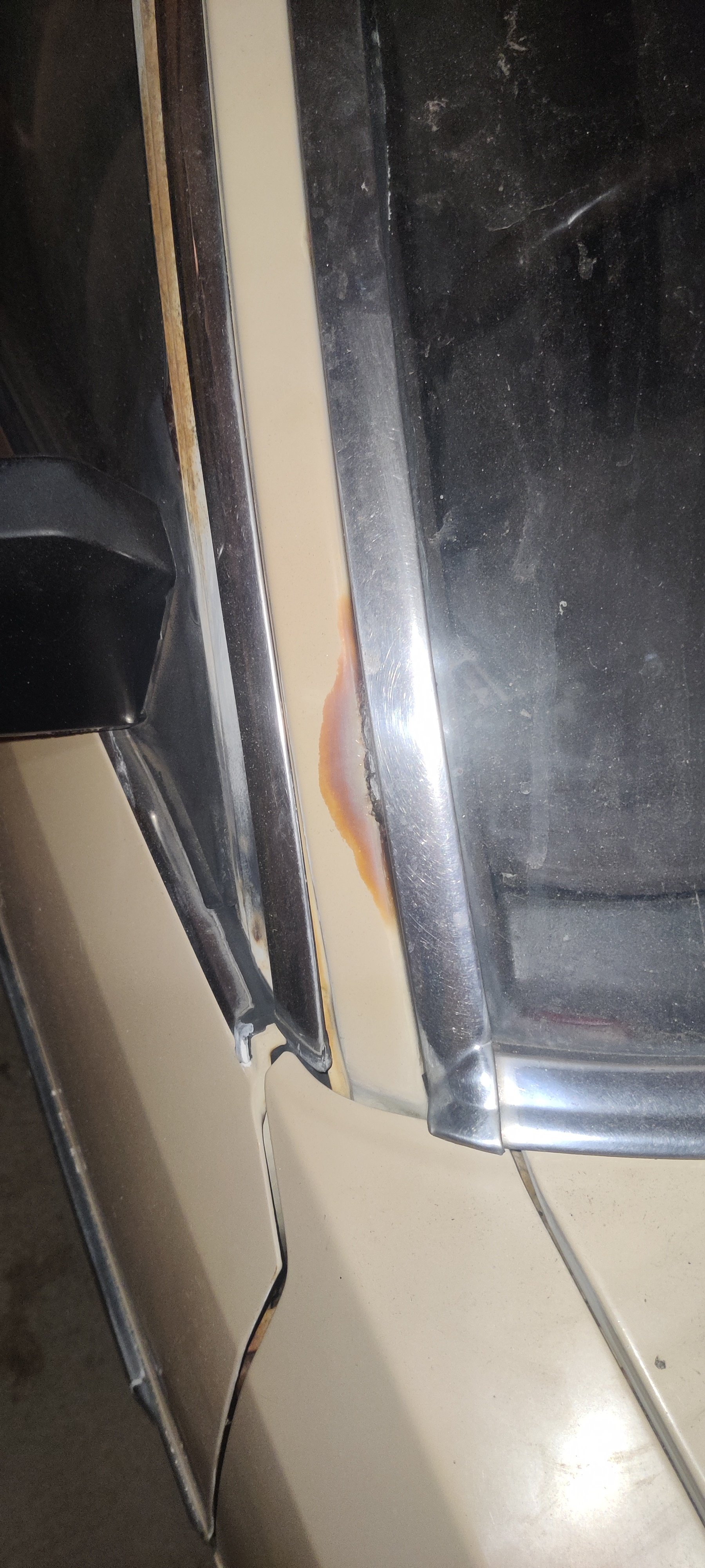

  14. Yeah I really should keep some duck tape in the car, yeah the wagon also has some surface rust on the roof too, and abit on the rear window around the seal which I need to repair soonish before it gets bad, the sedan is pretty good no structual rust but mainly around the front windscreen and on the pillars and the boot seal other than that pretty mint. I was meant to spray can the rest of the car but after getting the wagon I got slack. And now for the rusteezzzz Thats about all the major rust then, its just light surface rust on other parts of the car were I have sanded and grinded it back, and sprayed the primer to stop it from spreading.

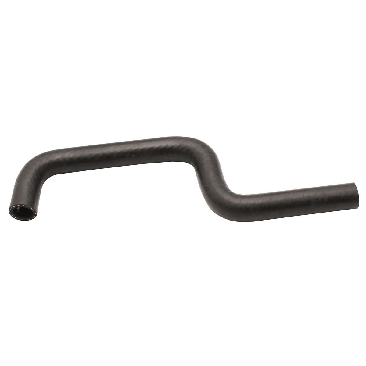

  15. So guys after endless struggles to get the old girl running smoothly, and bursting my heater hose on the way home from work, its safe to say she is running MINT!!!!. So with the second hand AISAN carby I bought of the bloke still having idling issues, I was using that to get me to work as I had no car, sadly on the way home one afternoon, my heater hose decides to split, pissing coolant all in my engine bay I was 5 minutes until I reach home, I risk driving it home, as I had no money for a tow truck, temp was fluctuating between 50% and 70% of the guage, I know I was loosing coolant, but still had enough. I finally got home opened my thermostat housing and started and got my garden hose with a garden fitting that allows me to shoot a strong straight jet stream of water 4 psi, stuck it into the housing and just ran the water for a good 10 minutes to cool the block, it was hot sprayed the engine and it was steaming, After I cooled the engine down filled the radiator up with the leftover Toyota Red Coolant I had and sat in my drive way until I could find a hose for my heater. Measured the old hose and had a ID of 18mm, check online hoses either came in 16mm or 19mm, I did not want to risk running a hose to small or too big, so after searching for 3 days I came accross a VL heater hose which had a ID of 18mm also "Heater Pipe Front VL RB30 6cyl - CH1964" that I cut that pretty much matched perfectly to the old heater hose. On the weekend I installed the new heater hose and topped up my coolant, and she was running again. Once I done the coolant I though I mise well check my idle speed and vacuum. Idle was running at 950rpm and vacuum was reading in the green. The carby started to give me headaches again, I drove it Thursday to work and it was not responsive at all, then I watched some videos, and found out I read my vacuum gauge wrong, instead of being in the green it had to be at highest vacuum which is usually 21 on the guage on the stock 4KC carby, mine was reading at 19.5 and running too rich. I didnt drive the car to work and caught transperth to get to work, on the Saturday. I rechecked everything I replaced every single old vacuum hoses with new hose, I could not get the car to idle below 800rpm so to fix this with the dash pot I removed the spring that gives tension for the screw this allowed me to get the idle down to 750rpm I believe something is not creating vacuum or the dash pot is buggered it does retract when I attach a hose and suck so maybe its not pulling vacuum but honestly I don't know so the best option was for me to take the spring and just wind it down lower to idle the rpms lower. By removing the spring it allowed me to get the oem spec idle of 750rpm. I then turned the idle speed screw in where it would just touch the backing. and from there. I plugged in my vacuum gauge. What I did was take out the bolt in the manifold and bought a barb fitting that fitted in to run the vacuum gauge off this point so that all my emissions lines and air box could still be attached which I think is the best possible way to get the best vacuum reading. Then while using a tachometer, and vacuum gauge, I turned my mixture screw all the way in clockwise, then turned 1 and a half turns outward so anti clockwise and that was my base, I started the car up and let the engine get to operating temp, then I slowly leaned the mixture out until I found the highest vacuum on the vacuum gauge, which is where I got it to 21 the highest vacuum I could achieve. Now with the carby tuned, time to clean the sucker. I really thought that I needed to rebuild the original carby and or even the second carby I bought as I do suspect my fuel tank is slightly rusted out, but for the time being I went ahead and used carby cleaner, with the engine warm I turned the car off and sprayed around the carby and inside the carby I opened up the throttle linkage to full throttle and gave a good spray and let it soak for a good 10 minutes to release any carbon build up in the manifold and around the butterflys. I turned the car on and let the engine warm up again, and this time while running using the throttle linkage gave it revs in bursts everytime I would burst the revs I would spray the carby cleaner to let the carby suck in the carby cleaner and hopefully clean the jets and anything else that may have been blocked inside the carby body. One last thing I decided to do is run a secondary fuel filter just before mechanical fuel pump so if any fine rust particles get picked up in the main fuel filter the secondary fuel filter will filter out those fine rust particles or dirt, I picked up a generic wesfil inline fuel filter form Autobarn for like $6. Photo of main line to Mechanical Fuel Pump. So after doing all these things to the car, safe to say the car is running MINT!!!!, now I just have to see if the car will cold start tomorrow on a 12 degree morning. I hope this long post helps someone in the future that may be having similar problems to me because man it can be a struggle but once you fix things its such a good feeling and feel proud of what you have achieved, the fuel tank will be dropped in the future as well as this time though I need to move my sedan out of the garage and find a place to store it. If you want to follow my KE70 Instagram Page, IG:knibusu and I do have a YouTube Channel - KNIBBZY

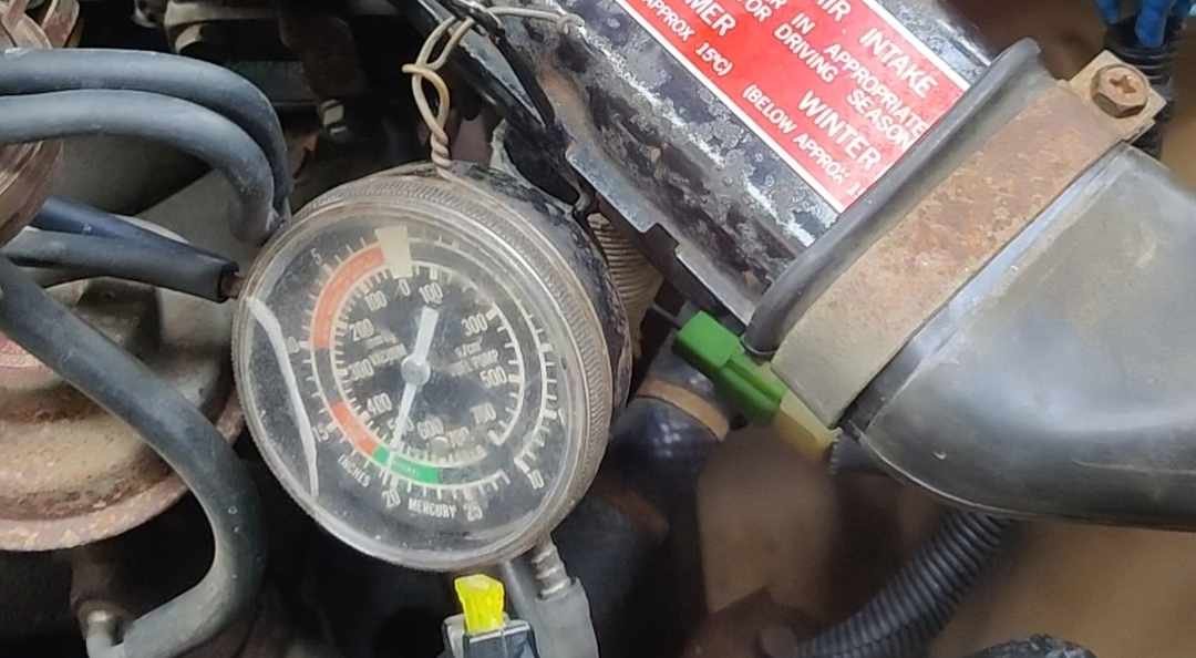

  16. Vacuum Piping (8212-8410)4KC..MTM..4D..ARL • [12.1982-10.1984] ------------------------------------------------------------------------------------------------------------------------------------------------------------ Hey Guys I was able to find the exact diagram for my KE70 Wagon so if anyone else needs the vacuum diagram here it is my KE70 is a "1983 Toyota Corolla KE70 CS Wagon 5 Speed Manual 4KC Late Model"

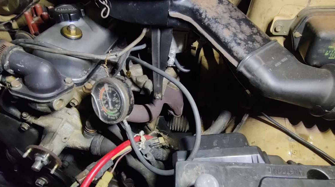

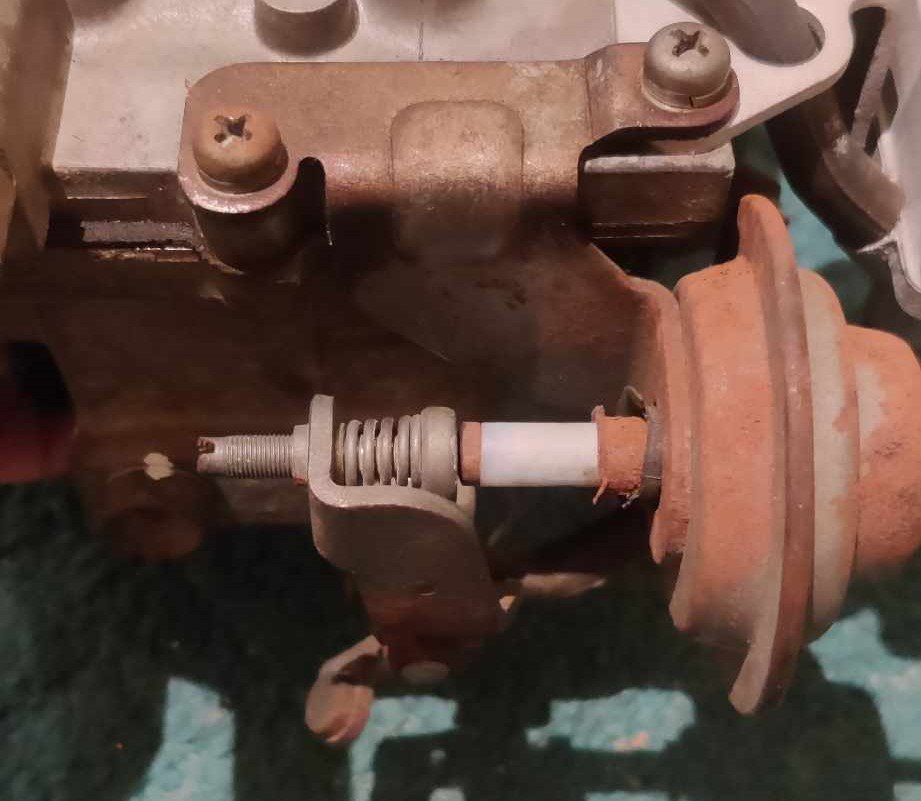

  17. Hello Guys Does anyone have a picture of the vacuum lines running to the right side of the carby on the side of the air/fuel mixture screw, I was playing around with my vacuum gauge tester on the weekend trying to get the highest vaucum, and I think I plugged the tri-connector lines the wrong way, if someone can take a quick snap for me of the vacuum lines I would appreciate it so much. I should of taking a photo beforehand that was my mistake.

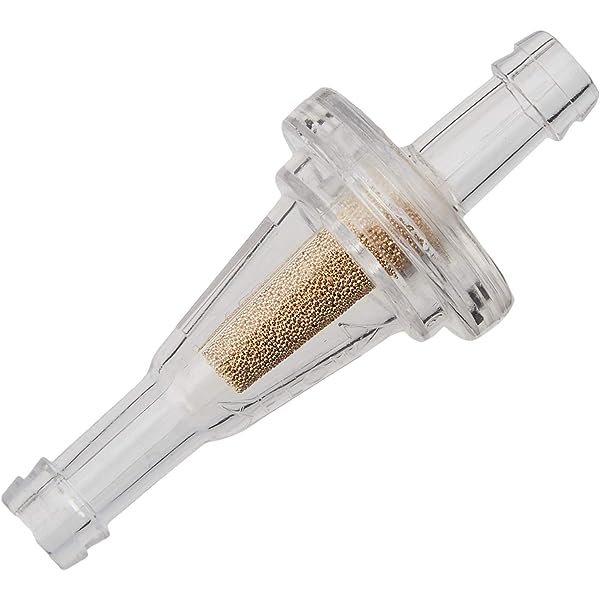

  20. Well guys after dickering around over the weekend I just finally got the fuel supply issue somewhat semi fixed, so I replaced the engine bay fuel lines with 1/4th fuel hose, about 6.3mm, I tried to crank engine but still wasnt filling fuel filter up with fuel, so I took the fuel pump off the engine block and pumped it manually with the fuel lines attached to mechanical pump and I was able to fill the fuel filter up with fuel. I cleaned the carburetor with carby cleaner. I then primed the carby and was able to get it running with my foot holding the accelerator, but when I would let go the car would stall, took me ages to play around with carby and accelerator cable, so my ke accelerator cable had a bit of slack in the line I had to adjust it to the point where the back nut is all the way at the end of the accelerator mount so there is no slack in the accelerator line,then I put the idle at about 1200rpm which I have to do to activate the secondary jet otherwise it wont Idle I do not really know as I do not have a tachometer, but whats happening is I believe my idle jet or the middle jet that supplies fuel to carby when idling is blocked and not supplying fuel, I remedied for the time being by raising the rpm as stated above which is allowing me to use the secondary accelerator jet, this is the only way I can get it running for the time being, but with that my fuel economy will be really bad as the secondary jet is squirting fuel all the time. When I try to set it to low idle it does not want to idle as it can not spray from the middle jet. I am either gonna have to rebuild the carby or see if it fixes itself overtime. But yeah as soon as I adjust the idle screw to a lower rpm, the car starts to bog down and struggles to run. I am also still having a slight issue where when at traffic lights coming to complete stop the car sometimes struggles to idle and die, maybe because the engine is too hot and is turning the fuel from mechanical fuel pump to carby into straight vapour as the hard line is superclose to the engine.
  21. So I put the new Fuel Miser Fuel Pump and New Fuel Filter, and was able to get fuel to the carby, it was running good still had the issue where when coming to a complete stop the car would die on itself, I took it for a drive around my area, came back, let the car rest for a while and noticed it was leaking fuel from some engine bay fuel lines so I replaced those lines, went for another drive, came back and parked the car on a incline like I always do to have a check of my fuel lines are not still leaking, went to crank the car and same thing is happening as before the fuel filter is not filling up with fuel and cannot get fuel from tank to carby, I took the mechanical fuel pump off with lines still attached and pumped the lever by hand that seems to be able to pump fuel and I could see it trying to squirt from mechanical fuel pump to carby hardline with the little of left over fuel it had. Its either the tank needs a clean, the hardlines under the car need a clean, and or its something else, like when it was running it was working perfectly besides the car cutting out at low rpm and coming to complete stop it would die.
  22. Far out this issue is also happening to me there is no fuel in my fuel filter and I do not think any fuel is getting to the carby, I was able to start it with start ya bastard and only runs for like 2 seconds before it dies since no fuel is getting to the carby, I thought it was the dizzy at first, thats why I made a separate post not to long ago asking about dizzy but now I think its fuel related. Thing is my KE70 is parked on a incline hill with the engine bay facing up the incline, so maybe the mechanical fuel pump is struggling to pump fuel from the tank to carby since the incline is too steep, I also just filled up the tank and only drove 140km so there should still be plenty of fuel, unless I ran the carby to rich, but even then it should still have enough fuel in the tank, I legit put a brand new GOSS Mechanical Fuel Pump on (maybe its a shit fuel pump) I bought a Fuel Miser Mechanical Fuel Pump maybe I can try that and see if it makes a difference, I will do as you guys mentioned above check my fuel hoses and maybe even the hard line is now blocked may need to give it a clean out and or the tank has heaps of crud and rust in it, it also just got regoed so it may have been sitting for a long time, I crank and crank but no fuel is reaching to the fuel filter, so something is not working in the fuel system, Ill have a look this weekend and hopefully get it sorted, is there anything else I can do to try and get the fuel pumped through.

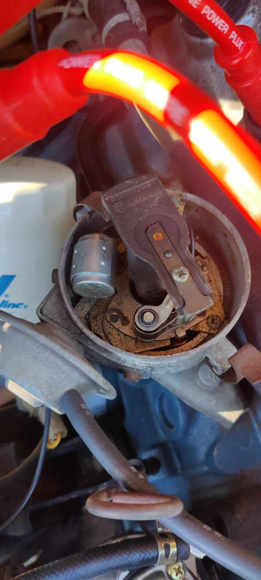

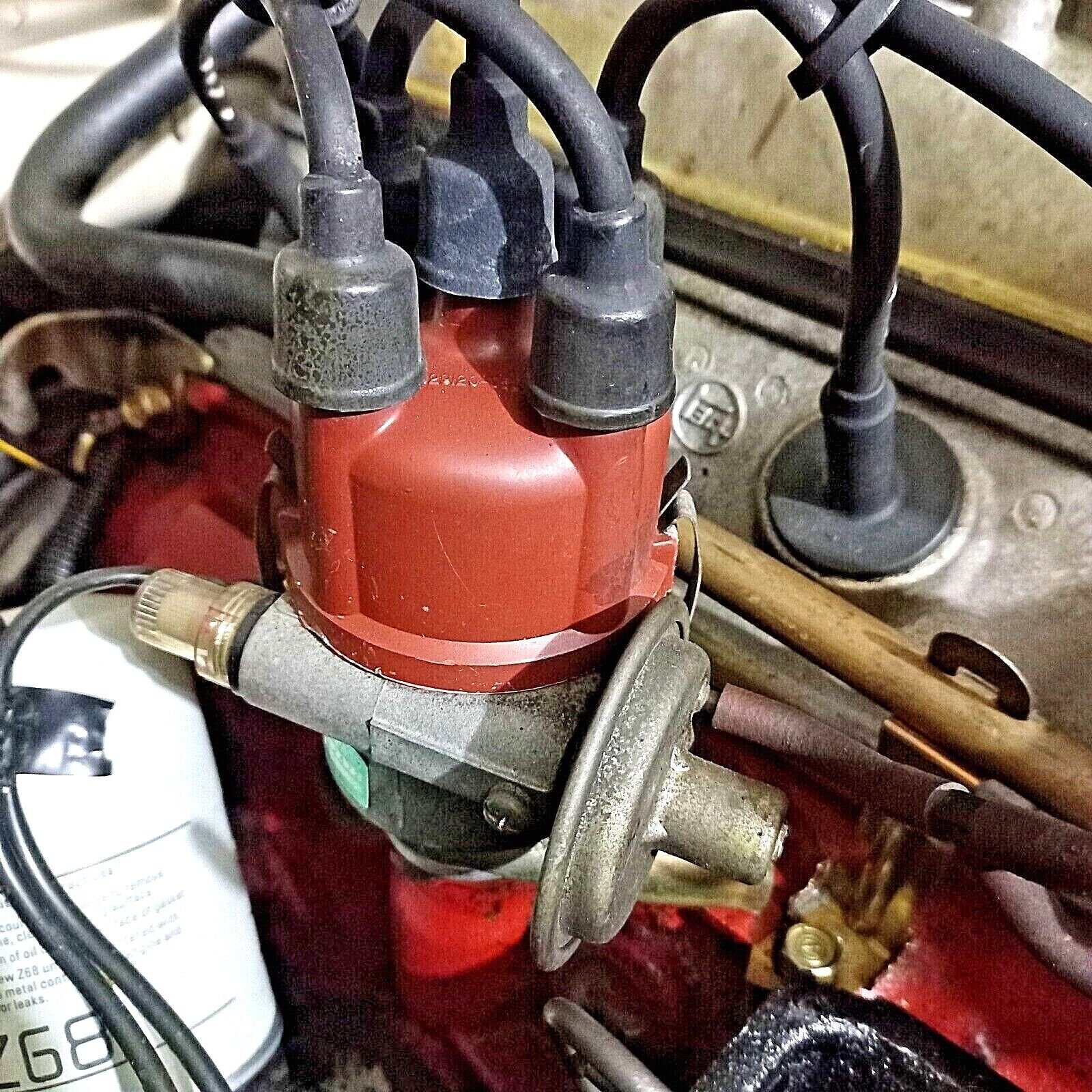

  23. My Dizzy Other Style Dizzy My Distributor that I have has the condensor built inside of the distributor itself where as the other style distributor has it mounted on the outside, I think the two differences between the distributors is some 4KC engines used either the bosch distributor or denso style distributor. I do not think the AccurSpark Kit is compatible with my Distributor in saying that would I be able to put the other style dizzy on my KE70 and run the AccuSpark Kit. Or would it be best to go straight to an electronic distributor, the only thing is those ebay electronic distributors do nott show what its like inside with the cap off so not really sure which one I purchase or will any one work fine.

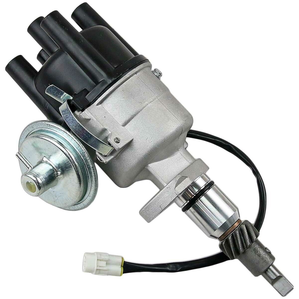

  24. Hey guys so I am wanting to upgrade my dizzy to an Electronic Distributor, I was watching Dylans video of him installing his electronic dizzy on the old "The Fellas Network" YouTube Channel: https://youtu.be/wZWCaWe2USs I was wondering those Ebay Electronic Distributors for 4K's will they work. Or do you need the OEM style Electronic Distributor Any info is appreciated.
