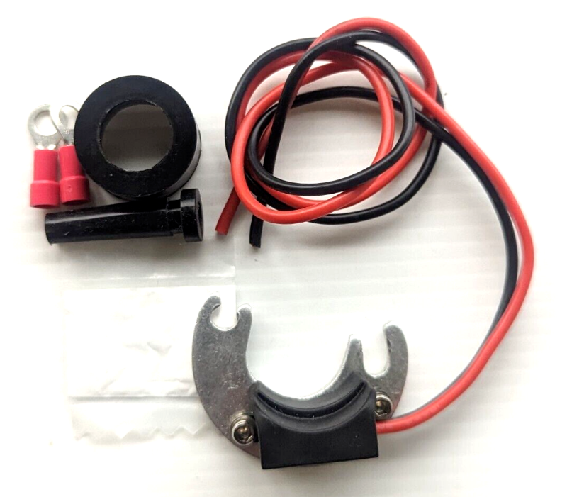

Hey Guys just and update, I was able to find a Electronic Ignition Kit for the Bosch Style Distributors, I just hope its compatiable as I do not know the part number for the old bosch style distributors but by looking at the point type and the description stating the kit is used for bosch 1 hand piece points distributor it should work fine.
powerspark-powerspark-electronic-ignition-kit-for-bosch-4-cyl-right-hand-1-piece-points-distributor-k6__49004.thumb.jpg.e2d1a39ac341bed16b1890456a49e3ea.jpg
powerspark-powerspark-electronic-ignition-kit-for-bosch-4-cyl-right-hand-1-piece-points-distributor-k6__17132.thumb.jpg.4c1612c0fe5f62dda95835efb10fc2f5.jpg
Okay guys I tried to install the PowerSpark Electronic Ignition kit and the engine did not want to crank over. This kit may not be compatible with my type of Bosch distributor, unless I have missed a important step. I recorded myself trying to install the kit so if anyone has any idea of what I did wrong or insight into what the problem might be feel free to let me know.
Well I think I found the root of my problem being the coil being the wrong way and having the wires connected incorrectly, I will have to try to install the electronic ignition module next weekend, when I have some more time I will keep you posted.
