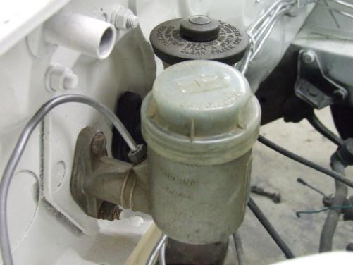

Hi mate, as far as mounts go, mine are just cut and modded standard 2t mounts. They look pretty agricultural but have done 3 seasons of racing without any probs. And for brake booster, I use a VH44 booster and a Datsun 1600 master cylinder. With the booster remotely mounted you have room to run twin side draft carbies.

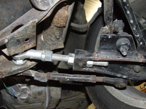

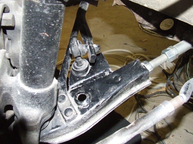

Have you machined a thread down the end of the castor rods? ..or will that interfere with the sway bar if you pull the strut forward? I suppse its no good getting too much front-end grip and having it oversteer everywhere! I diden't have to thread the caster rods because pushing out LCA's, shortens them anyway.I shortened the spacer between the rubbers to give a tighter fit and less movement. I am running 5 deg caster. As for oversteer, I LOVE oversteer. You can control oversteer with your right foot but understeer you are just a passenger.
