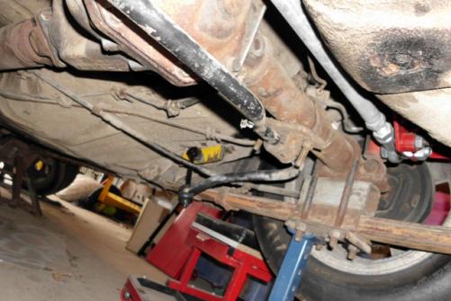

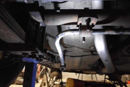

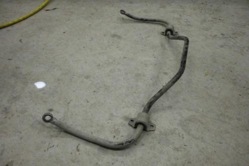

  21. Budget priced rear swaybar upgrade. Hi guys, been a bit slack latley but I have upgraded my rear sway bar. I used the rear swaybar off a VR Commodore. It was an ezy fit and not expensive. Swaybar from the wreckers $10. (They arn't in big demand so they will just about give them away). I used Nissan Patrol front swaybar links ( $38 a pair at Repco) or you could get them from the wreckers and a couple of bits of angle. The bar actualy mounts foward and with a couple of bits of plate on the inside of the floor ( under the rear seat so they are not visable from the inside) the job is done. The mountings I will add more pics soon, Where to mount the angle etc. My camera batery has died.
