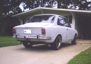

Myles's Ke10!!
Cool Myles, looks a lot like mine when I got it 20 years ago...lol, doesn't look much better now, it was a kind of army looking green but nowdays pretty much stays primered. I like to drive the old backroads a lot and don't have to worry about nicks in the paint.
I try to keep it nice under the hood though

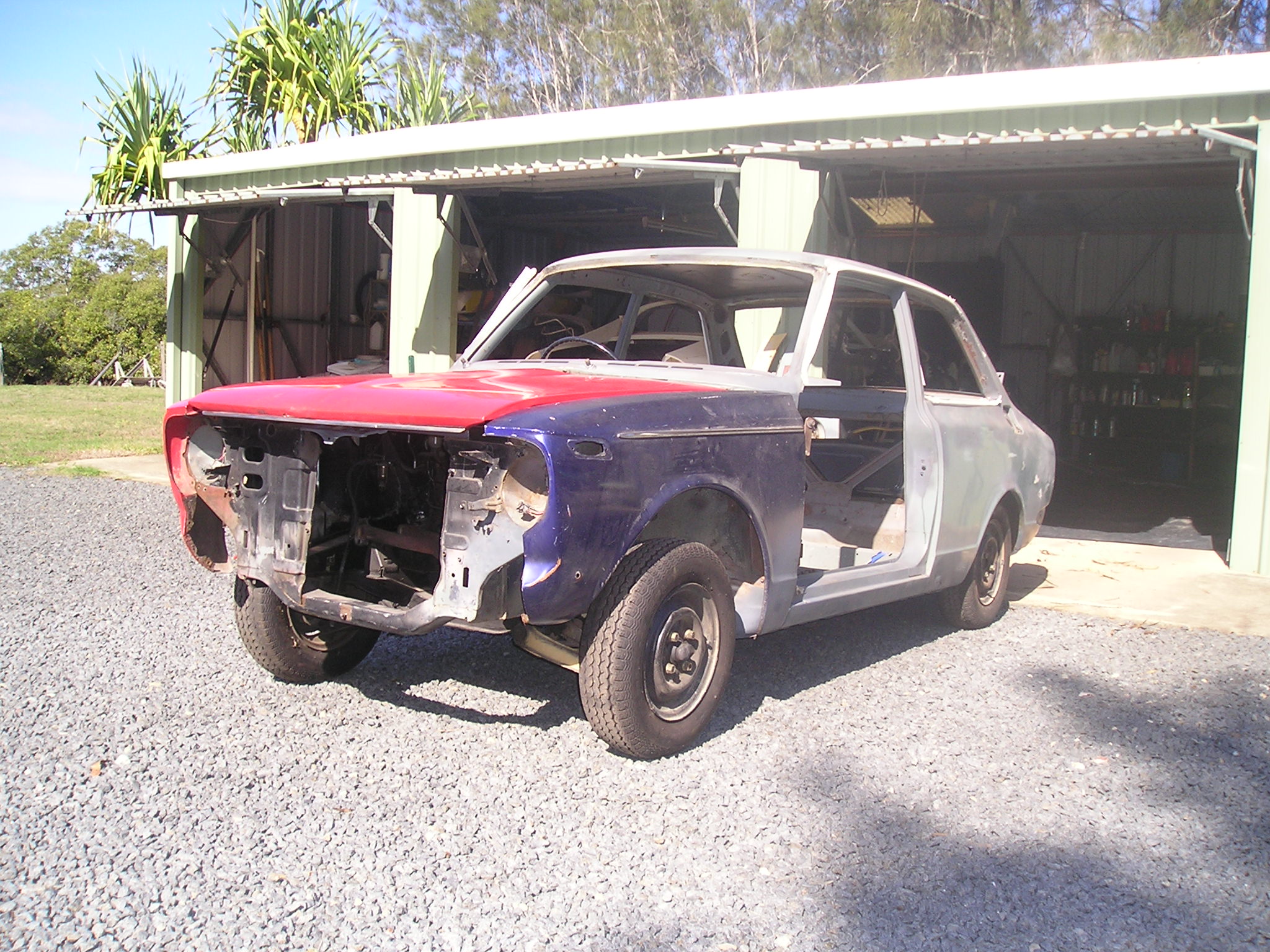

haha i supose thats the cheaper alturnative! but nar I'm hopin to restore this ke10 as they r gettin rarer by the day!, anyway back on track, i did more rust today i did under the passanger side tail light, this side was way worse the the drivers, and actually the passanger side of the car is the side that has most of the rust which i thought was a bit weird but yeah, wasnt very motivated so only did one section but it took me 3 and a half hours!, when this job could be done in 1 and a half easily. don't have ne pics but i will post a few more up when i more done, the plan is that we get the car completely stripped down to bare metal and and undercoated befor the end of my holidays!
anyway thanks for the comments!

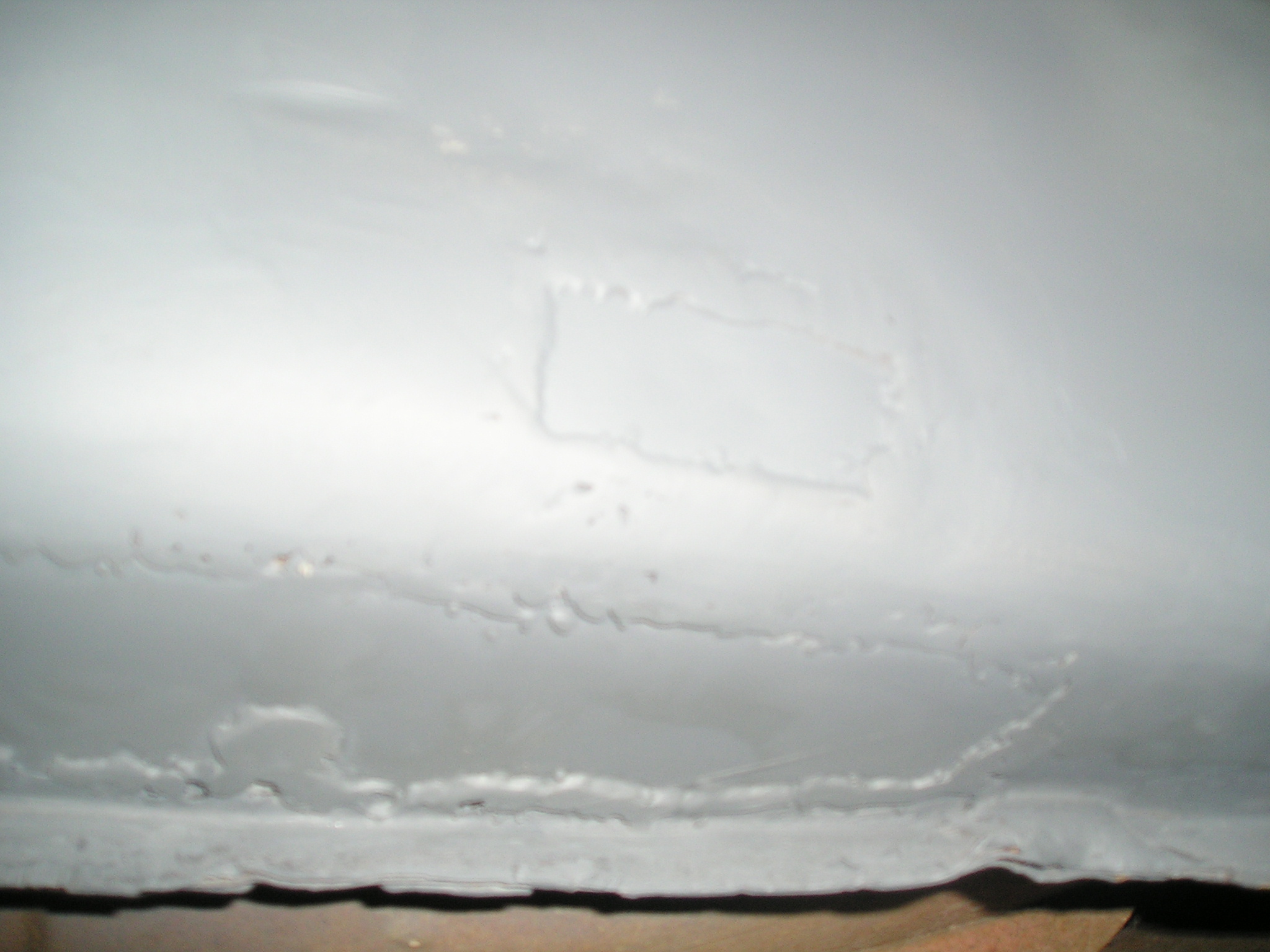

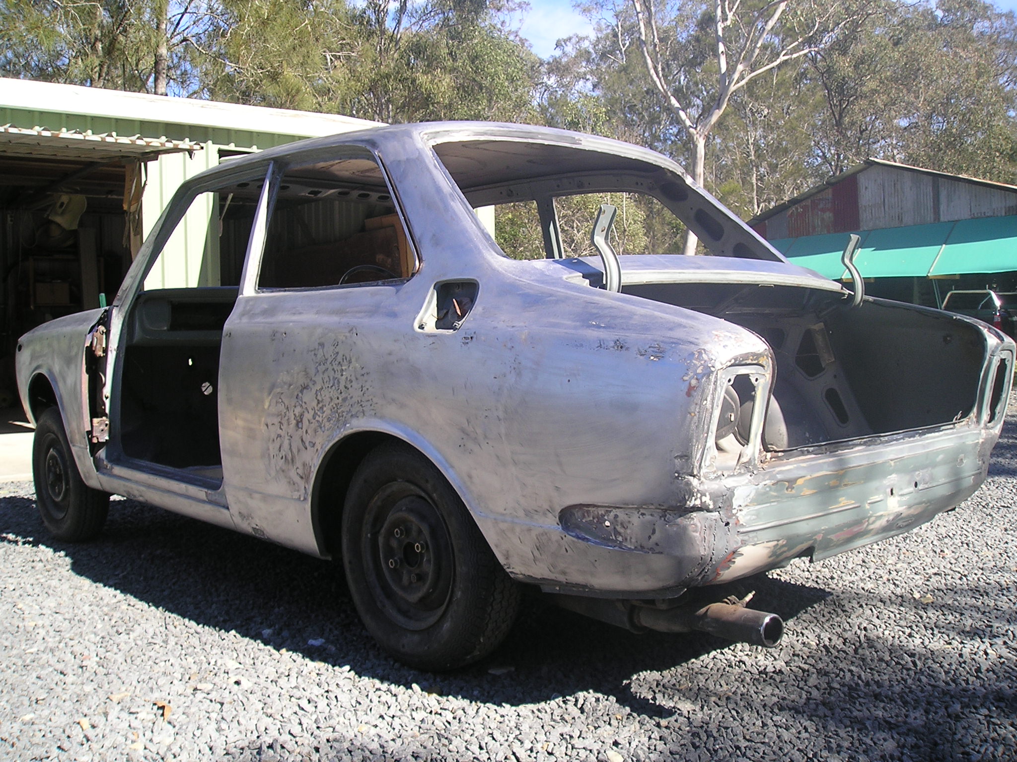

ok well the plan to get the first coat of paint on it befor my holidays ended, blew out the window when i went to straddie for a week, but I'm gettin there, tonight i did the worst part of the car, which was behind the rear passanger side wheel, my welding is improving slowly but nothin to rave about, but it holds strong so it'll do!
Edited by 10ROLLA
by the looks of your welding i would say your holding too far away,and your circles need to be smaller and try and get a consistant run. alleviates alot of that blobby-ness.
not being an arse, took me ages to even get something resembling decent welds. just trying to help...
the grade of glass makes a difference too. as the arc helmets are darker, coz the flash is brighter.
my mig mask i can see through in direct sunlight. my other one i can't...
yeah, I'm using just a cheapo mask that came with welder as i don't plan on doin too much more welding after this car unless on another project, and yeah i am gettin a few constant runs (pic doesnt show the few good bits hehe) but i had a look at my old welds to the new ones I'm am improving slowly, i still have to grind it all down to get it lookin pretty yet but thanks for all the tips, i did more rust repairs on the car tonight and i found mooooreeee rust and big too! so there will be a few more days on the body! cus I'm not much of a welder, i am only cutting the rust out to get rid of it, then weld a new fresh piece in behind that and bog ova it to make it look perfect again, some people might think i shouldnt do it but i don't have all that much money to play with to get a tradesman to do it but thanks again guys ill keep tryin and hopefully soooooonish i will be takin it back to bare metal for a spray! **dreams**

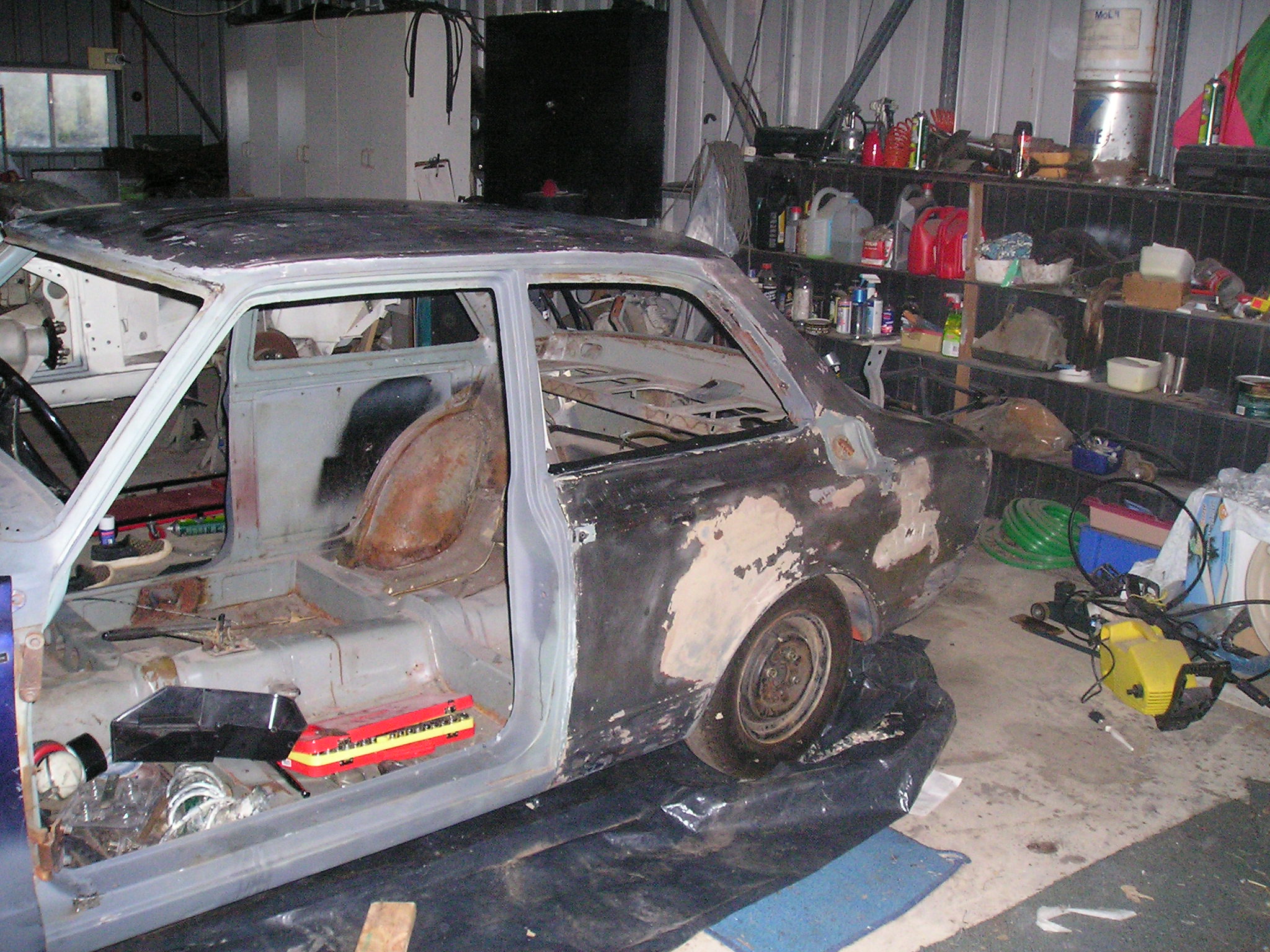

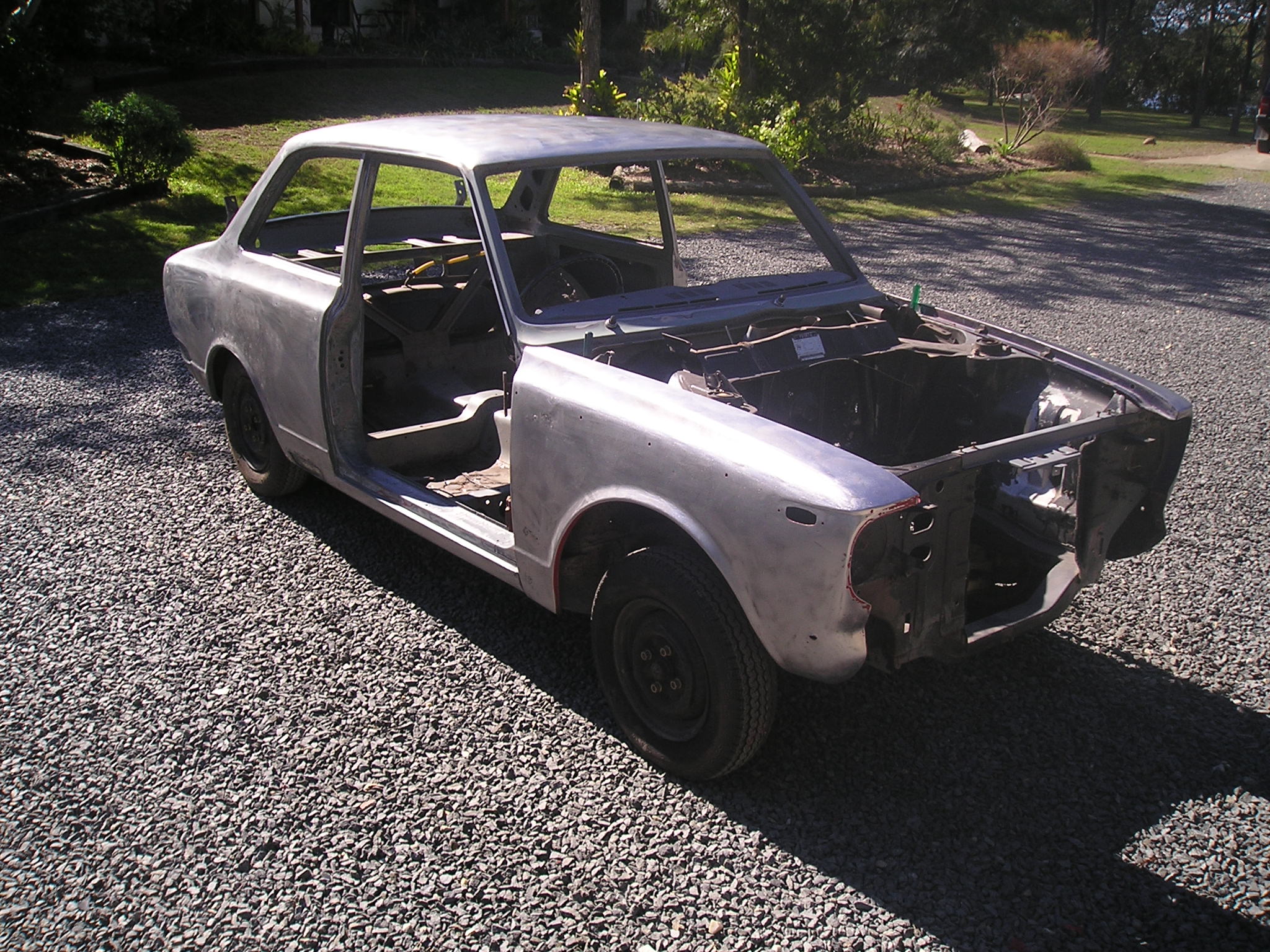

Ok havent updated in a while, but have completed 97% of the rust on the car, only one more spot and the rust is done wooo.... i have been at MPA at birkdale lookin at paint colours! been there twice and both times been there for ova an hour and a half choosing what colours i liked, i have narrowed it down to 3 colours, Red Blue or Yellow, i have been leaning towards a basic red with a pearlesant gloss sprayed ova the top....... should look good, but still have a couple of months befor i choose the defanant top coat.

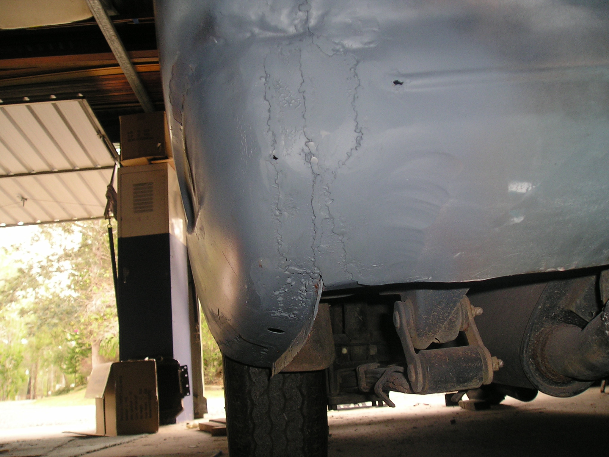

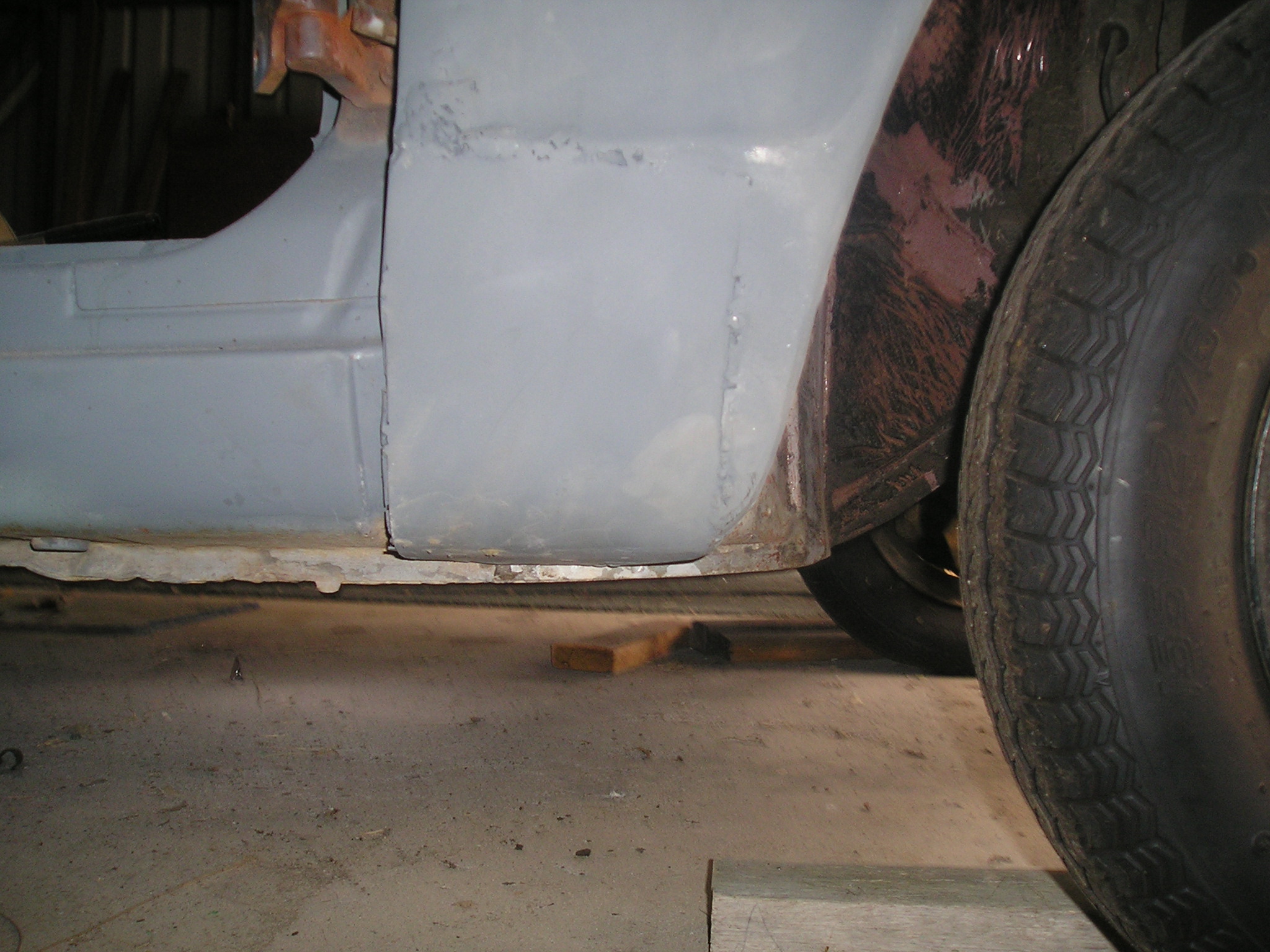

A weekend in the next month the ke10 should be stripped back to bare metal and undercoated, then prep it and straighten the body, this was gonna be done a while back but i have been slack. here r a few pics of the rust repairs grinded back lookin a bit better then the picks befor hand!
Cheers Myles!
Still gotta do a lil more work on this guard but all the rust is gone!
Cheers Myles!

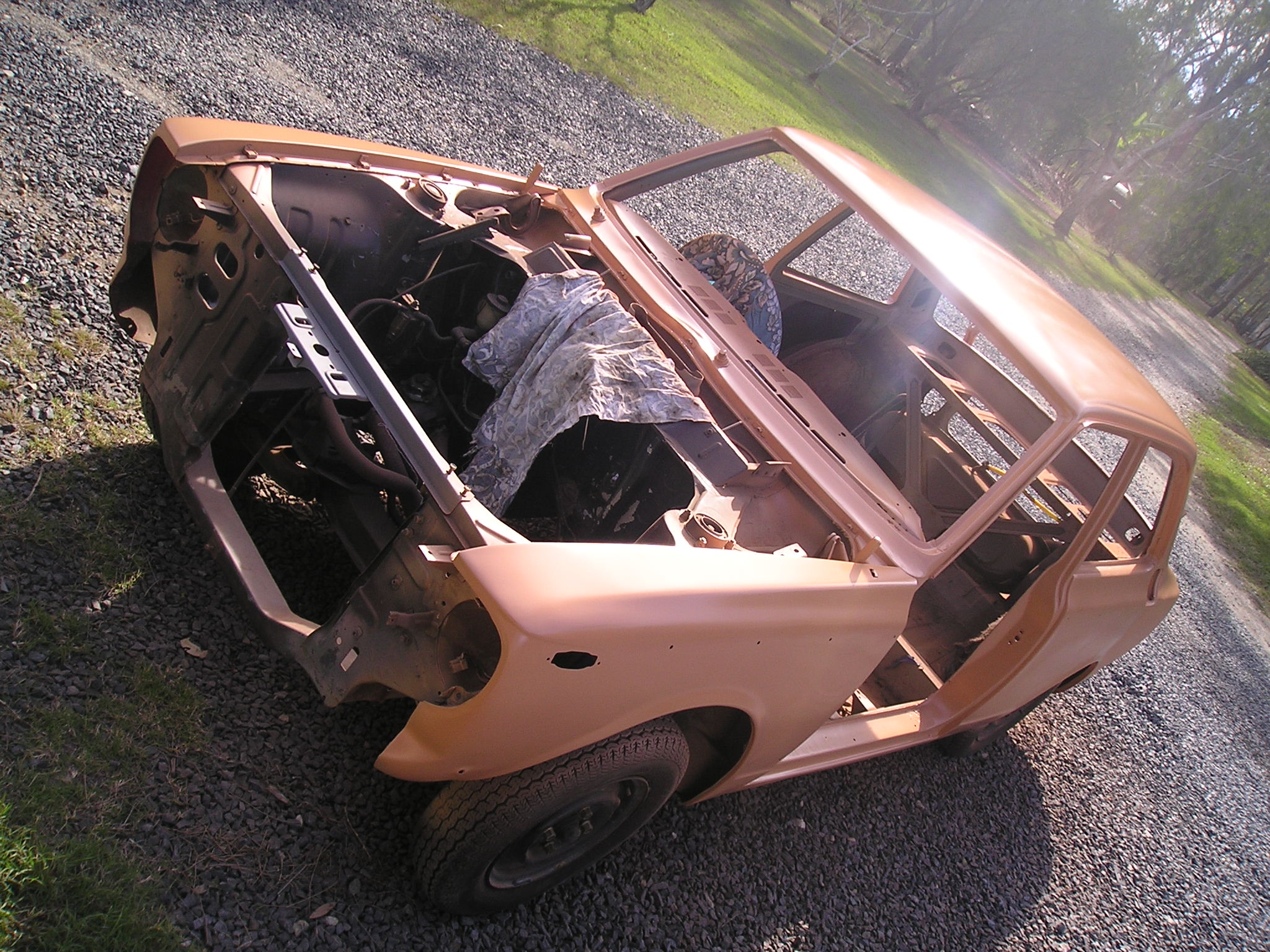

Ok, well i havent updated in a while but here is the run down.
Well i have been chassing a bonnet since the day i got the car, me and my brother sourced out a few bonnets, then found a guy in sydney with a rust free, fairly straight bonnet. He also had 2 beautiful guards and both front and rear, rechromed reshaped bumpers. As my brother wanted a holiday he drove down there for me and got them. (a quick pic of them)

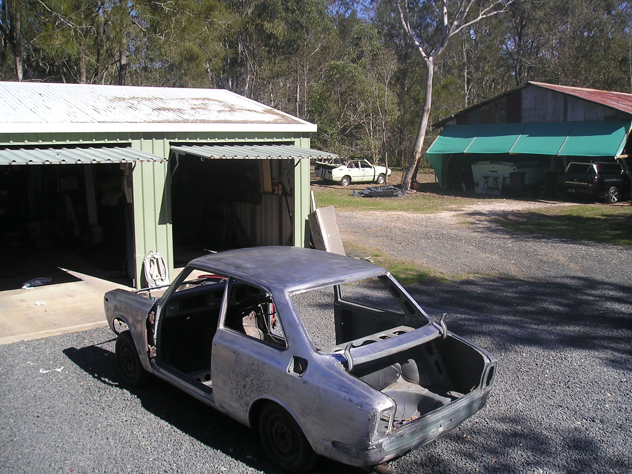

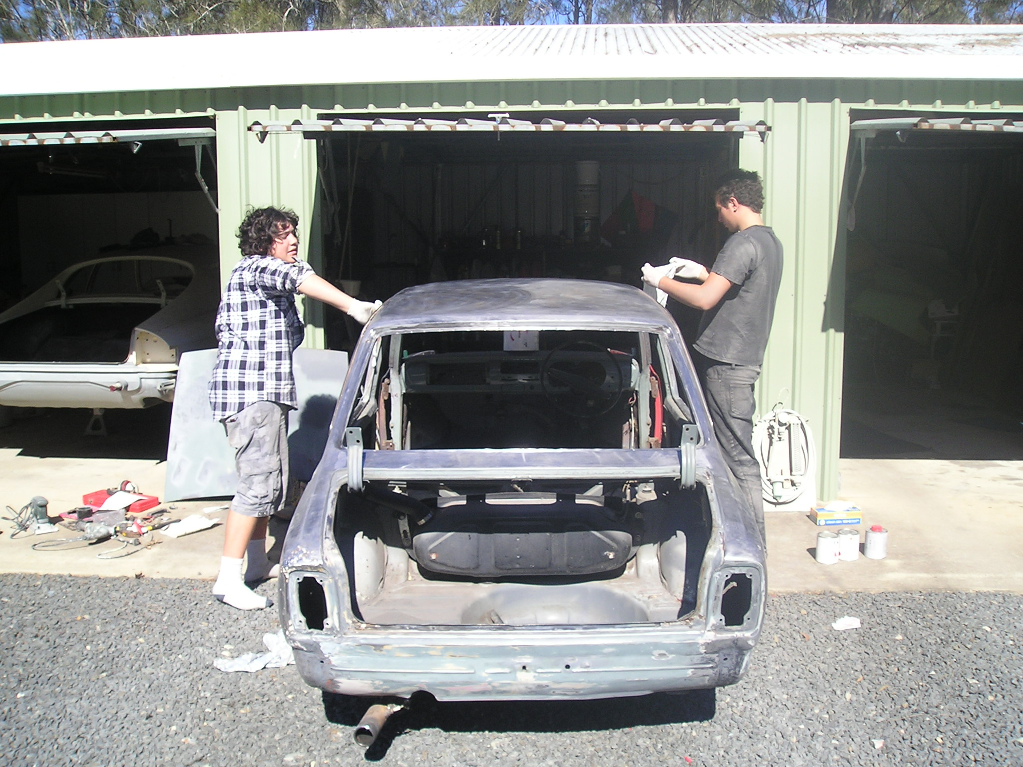

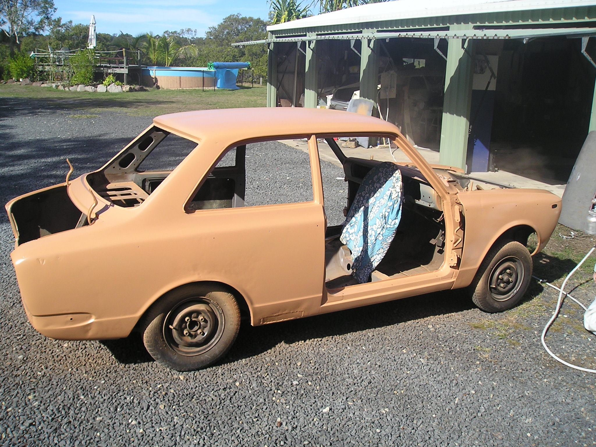

Once i got all the parts i started paint strippering the whole car.... then got the orbital sander to the bare metal to scuff it up abit ready to be painted.
Got it prepared for the epoxy primer (I'm the one on the right)

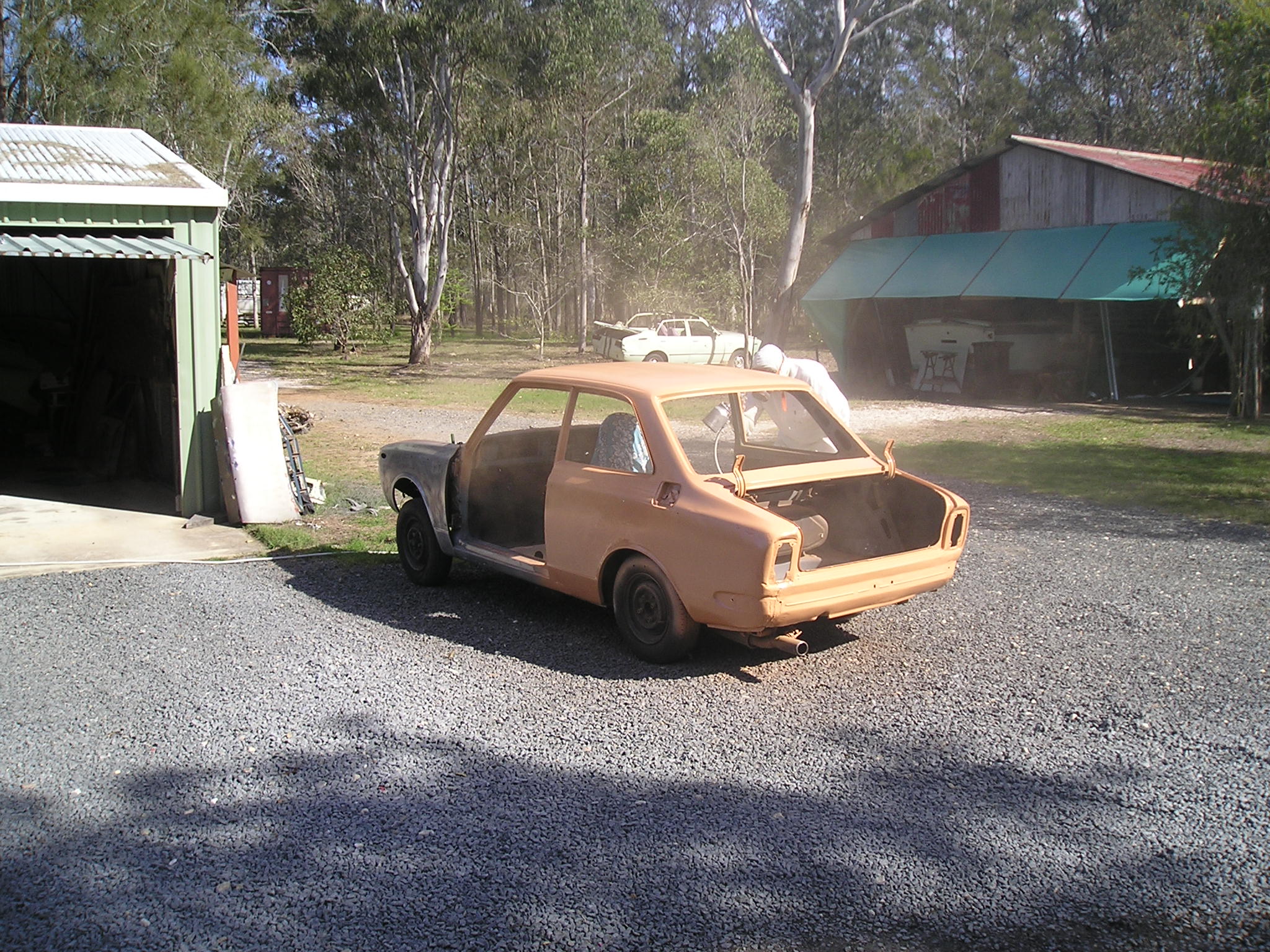

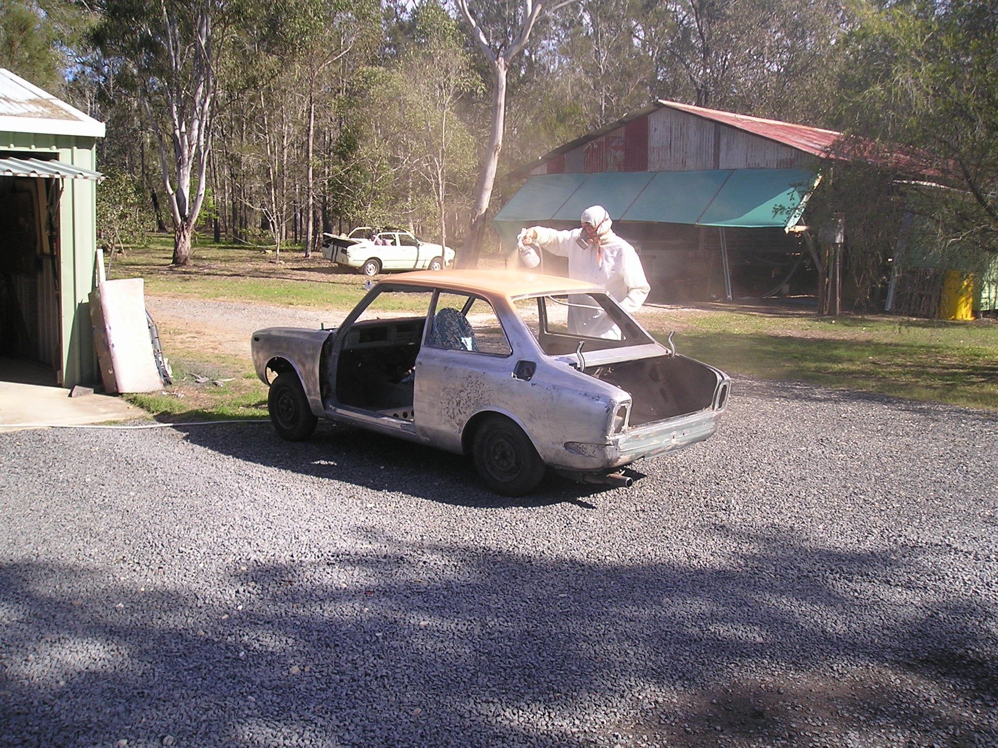

Then got my old man to spray the car in epoxy primer, cause he has had some time on the gun spraying boats.
next is to bog and fare it ready for the actuall undercoart and then get that ready for the top coat!
Cheers Myles!
