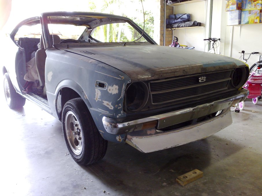

Here's a pic of the front with the bumper attached. I believe the bumper is off a KE35 (no black rubber ends). I have a set aside to attach later or i might just leave them off
looking good .I love these hardtops , looking forward to seeing how the paint turns out. :(
I would also be interested if you make a mold of the wing
That lip looks great, I was planning to get a Golf GTI mk1 lip but this looks waaaay better!
