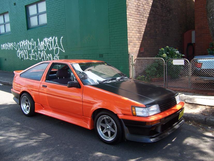

hey guys. this is a pic of my ride and specs
SPECS
Engine and drive train:
4agte rebuilt
steam pipe exhaust manifold
t25g turbo (off a sr20det silvia)
Front mount intercooler
braided oil feed line for the turbo
Custom home made airbox
some big ass radiator (unknown)
7mgte 440cc injectors
3inch exhaust
microtech ltx8 computer with dash
surge tank setup.(consists of 1 bosch efi pump, facet lifter pump and surgetank)
water overflow catchcan
standard t50 gbox (i have 1 as a spare)
the engine is makin 120rwkw on 10 psi
Suspension:
Front
ra60 celica struts complete with brakes
xt130 corona lower control arms
lowered king spring with unknown shocks
Rear
lower king springs
pedders white shocks
whiteline adjustable pan hard rod
corona diff complete with disc brakes setup
Interior:
Microtech dash
Drift button
Fully sick dash mat
Jvc cd player and a pr 4 inch sony speakers
sound deadner removed accept the ones in the boot
Battery moved into the boot
Bodywork:
Resprayed orange with yellow pearl on top(inside the engine bay and door jamb also)
Flair front guards
smooth out rear ends where they had the line under both rear lights
Full vertex bodykit
Painted black standard bonnet
Wheels:
15 by 7 with +20 some thing offset on the front
15 by 7.5 with +3 offset on the rear
195/50/15 nangkangs all around
Parts that are in the workshop waitin to be fitted are:
t18 locker diff
silvia twinpots brakes and coilover setup
Future plans:
ajps rear springs and some kinda adjustable shocks

Thats Funny!!!!!!!!!, I Luv It !!!!!!!!!!!!!!!! :hmm:
ooops
Edited by d1ae86
nice car great colour and rims :hmm:
that is one nice piece of gear Shell, can't wait for the roll cage and striped interior!
John
thanks mate
John
thanks john. it sure is. dunno if it will ever have roll cage and stripped interior. atleast not for a yr or 2
very nice ride shinji, can't wait for you to come down to tassie when i get the P's and do some touge :hmm:
oooh yeah can't wait as well. heard lot of good things about tas
might end up stayin in tas n find work
lol

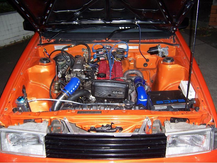

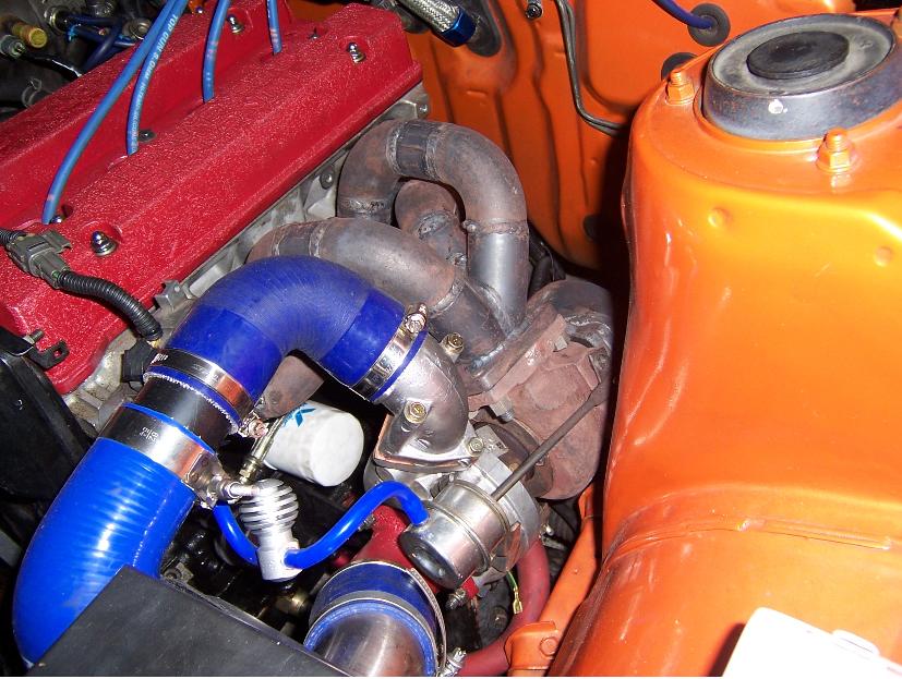

Love the red crackle paint on the cam covers. The whole car looks great too. Really well done. Which model engine have you used, and have you changed the internals at all to suit boost?
thanks mate. its a early model 4agze engine
rebuilt to factory 4agze spec 1200kms ago
