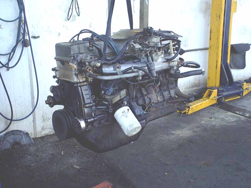

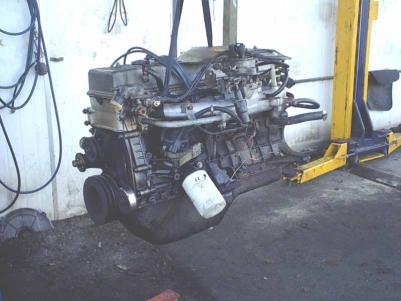

This was the CFI motor I had removed from my EA Falcon before I had the MPFI motor fitted.
As you can see, it was a down-draught injection set-up, not side-draught as Dan mentioned earlier.
