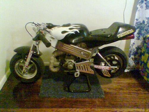

yeah only a fraction of the time that I spent on the exhaust alone in my car, I must be getting better at this.
Show us a pic of your bike, sounds like fun, I want to get 80km/h out of this!! hehehe
anyway costs; with the new engine and not including the stuff I will no longer use its tricky to work out but it goes like this:
I bought the original pocket bike for $140 or something, I used the wheels, driveline and rear fork. I will be selling the rest.
The fat boy pipe cost me $75 delivered I think, that also included a the fuel tank i am using now.

well anyway heres a current pic:
the time has come....
