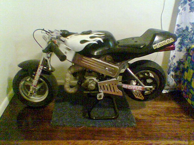

My 40.2cc (aircooled) pocket rocket had the exhaust chambers expanded and the air/fuel flow chamber from the crank to the head bored and ported, The carby was also drilled out to allow more flow and it hammered, One of my mates had a race prepped 49cc (aircooled) it had alot more torque than mine but i held it at top end, You should have a lot of fun on that :lolcry:
Here is a pic of what mine turned out to be, I even did the flame job myself:
trev: sounds good, its always great to hold your own with the so called under-dog engine!
