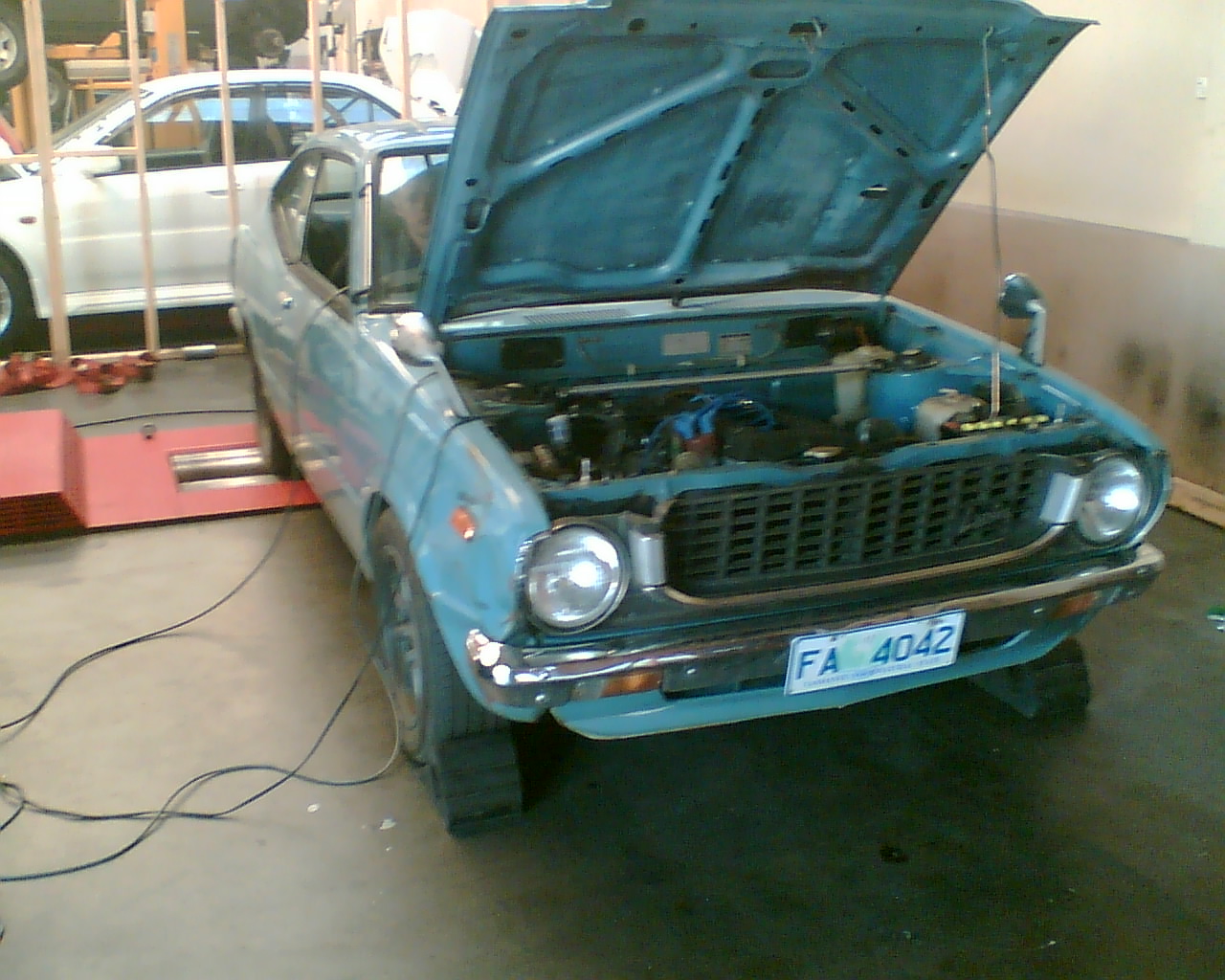

Just put the old Corolla Levin on the dyno for a quick run after work. 80kw at the wheels. I didn't make any changes, just run it as is.
2T-G
3T block - crank - pistons
~305 degree cams, stock cam timing about 110 degrees
I recon I could tweek it to 90kw easy if I had the time.

what did the strut brace come off or is it a custom job?

Whos Dyno is that?

Strut brace is custom, I made it several years ago.
I'm working at Jadamzic Auto where the dyno is.

My car has very simple specs. It would be easy to copy. Basicaly TE37 spec with some sports mods. Here is the info:
Engine:
2T-G 88222 head
block, crank, pistons are 3T-C. Pistons cut alittle bit to suit 2T-G valves.
crank and flywheel balanced
2T flywheel machined on the lathe, down to 6.5kg
Reground cams at about 305 degrees (this is the main trick)
Irridium spark plugs
2T-GEU distributor and igniter (I use coil and ignitor off Holden Shuttle, as its ND and plugs in)
Stock radiator tanks changed to 3 core.
Gearbox:
T50 from TA22
standardish heavy duty clutch
Tailshaft:
TA22 item shortened
Crossmember:
Modifyed to suit 2T as per Toyota manual on my webpage.
Carbies:
Solex from early 70's 2T-G, with factory 2T-G manifold and linkages
Exhaust:
2"
Front struts:
Corona shortened strut, HiLux 4 spots, vented disks, coilovers, 6.2kg/mm, short stroke.
Rear:
Complete diff from RA23 Celica, welded for leaf springs. TRD 2-way LSD. Koni shocks. Rear sway bar from late KE55. Front swaybar from late KE55 (its bigger).

any idea of the compression..?
how much diffrence do you recon the cams made? ive got a 290degree cam with extra lift for my 4ac, I'm not to sure what thats like with the 4ac and i know its diffrent with single cam..
also is that a single down draft solex? how big is the throtte/s do you know?

They have sidedraft carbies, solex mikuni brand, 40mm diameter throttles. 4 throttles!
Compression works out to be about 10:1 or 10.5:1 not 100% sure. That is with standard 2T-G head, and 3T-C pistons with the pistons cut just a little bit on the exhaust side to clear the valves. 2T-G has bigger valves than 2T/3T. I used 86mm pistons, 1mm oversize. I have used premium 95 fuel.
The main rule of thumb with these engines, especialy with 2 valve and not reving past 8300rpm, is that for a 1800cc motor you will not get more than 180hp. For a 2 litre you will not get more than 200hp. With a 4A-GE the head design is better and you can get 200hp from a 1.6 litre (I plan to do this with the AE86).
