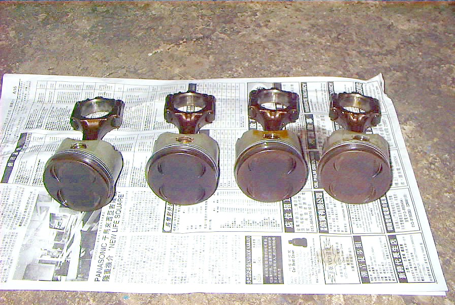

Hi,
The pistons ill have to double check to see if i can get dish capacity of 4agze ones BUT on the pistons shape 4agze ones have a small dish smaller thana 5K 3mm one but it is a dish for the 4 valves to fit in pic at end of my post so these will prob up CR more with less shaving
BUT $150 for 3mm dish 5K pistons good price so if your not running boost get them a bit less stuffing around and in the mean time if your interested just play with 4agze ones and see if you want them one day as they will rev VERY hard when you blue print the bottom end and use them so recommended even if you don't run boost but want to rev hard.
