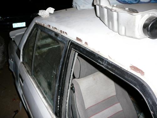

All the ugly rust holes are treated and bogged, not really too worried about quality of the job :jamie: Won't be too bad though. Cross fingers the new 2 1/4 exhaust will be going in on Friday. Will do the roadworthy with standard suspension, I'll swap the good gear over later. I'm really gonna have to invest in some new rubber too, I think grip will be a problem.
