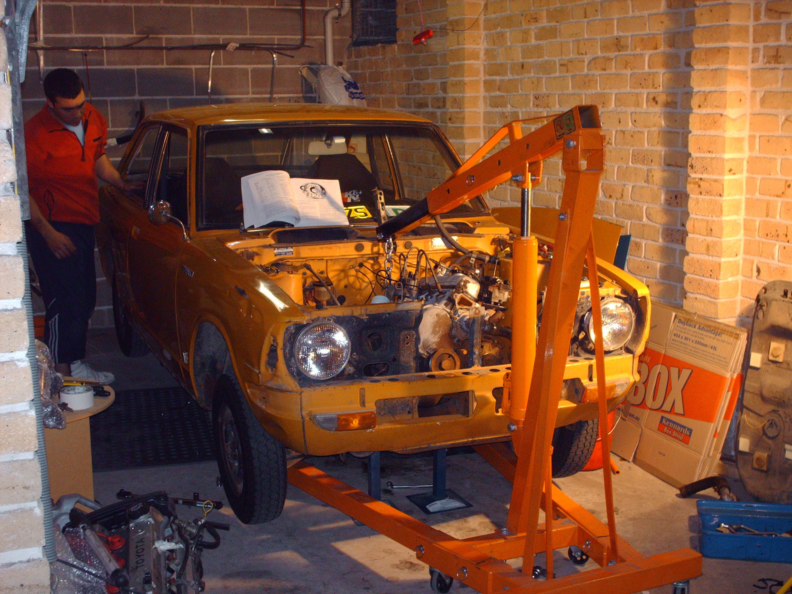

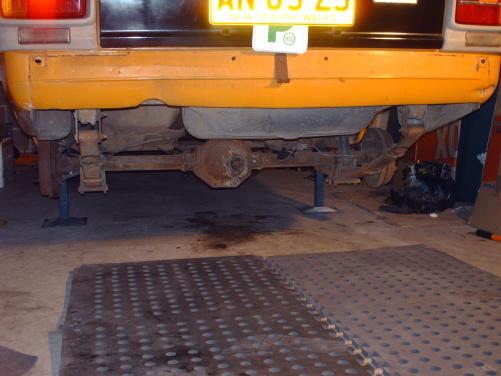

Hi there guys, just some progress info...
I just got back from the garage, me and a mate had the day off so we took out the motor, gearbox, shaft & diff...
Oh, by the way...I will be running a remote Brake booster behind the dash, passenger side...

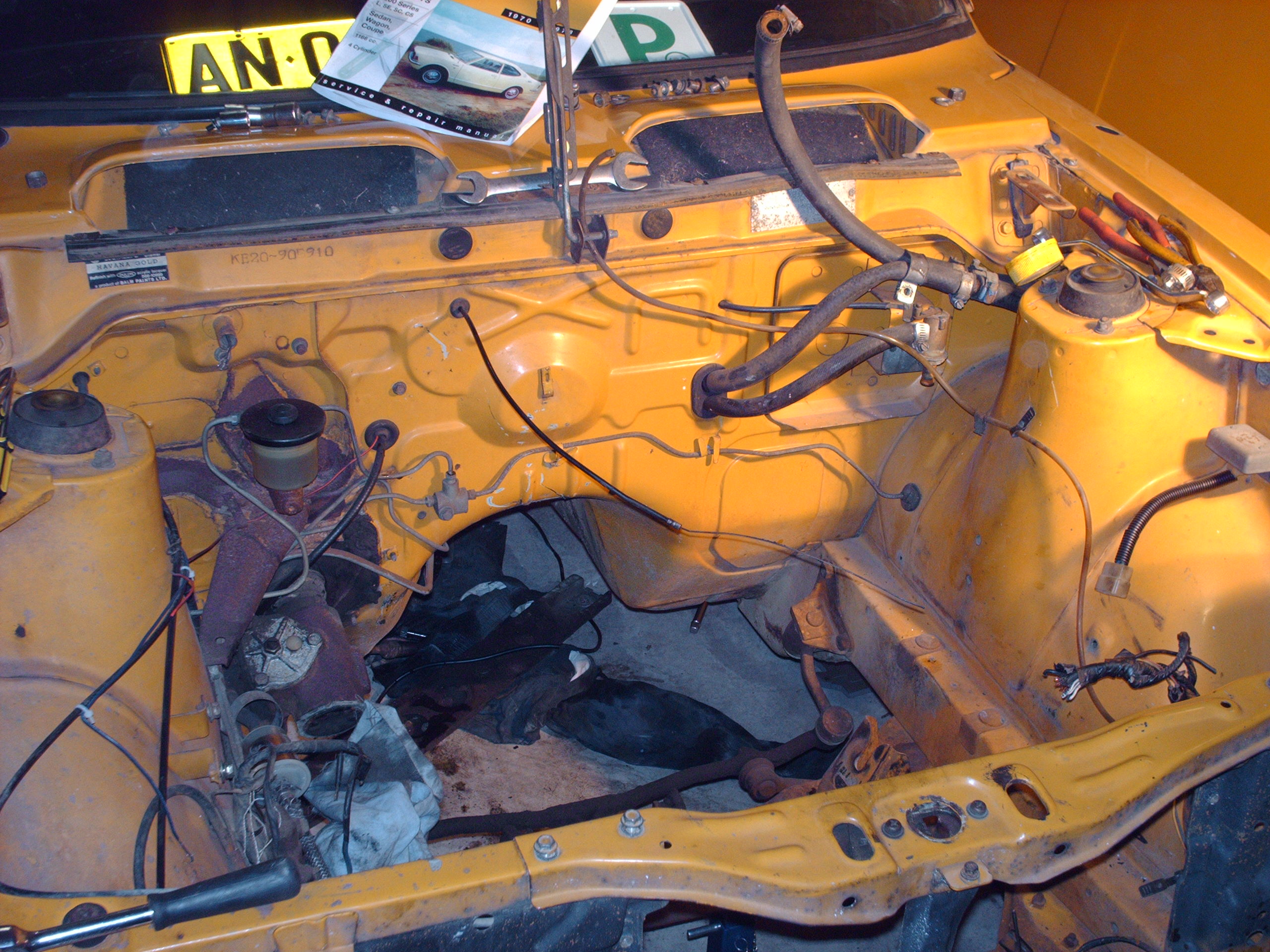

First things first, all wiring and hosing disconnected... and the motor & box came out
The car sits so much higher at the front now, we'll soon change that...
The Engine bay gremlin....(not bored at all... :) )

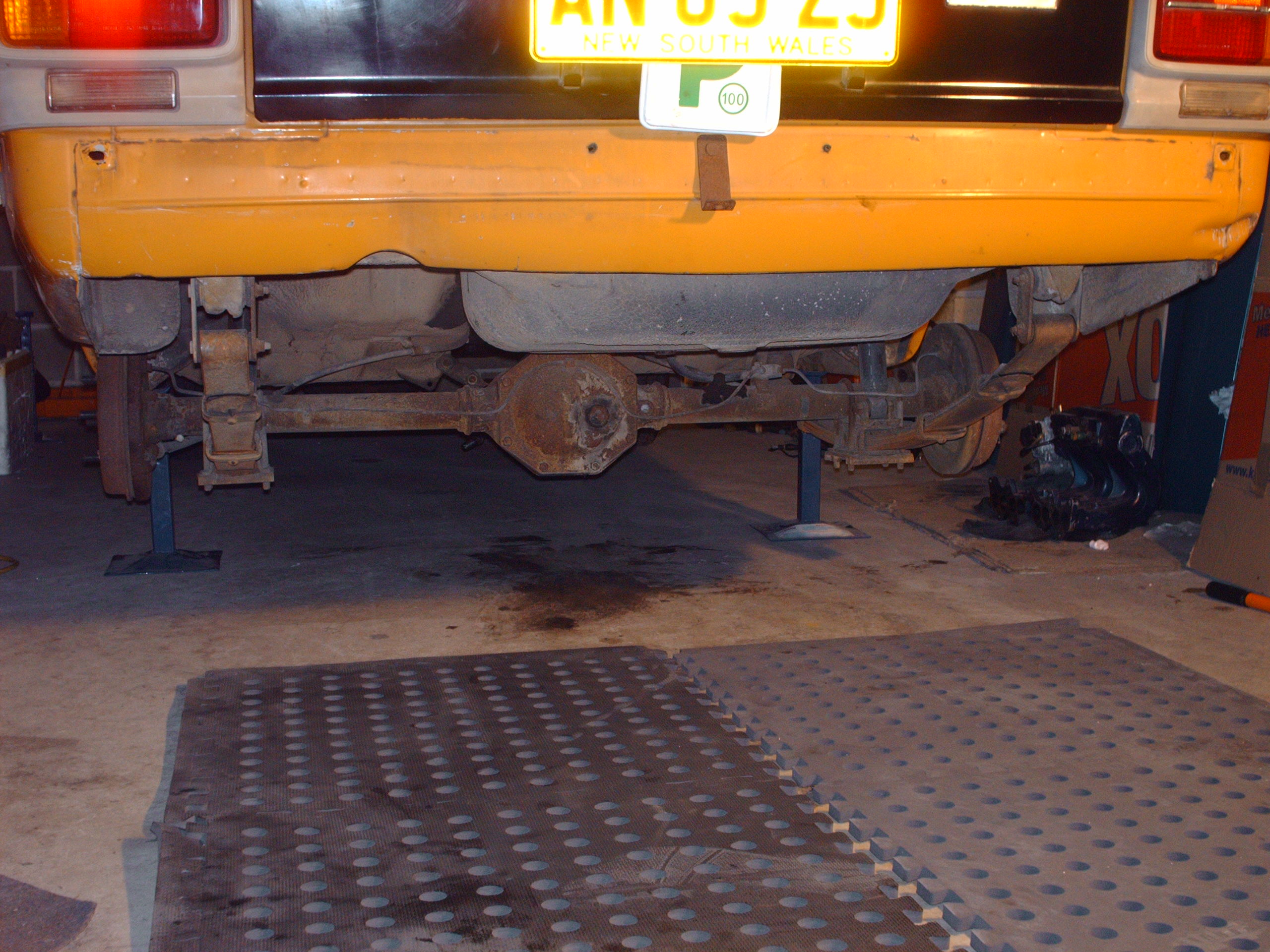

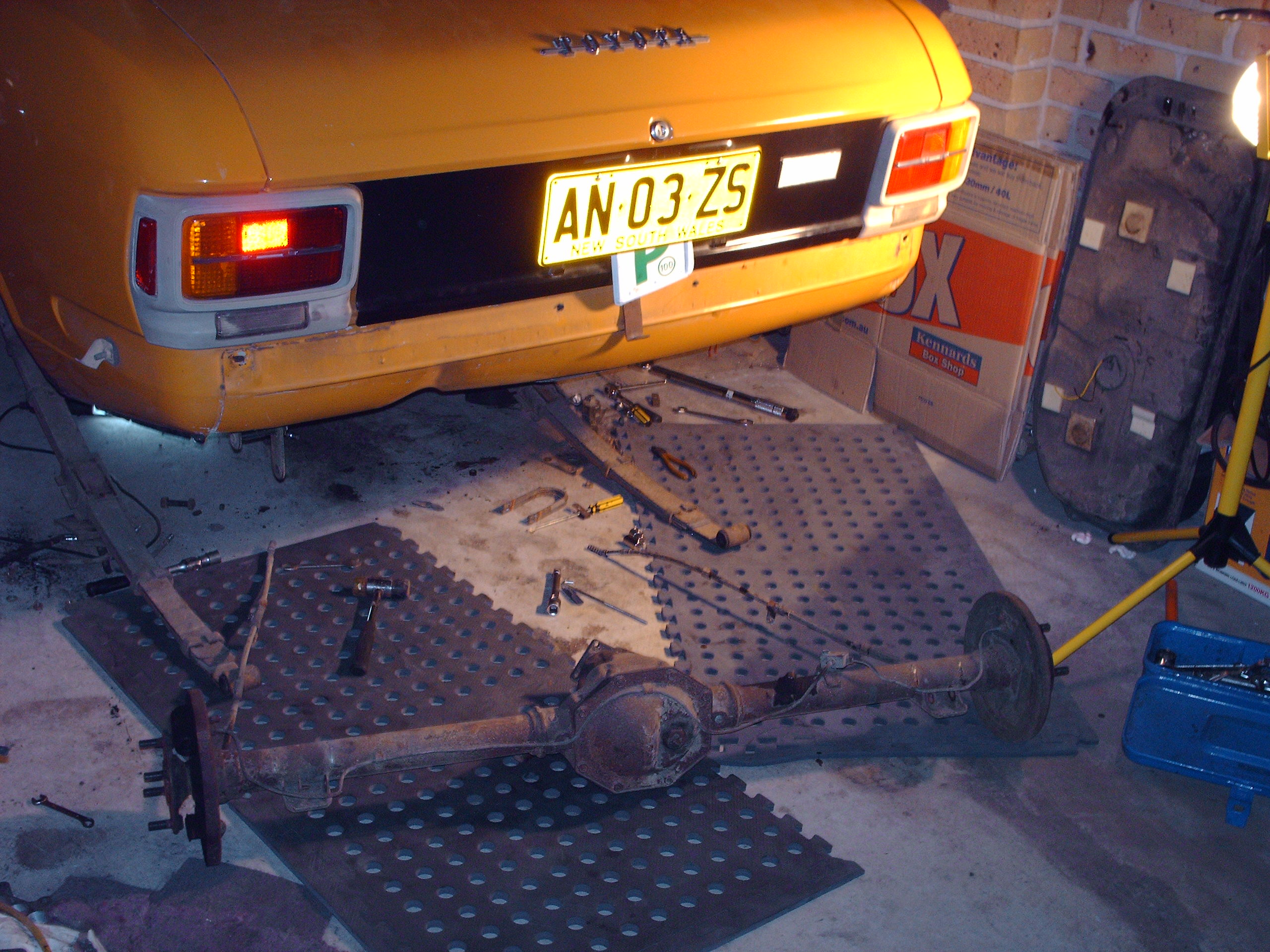

Diff out...
Thats all for now,
Next is Diff setup, then motor & gearbox mounting....coming soon....
Thanks for ur support guys, cya...
