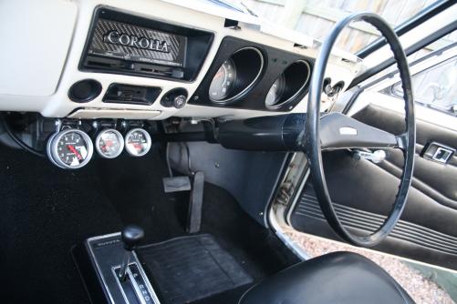

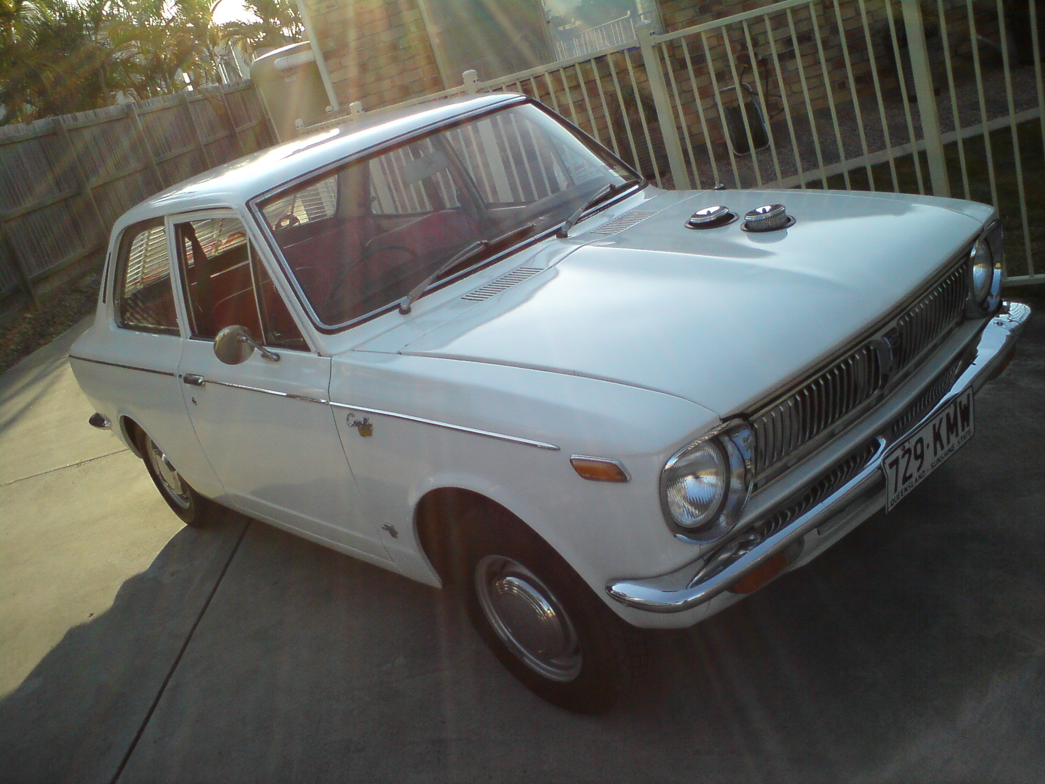

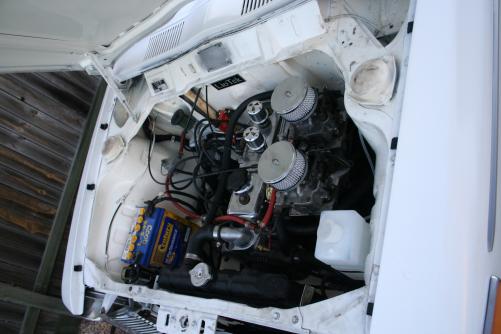

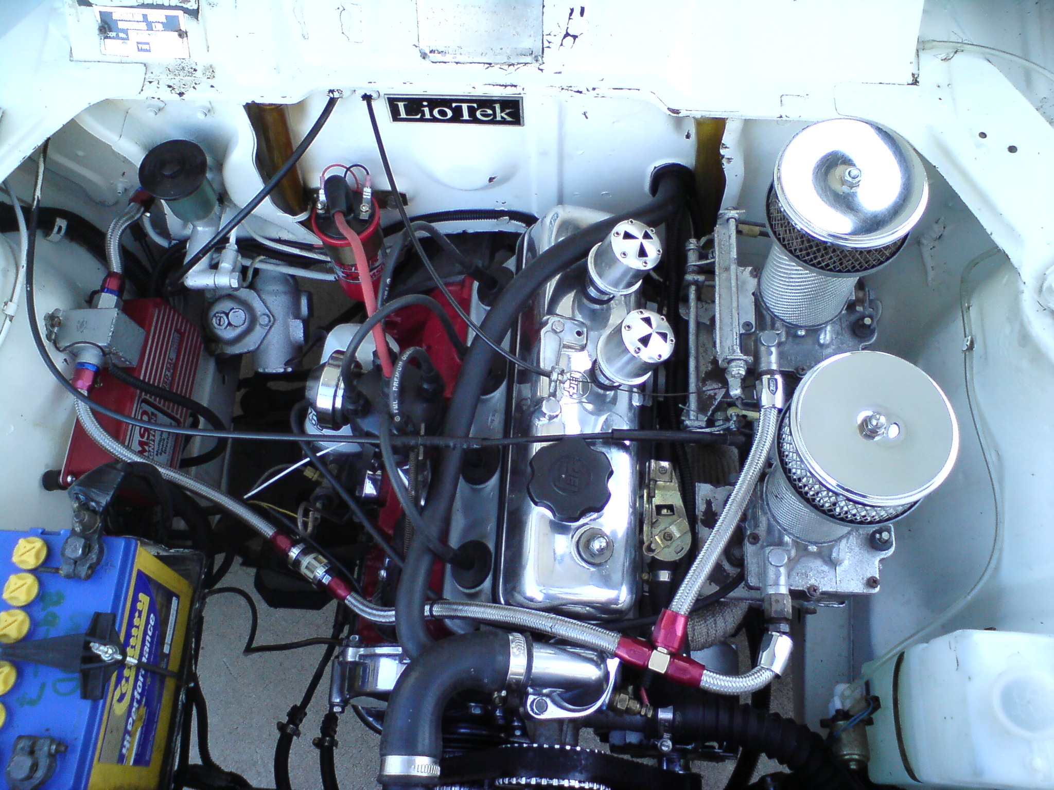

Hey guys, have new pics of recent upgrades and specs which i have now done to the car since last time.
Car now runs a 25/65 cam by TIGHE, full MSD Ignition setup which i have to say is well worth the money, gilmer drive setup and yes filters through the bonnet. Also replaced the old toyoglide with a much stronger auto. Also every cast alloy part is polished, rocker cover, thermostat housing, timing cover, dizzy, oil filter housing the list goes on.
Interior is now changed to near original spec with red seats and carpet (door cards will be fitted in a few weeks, same colour as seats)
Stay tuned as this car is going to the paint shop very soon.
Love the filters. Hate the filters. I don't care its my ride and my tune.
Oh and white walls this weekend are also getting fitted.
For any more specs or pics, just ask.

i reckon those filters look wicked!! well done with this uild man!! props to ya
Love under the bonnet - very schmick - twin carbs are awesome!!
A quick glance at the last pic - I thought you had the carbs sitting on top of the bonnet and I had no idea what you were going on about, but then I had a really good look... It looks wicked!!
I don't think I've seen any other early rollies with components sticking out of the bonnet (apart from the ones with huge spastic engines in them!) very unique - love it
I'm shocked I'm admitting this but, the filters look tuff!!!!!!
hahah. nice work.
most Ke1* people will prolly hate u more for simply cutting up a rare part ;)
cheers, scott
absalutely perfect mate
white walls with go really nice
very clean

I love the engine bay pic, looks tops! Is it legal to have the filters coming out the top of the bonnet like that??
No it is not.
• The edges at the front of a scoop/projection shall be rounded with a minimum of 10mm radius.
• All other edges and corners shall have a radius of not less than 5mm and be designed to reduce the risk of bodily injury to any person to a minimum.
• The scoop/projection must not have reflective surfaces.
• Air cleaners or carburettors must not protrude beyond the original bonnet profile unless the bonnet scoop/projection is manufactured from equivalent gauge mild steel, compared with that of the original bonnet.
• Air cleaners and/or carburettors must be covered by the bonnet scoop.
source: QLD Transport Light Vehicles Modifications Handbook

Hey guys, thanks for the thumbs up. Just wanted something different.
I have another bonnet with no holes which will be fitted if the COPS or DOT give me a hard time. Although the other day i was driving around Redcliffe and happened to drive straight past a police car, they both looked, smiled and gave me a thumbs up, lol. Might not be so lucky next time, touch wood.
