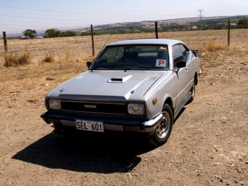

it still had alot of faults like a broken grill and all. but finally a couple weeks back i went down to you pull it and amazingly found a grill to suit as the ones with square headlights seem almost impossible to find. then after installing it i discovered that the panel that had been replaced from running into a pole was of a car that obviously had round headlights as it doesn't line up properly but its barely noticeable.

Hey mate, Looking good!! Love the square headlight hardtops. Tho I do believe that the guards on square and round KE55's are the same.
The only difference is the painting. The earlier (Round) had a chrome trim at the base that ran across the whole side of the car while the later (Square) had the bottom section of the guard painted black with some rough sort of paint.

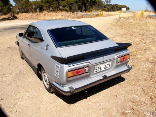

yeah this one is last off the line being the XX model. hehe think there were about 500 made worldwide. but the square head light 55's seem to be hard to find. i mainly spot ones with the round headlights.
and yeah i think its off a cordia. pretty sure. it looks good but most people get put off when i mention that it is a rubber kit and u have to oil it up frequently or it gets dry and cracked.

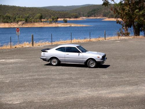

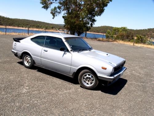

new pictures from today. cleaned her up a little to the best of her potential.. (well to the best i could be bothered right now) so as i could post some decent pictures.
a view of the drivers side (featuring new grill)
the interior (alot cleaner than last time)
the seats
the back seats (a couple of small burns)
the boot with my woofer
and the passengers side (featuring my lovely dents)
thats basically the car inside out now. hehe.
ill save new pics for when new work is done on it.
but new in these pics is my grill, gear knob, ipod remote (on my steering wheel) and my lovely dents. (grr @ busses!!!)
