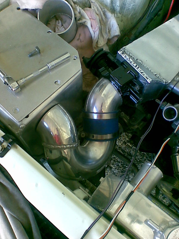

Well here is my pic as promised.
Hope you all like.

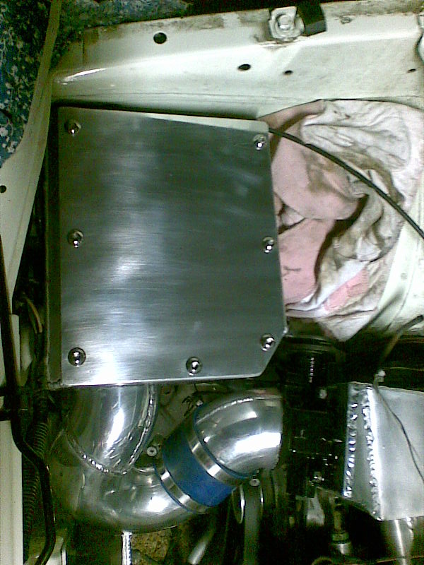

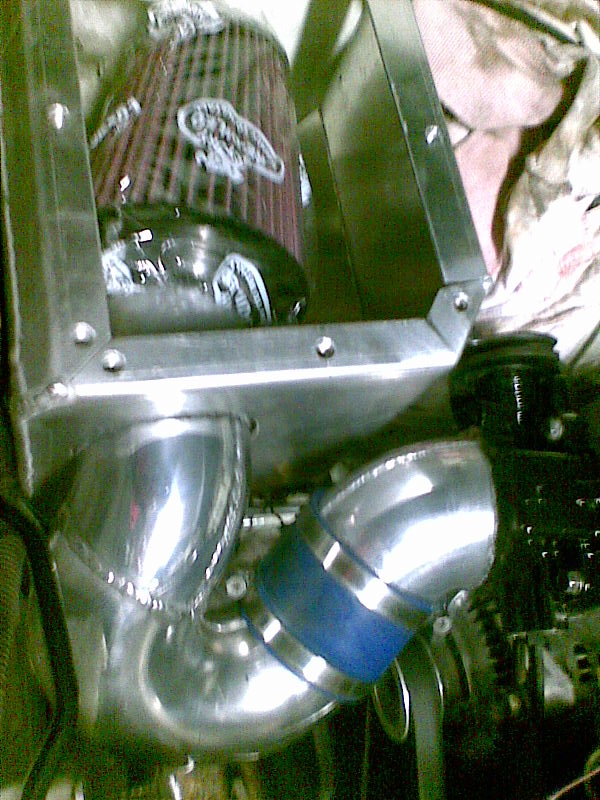

All I gotta do now is cut a hole out and put a filter in the box and that is yet another job done on the KE55. :bash: :y:
I feel like I am making progress again and it makes me darn HAPPY ! ! ! ! ! ! !
Completely finished off the job tonight. I was lucky and an Auto Shop was open and I purchased myself an air filter.
Here are some more photo's.

Where does the air come in for the airbox?
The box is open on the drivers side. I am also going to cut a section out of the front panel which is right behind the headlight and then I also have another plan which I may try to do and I will put up pics when I do it. I was thinking of cutting a hole in the bottom corner further to the front of the car and put a pipe from there to where the bumpe bar comes through the front end.
Do you think that will be a sufficient flow of air? :y:
I hope so.

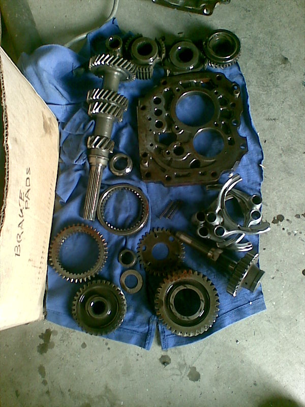

Still going strong with my conversion. I have been making my oil catch can and I have fully finished off the intake pipe with the air temperature sensor fitting on the pipe aswell. The latest though, I have been pulling apart my celica gearbox and getting it ready for a full overhaul. So here is a picture for those of you who haven't seen inside a gearbox. And, mind you, there are still some more parts to come.
So anyway, nevertheless I am still workin on the KE55.
