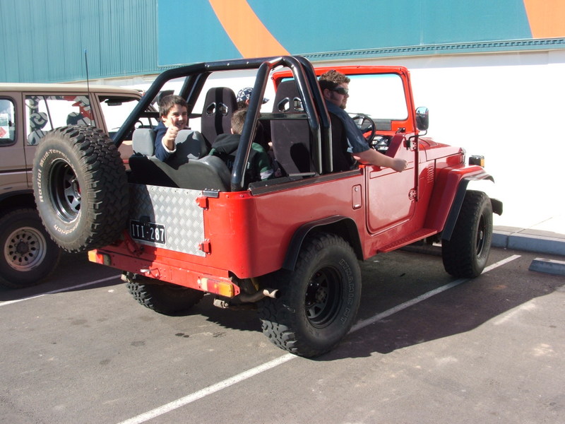

October 10, 200719 yr comment_202595 vht wheel paint, used in on my 4by rims came out great, and it not dear Edited October 10, 200719 yr by pozman Report
October 11, 200719 yr comment_202691 vht wheel paint, used in on my 4by rims came out great, and it not dear Is that pic taken at bunnings on the nepean hwy in Mt Eliza? Report
October 11, 200719 yr comment_202724 yeah i have always used VHT wheel paint and it comes up a treat! Report
