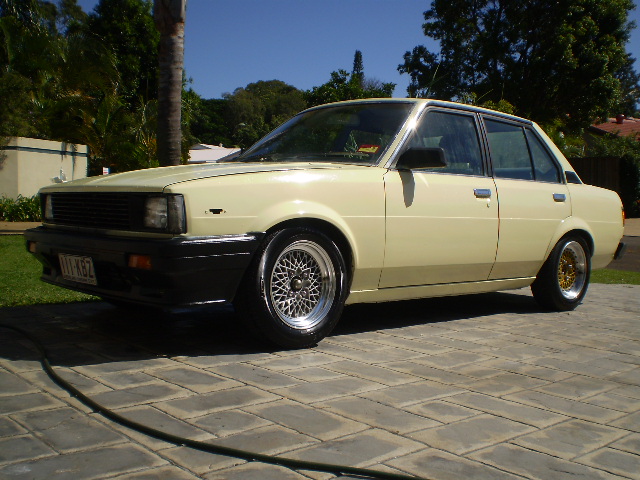

tercel front bar

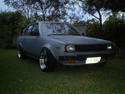

ssr formula mesh. look nice but need to be widened.
and painted her. as i was sick of the 2 different silvers. almond pressure packs ftw.

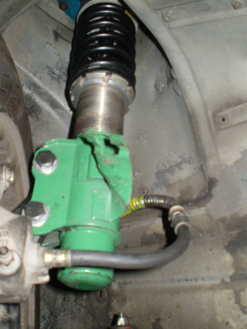

also does anyone know how to undo the big nut on top of the strut that holds the shock in? do i just get a big shifter or is there a proper tool?

Car's looking nice with the meshies up front. What are the widths and offset on them?
With the gland nut, use a pipe wrench or a big shifter. And I mean big! I've got this big one (probably the biggest shifter I've seen) and it was slightly too small. Had the tap it on with a hammer.
nice car man starting to look like a drift pig
how i undid mine was get a big spanner and a hammer and wack it, and it cracked the nut then undid it
be careful tho those springs can be under a fair bit of tension best too use springs compressors

the meshies are only 14x6 +8. not really a great size/offset but they'll do for some skidders till i find something wider.
also i got rid of the 86 struts an got me hands on an s13 set up. tein coilies, cusco tops, ca brakes and 9kg springs, way to hard but better than running on bump stops.. and they seen to fit behind the 14's fine. so now she'll stop on a dime. also got a bit more track.
the only downside to this is that with the coilovers wound right up the wheel still sits in line with the guard = exhaust sits 80mm off the ground.

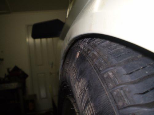

fitment. shall definatly be needing a flare..i also want wider rims than whats on there :bash:

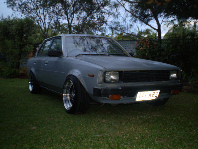

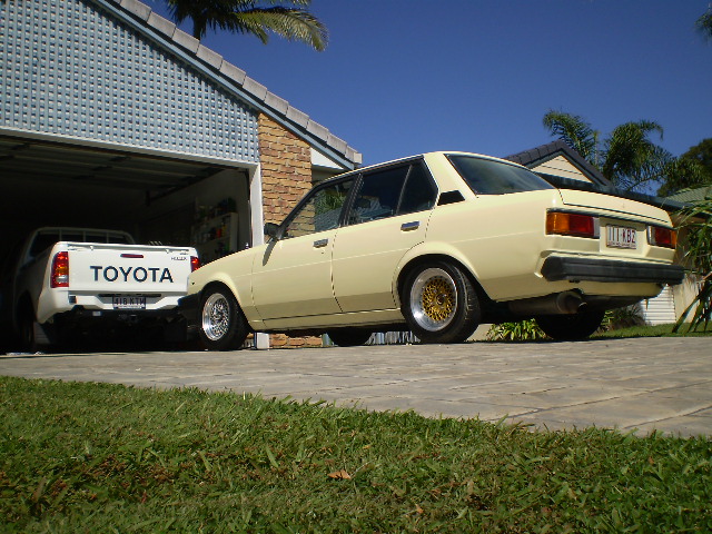

ok well a bit has changed since last time. the colour for one. went back to grey as i didnt want to go anywhere near the DOT with the rolla in its current state in fear of them having a "closer" look to change colour over. so another trip to bunnings, 20 bucks an half a carton later it was grey again.
also got a silver top flywheel and heavy duty button clutch backin up the bigport. revs and grips like a mofo now.
t series drum rear end. meh something to attach wheels to. :P
sieras in the rear. daymn loooow. exhaust resting on the diff.. under diff it will be.

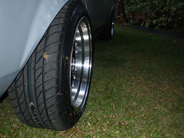

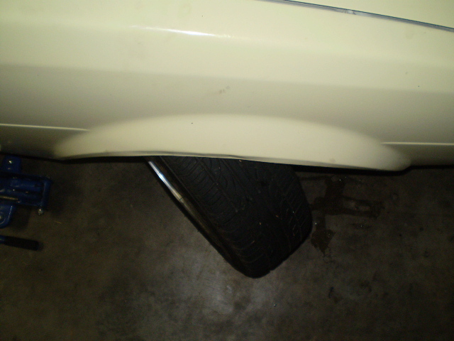

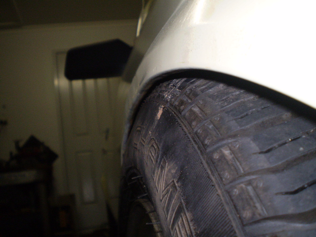

and lastly my fav.. 15x8 -9 challengers and 15x8 0 sportsmax.... man that was fun trying to get these under the guards. got sick of tryin to be neat and got the BFH out. bog should get any imperfections out.. :jamie:

and lastly my fav.. 15x8 -9 challengers and 15x8 0 sportsmax.... man that was fun trying to get these under the guards. got sick of tryin to be neat and got the BFH out. bog should get any imperfections out.. :P
I know exactly how you feel, mate. I had the same experience with my back gaurds. BFH and heat gun ftw!

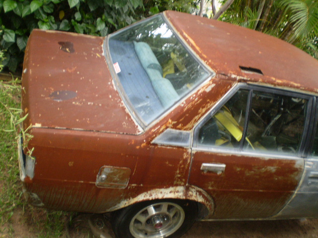

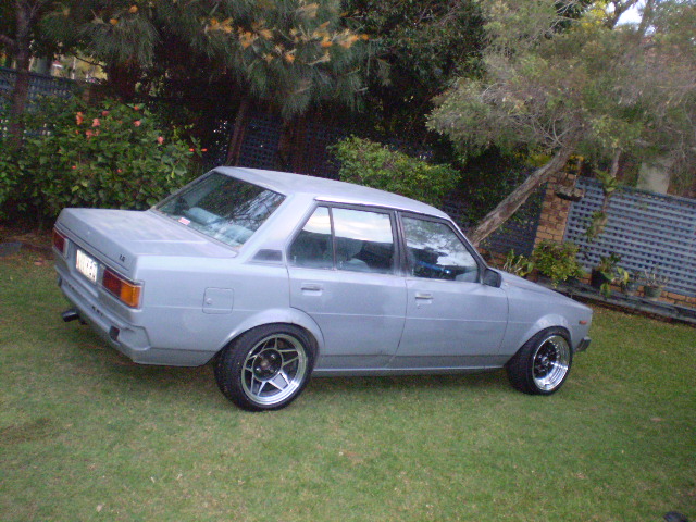

haha yeah, she wont be getting driven anytime soon or maybe forever. off to the scrap yard soon unfortunately.. but fear not i will be getting another one someday.. just really sick of all the elevnteens having one.. hopefully they don't find out about ye older corolla's..
this is her two days ago..I'm not ready to let her go yet..been in the same spot for 2 months.. the red shit is rust not paint..
