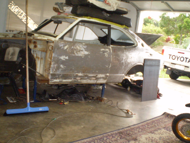

  18. hilux05 replied to Des's topic in QLD / Brisbane
    Spotted a red ke20 on the highway this arvo about 2pm driven by a young lass, some type of black rims i think.. South bound just after the caboulture BP.. that was probly the best part of the trip home and the first one ive ever seen on the road....
  19. HKS did do a few side draught mani's for the good ol 4ac, one was for sale on DC a late last year too... As what tom said. Blow thru supercharged is what i intended to do to mine but of course a 4ag came up at a price i literely couldn't say no to.. but if you want some idaes.. http://www.paradiseracing.com/index.htm http://4ac-powered.forumotion.com/forum.htm the best 4ac site.. Richie.
  20. just get some camber tops, then you can dial it in to whatever you want.. failing that: XT130-KE55 - 310mm MX62 - 365mm GE Sigma - 330mm S13 350mm its only 20mm difference between the sigma an xt.. man up i say :yes:

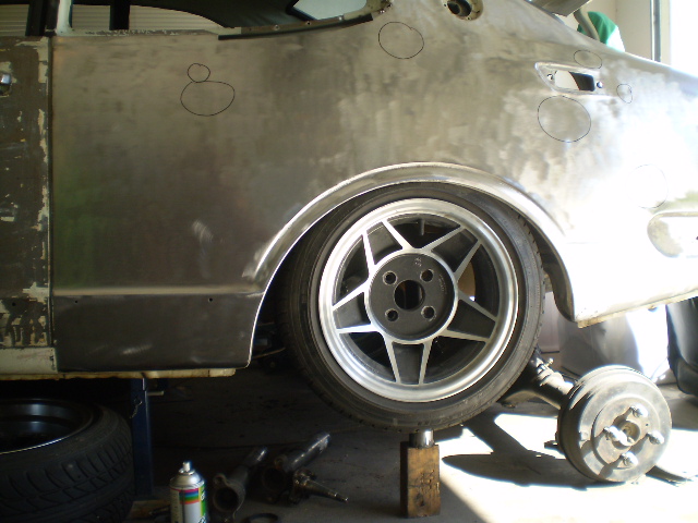

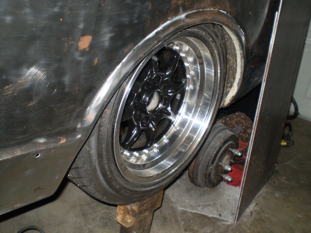

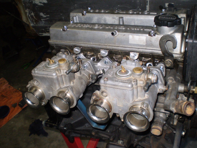

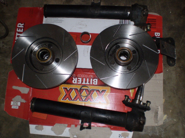

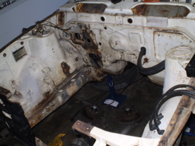

  21. Well after seeing and reading quite a few other KE2x threads i decided i had better pull my finger out and start working on mine again. The car that is not so much my thread.. So in the last two arvos i stripped all the sound deadening out with a heat gun and a chisle, got most of the wiring under the dash out (oh an how minty fresh is the dash pad??), roof lining is out too, i also pulled out the windscreen and rear window assuming i'd find some rust, but nope, its as pretty as the day it was made.. but to top off all my hard work i found $1.35 in shrapnel and 3 tyre valves :P Been slowly getting my front brakes together, 86 shortened struts, TRD yellows, vented+slotted discs, calipers, power steering arms (altho I'm not sure if that will make a difference with the steering box??).. so all I'm waiting on now are a pair of weld on coilover kits, then that'll be sorted.. With the wheels thats where I'm hoping ill be able to tuck the 15's for the time being till i find some 13 inch hayashi streets.. Altho i will be running flares so it will make for a better fitment.. I decided not to run carbs on the 4age as i also have a set of itbs here so I'm just goin to make a mani for that, just not sure which comp ill use to run it.. I'm thinking adaprtonic but thats way down the line.. So now i just got to find a place to media blast it at a reasonable price.. can anyone reccomend a place on the sunny coast?? i tried one dude but he wants around $12-1500 so I'm not going there.. :P After the blasting is done I'm not really sure what colour to paint it, i really like the orange but for some reason that british racing green or what ever it is, is starting to get my attention.. so theres another problem to overcome as well as getting the t series shortened with leaf mounts put on.. And lastly my newest toy is a little 125cc pitty. Goes alright for what it is. The gold one looks better that that now .. 2 for a hundred bucks so i made one good one an ill scrap the rest, and anyway the pro tapers are worth that too.. Anyway I'm (as they say) rooted.. so beddy byes for me.. nite nite Richie..
