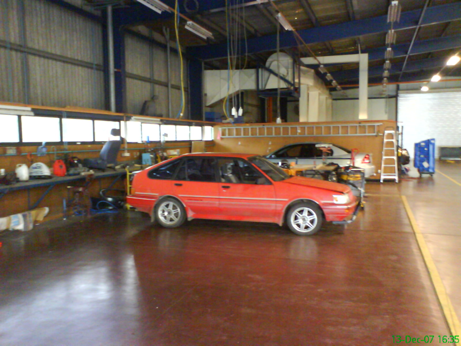

My twinky is now at RACQ thanks to Trev's Father.
I get to work on it all day tomorrow while at work and get paid for it :lolcry:
Big thanks to RACQ for letting me do this.

When you said the corolla I thought you meant the AE71, Thats why i asked why you taking it there.
Edited by Trev
Get with the times trevor, I only have one Corolla.
:lolcry:
